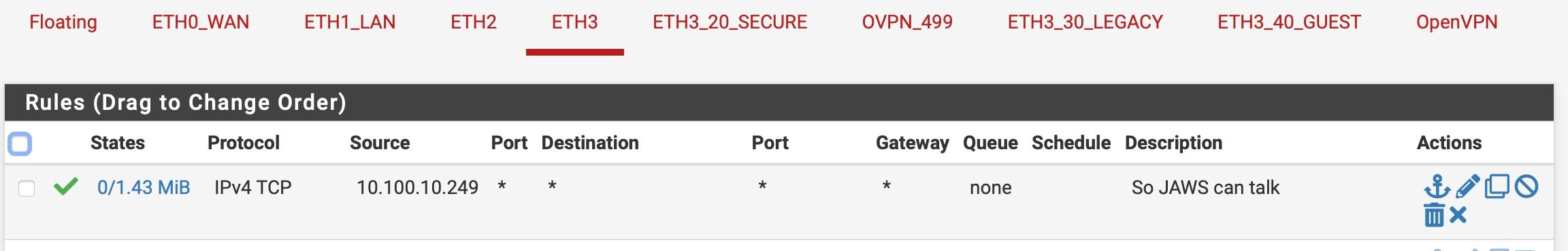

      I know this is a super basic question, but I think it will help my brain if I can read a FW rule as if it were a sentence.
      I'm hoping it will help me understand how rules work and also help me think through how I need to create new one's when the occasion arrises.
      Here's how I evaluate the circled rule:
      My brain says, "If a packet arrives with a destination of sf.example.com:32400 on the WAN interface, first I need to translate that to the dest IP (is that done with my DNS resolver?)." The answer is that the packet needs to end up at 192.168.2.2 so it bypasses all the rules until it gets to the last one which says, "If packet bound for 192.168.2.2 & port 32400 arrives on the WAN interface via IPv4,TCP from ANY address and ANY port allow it to pass.
      Likewise:
      If packet enters ETH3 using IPv4,TCP FROM 10.100.10.249 on ANY port and wants to go ANYWHERE, pass.
      Is that basically correct? I just want to get better about understanding and building rules.
      GertjanG johnpozJ 2 Replies Last reply Reply Quote 0

        @tknospdr said in How to read FW rules in plain English:
        Be aware : only TCP, so for example DNS won't work ... (uses UDP)
        About
        as the 3 rules above this rule, you need to create a NAT rule (not shown).
        When you create a NAT rule, a related WAN firewall rule will also be created.
        RFC1918 or local addresses normally never arrive at the WAN interface.
        The packets that arrive at the WAN interface will have the pfSense WAN IP as a destination.
        From there on, step 1, the firewall rule belong to the NAT rule will apply - so packets can enter.
        Step 2 : the actual NAT rule will apply, and do the address/port 'translate trick.
        T 2 Replies Last reply Reply Quote 0

          tknospdr @Gertjan
          @Gertjan said in How to read FW rules in plain English:
          Yes, I understand that. My question was if my Firewall to English translation for that particular rule was correct.

            johnpoz LAYER 8 Global Moderator @tknospdr
            Yes that is correct.. That is an any any rule, any port any destination. You have limited it to that IP as the source of the traffic into your interface.. If the source was say 10.100.10.250 then that rule wouldn't match/trigger
            Rules are evaluated top down, first rule to trigger wins, no other rules are evaluated.
            In the case of port forwards, those are evaluated before firewall rules.. But even if you port forward something, there has to be a rule that actually allows it.

                • GertjanG Online
                  Gertjan @tknospdr
                  Okay, I'm confused. It sounds like you 2 are saying the opposite. Or is it just your wording.
                  It's imho, the same.
                  A NAT rule, the rule part that consist of the WAN firewall rule - the rules you can see on the WAN interface, are handled first, = my step 1.
                  => So the traffic can enter te WAN interface.
                  Then comes step 2, this is (imho ^^) more a router rule : the IP and port (NAT or PAT actually) translation is happening.

                    • GertjanG Online
                      Gertjan @tknospdr
                      Packet arrives to my WAN interface and says "I'm here to see PUBLIC_IP in apartment 3290.
                      NAT rule says, "Hmm they're actually looking for 192.168.2.2 in apt 32400, but before I send them on their way, let's see if the doorman will allow it"
                      Doorman says "My rulebook says packets from PUBLIC_IP visiting 2.2:3400 are welcome here"
                      Close !
                      This order :
                      Where doorman = the WAN firewall rule (created by the NAT rule).
                      So, first, an incoming packet has to be allowed by this fire wall rule.
                      The packet can now enter the router and the attached NAT rule will kick in : it will replace the source IP of the packet with the destination IP for the local LAN IP, like 192.168.1.22. If needed, the original destination port number can also be changed, but this is optional. In your case it was originally '32400' and it sated '32400'.
                      The NAT rule (and firewall rule) is statefull : the answers from the traffic going to 192.168.1.22 will get remapped in reverse, so a bidirectional data stream can take place.
