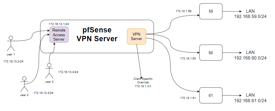

      Tunnel is 172.18.1.59/24 for LAN 59 , 172.18.1.60/24 for LAN 60 etc... straight and square. Topology like below:

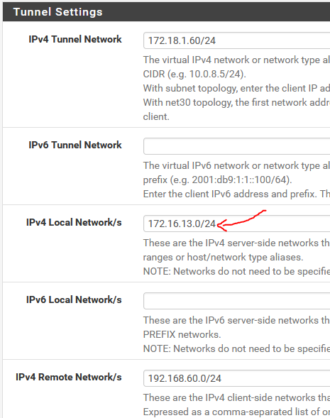

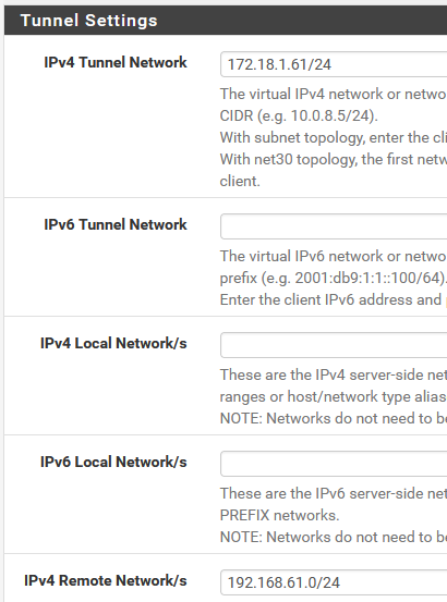

      All clients with Specific overrides only for the tunnel peer IP and for the remote network behind it, like below.
      In parallel, i have another instance of Open VPN remote Access Server, and the users have the tunnel IP range 172.16.13.0/24. So if a user is connected to the VPN Server , it can access also the remote networks of TLS Clients.
      The Issue is that one specific client (LAN60), can't recognize the traffic coming from the remote access tunnel with the range 172.16.13.0/24 (no ping / no access from remote connection), but from the central pfSense it pings, meaning from 172.18.1.1.
      So in order to troubleshoot that, i have updated the client specific override for this specific client like below. With below setting it works !
      all pfsense systems are 2.7.2 version.
      My question is : why from all those clients, only this specific device needs that setting ?? obviously is getting that as routing inside open vpn as existing routed network over this tunnel and then is working, but why the other clients don't need that ?
      i have checked on LAN60 pfsense and there is no conflict with this range. Also note that was working like all the other clients for many months without problem and without the extra setting in CSO.
