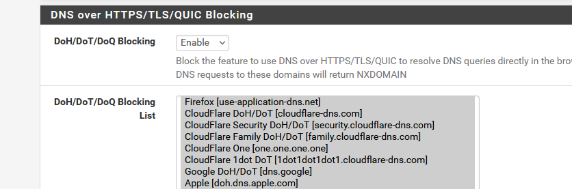

                              @SteveITS said in Filterdns has stopped resolving hostnames in firewall aliases:
                              "DoH/DoT/DoQ Blocking"
                              Maybe this is the issue, because ACME doesn't work if all lists are enabled/blocked.
                              @stephenw10 do you know aliases with FQDN use one of this lists?
                              Edit: Checked this on my 25.07 appliance without pfBlockerNG, there is no issue and aliases working.
                              pfSense Gold subscription
                              S GertjanG 2 Replies Last reply Reply Quote 0

                                        Gertjan @slu
                                        @slu said in Filterdns has stopped resolving hostnames in firewall aliases:
                                        I've checked them all, and activated, for years now :
                                        I also use the ACME pfSense package for a long time now.
                                        No issues what so ever.
                                        the acme.sh shell script uses the available DNS to find the Letsencrypt server (or alternative) for the renewal request. As pfSense resolves by default, it doesn't care and won't use any 'DoH' DNS servers.
                                        If you set up pfSense, the resolver, as a forwarder, and you forward to a 'DoH/DoT/DoQ' listed server, then unlist that DNS server.

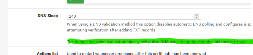

                                          slu @Gertjan
                                          @Gertjan said in Filterdns has stopped resolving hostnames in firewall aliases:
                                          Off topic:
                                          Thanks for the feedback, interesting this works in your setup. For some reason the ACME script try different DNS server and get a timeout because pfBlockerNG reply (for example) for one.one.one.one NXDOMAIN. Maybe its relevant how ACME is configured.
                                          Since we use the DNS servers from our ISP this can't be the issue here.

                                            Gertjan @slu
                                            Nice catch !
                                            This :
                                            implies that when you set DNS Sleep to '0', it's the script itself that starts polling every 'x' seconds the domain name servers.
                                            If its using one of the Doh etc, (which you've blocked with pfBlockerng) then yeah, that fails ...
                                            Set DNS Sleep to "200" or so and solved ^^
