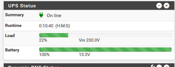

                                    and when checking the UPS :
                                    and the settings page : all was fine.
