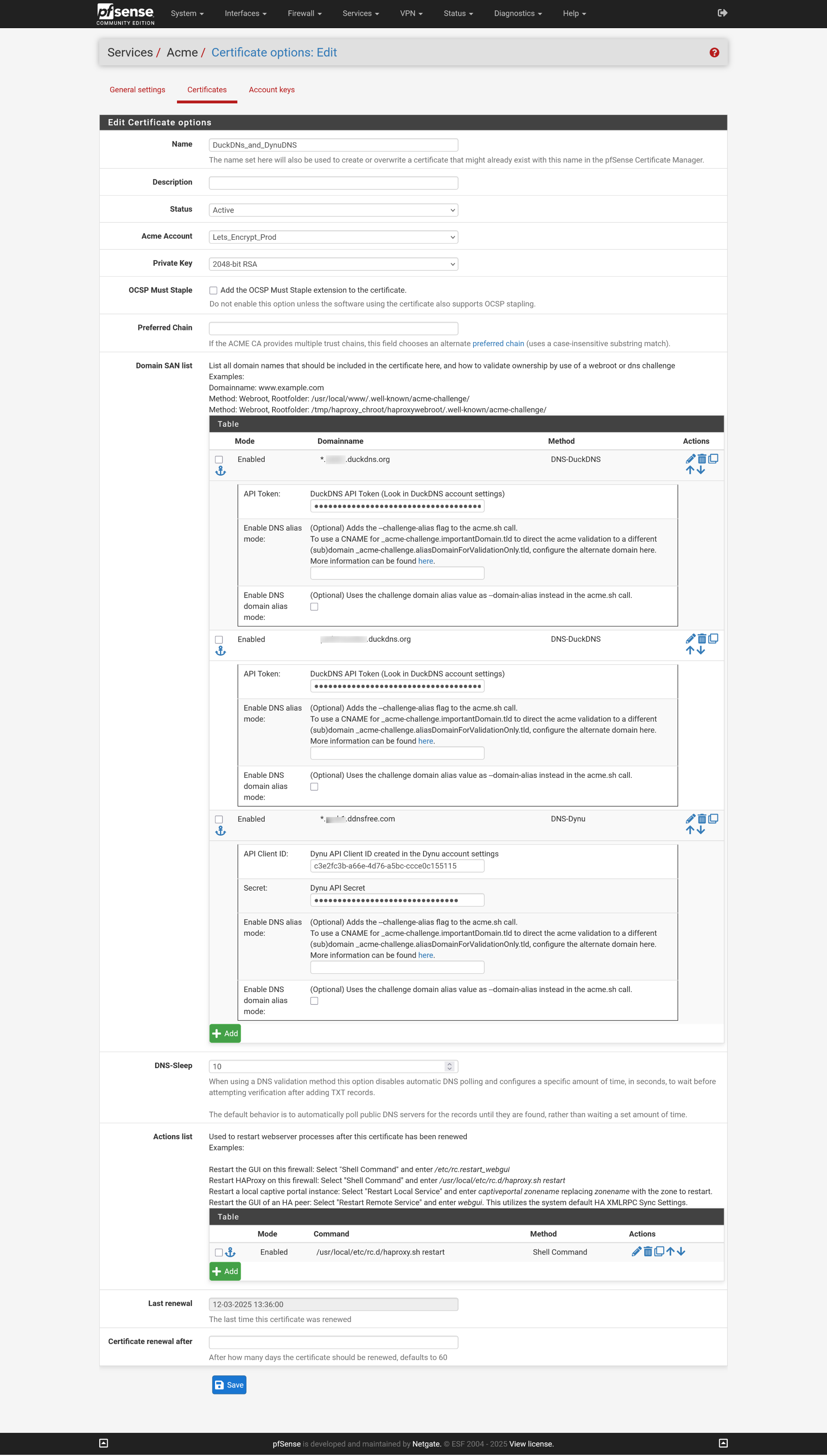

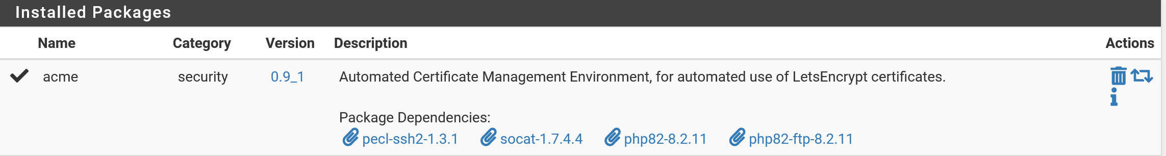

      When I run a renew with the certificate configuration below (see screenshot) using Acme version 0.9_1 on pfsense 2.7.2-RELEASE, I receive the following error:
      ACME, Failed to renew certificate for DuckDNs_and_DynuDNS
      You must export variable: DuckDNS_Token
      I am able to successfully able to execute a renewal by changing the file '/usr/local/pkg/acme/acme.inc', moving the line 3241:
      $envvariables = array();
      to outside of the foreach loop (so to line 3220). Here is what I mean:
                          is_array($certificate['a_domainlist']['item'])) {
                                  foreach($certificate['a_domainlist']['item'] as $domain) {
                                          if ($domain['status'] == 'disable') {
      This causes all method environmental variables to be made available available to the renewal process.In the current code, only the last method environmental variables are included, which in the case of my configuration a re 'Dynu_ClientId' and 'Dynu_Secret' as can be seen from the failure logs. I have included logs of a failure case below.
      It would be great to get this change included in the base code for a future release or have this issue resolved appopriately.
