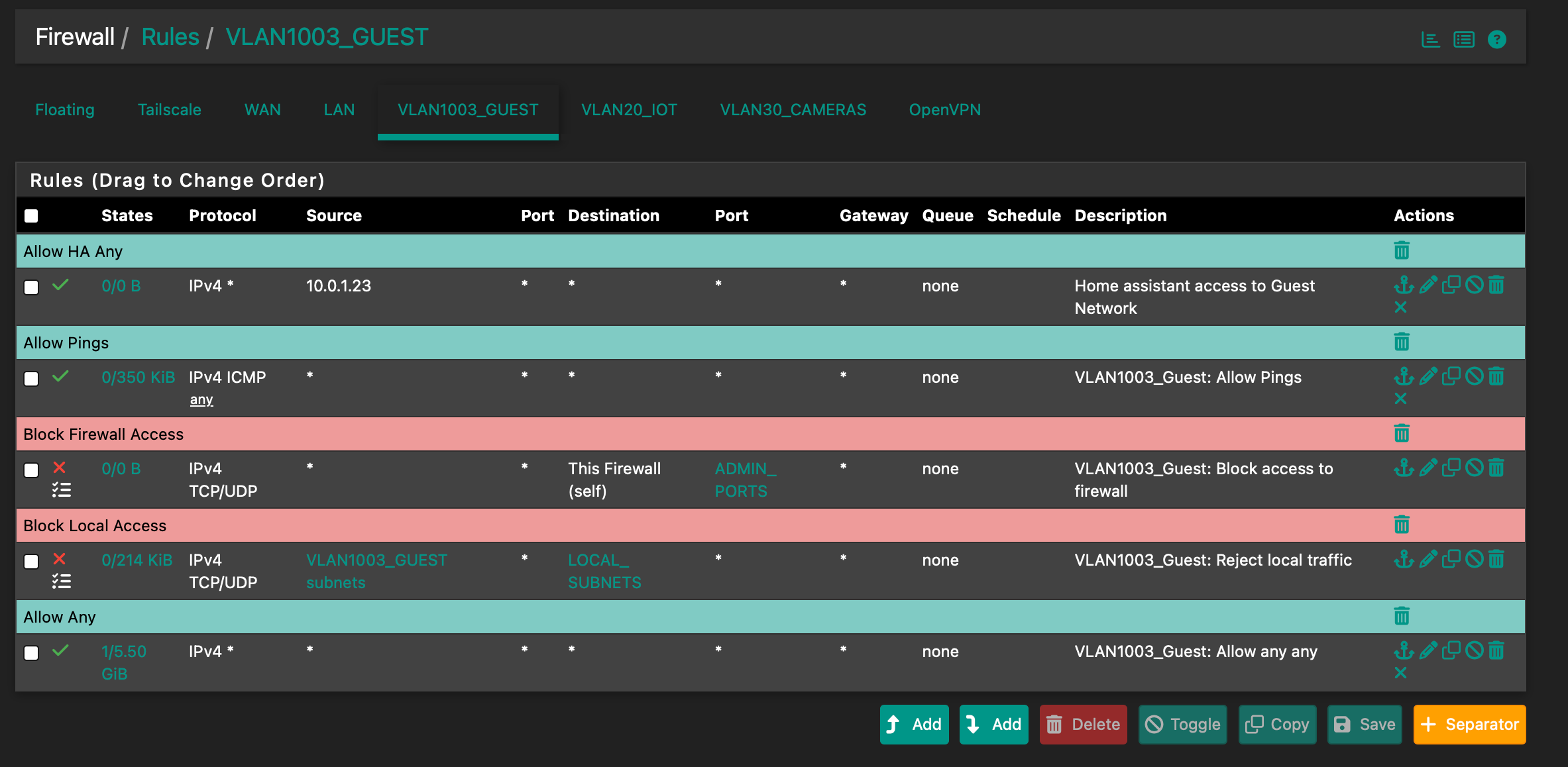

      Current rules for guest-
      I know the Allow Any Any is evaluated last but I don't remember creating it and not sure if it's right. Shouldn't it be a Block Any Any?

        SteveITS Rebel Alliance @wgstarks
        @wgstarks What are you trying to accomplish/allow/block on this network?
        Edit: only LAN has a default allow all rule.

        • wgstarksW Offline
          wgstarks
          I honestly don’t remember creating that rule. I was adding a rule to allow home assistant access to the guest network from its IP on LAN when I noticed the rule in question. I’m really not sure why this rule is needed or if it’s even a good idea?
          Box: SG-4200
          S GertjanG 2 Replies Last reply Reply Quote 0
            @wgstarks well without it 10.1.0.23 can get to anything (that’s this subnet right?) and things can ping, and nothing else would be allowed.

            • wgstarksW Offline
              wgstarks
              I get that but should the guest network have an allow all rule? This opens the guest network to all traffic from WAN right?
              Box: SG-4200
                @wgstarks Rules apply as traffic enters an interface. Source: VLAN, dest any. Even if it doesn’t say it, traffic only arrives on this VLAN.
                Upvote 👍 helpful posts!

                    • wgstarksW Offline
                      wgstarks @Gertjan
                      @Gertjan
                      It appears it was created by me a little over 7 years ago. No surprise I don’t remember. Sometimes I have a hard time remembering last week.😁
                      I tested connections to other networks last night after reading @SteveITS post. You are both correct that any attempts to connect to other networks are all blocked.
                      I’m still not sure that the allow any any rule serves a purpose though? Wondering if it should be deleted? If I’m understanding correctly it will allow machines on LAN to connect to machines on the guest network. Wouldn’t it be better to block by default and set specific allow rules for circumstances where connections are needed?
                          @wgstarks said in Allow Any Any question regarding guest network:
                          That is how pfSense and most firewalls work. That's why I asked, "What are you trying to accomplish/allow/block on this network?"
                          LAN by default allows to any.
                          All other interfaces in pfSense have only the default deny rule and zero additional rules. So you should ask yourself questions like:

                              • wgstarksW Offline
                                wgstarks
                                This is just a network for visitors to my house and a few IoT devices. They only need access to DHCP, DNS, NTP perhaps (all provided by the firewall) and the internet. Home Assistant needs access to some of the IoT devices so I have created a pass rule from the HA device on LAN to the Guest network. None of the devices on Guest should have access to LAN or any other local networks and I don’t really see a reason to allow access from local networks to the guest network other than the specific instance mentioned. Am I missing something?
                                Box: SG-4200
                                  @wgstarks Ok so:
                                  • block what you want to block
                                  • allow any will let devices on this subnet get to the Internet
                                  Did you ever say what 10.1.0.23 is? If that's not an IP on this guest network the rule is pointless since traffic will never arrive on this interface from an IP that isn't behind this interface. Note it shows 0/0 so has never been triggered/matched.
                                  wgstarksW 1 Reply Last reply Reply Quote 0
                                  • wgstarksW Offline
                                    wgstarks @SteveITS
                                    @SteveITS said in [Allow Any Any question regarding guest network]
                                    10.0.1.23 is the LAN address for Home Assistant. Obviously I have not set this rule up correctly. How should I setup a rule to allow this LAN address to connect to the Guest network?
                                    Box: SG-4200
                                      You would need to create it on LAN.
                                      Though if LAN still has its "allow to any" rule then another one for this IP is not actually necessary.
