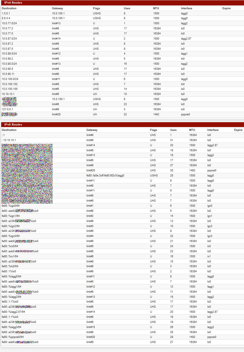

          Probably this is not related to the current patch, ... I think this issue has been present since the early 23.05 versions, but I’ve only recently started to understand what’s going on. Sometimes, but not always, when PPPoE disconnects and reconnects, I receive an IPv6 address on the WAN interface, but nothing is assigned on the LAN interface, which is configured as a track interface. After some time, the IPv6 address on the WAN interface also disappears. I’ll try to collect logs later.

                • w0wW Offline
                  w0w @stephenw10
                  Now I have
                  net.inet6.ip6.rfc6204w3=1
                  Nothing has changed. Manually disconnecting and reconnecting can result in no IPv6 on WAN, or IPv6 being present on both WAN and LAN, and sometimes it initially appears on WAN but disappears from WAN later.
                  I am not sure it pfSense, it can be my ISP. I see nothing helpful in the logs currently.
                  BTW, sometimes the uptime is also missing, and clients have no internet access — they cannot ping external sites by name or IP, also directly can not ping from pfSense. However, I can resolve names using DNS lookup on the pfSense, so Unbound is somehow working. But when I check the routes, it looks like the default route is missing — there is no 0.0.0.0 route at all.
                  This is happening often when playing manual disconnect and connect after.
                    Ok well that seem unrealted to IPv6 or Unbound so it should probably be in a different thread.
                    However I would check the output of pppcfg pppoe0 when that happens. It looks like it's not connecting at all.
                    w0wW 1 Reply Last reply Reply Quote 0

                      @stephenw10 said in DNS resolver exiting when loading pfblocker 25.03.b.20250409.2208:
                      I don't think so. You can see gateway status on the screenshot and pppoe0 is in routes list, but not default.
                      Sure. I think I will do further tests on weekend or when it's possible and post back in another thread.
                        Hmm, but it shows no IP address against the pppoe gateway and the RTT at 0.5ms seems too low to be real.
                        If you're using if_pppoe it will show an uptime if it's really connected.
