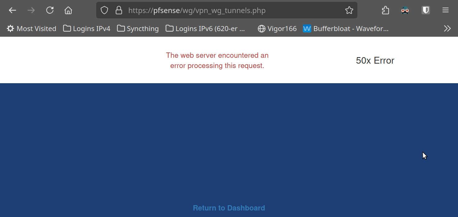

      Today I updated from 24.11 to 25.03-BETA (amd64) built on Mon Apr 14 20:38:00 CEST 2025.
      There are two Wireguard tunnel configured:
      tun_wg0 -> assigned to an interface, tunnel to a VPS
      tun_wg1 -> not assigned, peers are 6 clients who call home
      tun_wg0 looks ok, for tun_wg1 in VPN / WireGuard / Tunnel & Peers all looks fine, for the peers tun_wg1 is shown as tunnel. But under VPN / WireGuard / Status none of the peers are listed.
      Wireguard fails to start and if I try to disable tun_wg1 it throws a 503:
      ... and the PHP crash report:

      Addition: on tun_wg1 I got two interface addresses, an IPv4 and an IPv6 address. After removing the IPv6 address it works again. Adding the IPv6 address again, and the error pops up again also.
      That should be a supported setup, yes?
        marcosm Netgate
        Thanks! Should be fixed now:
        https://redmine.pfsense.org/issues/16160

          @marcosm thanks a lot, will try tomorrow when I’m back home.
          • patient0P Online
            patient0 @marcosm
            @marcosm after applying the patch IPv6 as the second interface address is up and running again.
            Thanks you and have a great weekend.
