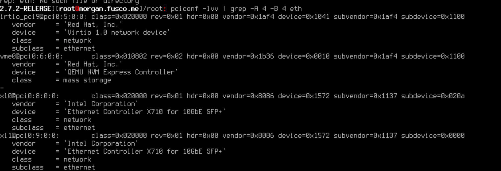

      Hi All,

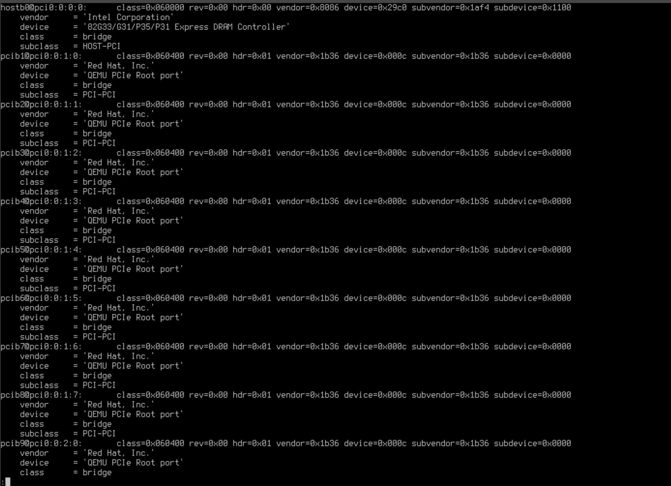

      Tried to upgrade my pfsense vm today. Its virtualized under Incus in TrueNAS and is working as expected in 2.7.2. When trying to upgrade to 2.8, everything seems to work as planned, but when it comes up in 2.8 it hangs here
      Under 2.7 these seem to be QEMU PCIe rootport devices
      Is there a change in the driver for QEMU in FreeBSD 15.0 thats breaking this for me?

                                    Since you're hitting this locally try setting the loader value: debug.acpi.disabled="pci"
                                    It looks like this is an ACPI bug preventing the OS finding the PCI devices. Setting that falls back to probing the bus/tree.
                                    I expect it to still fail but the changes output would be useful in diagnosing the problem.
                                    Edit: Actually that seems to prevent any detection in Q35....
