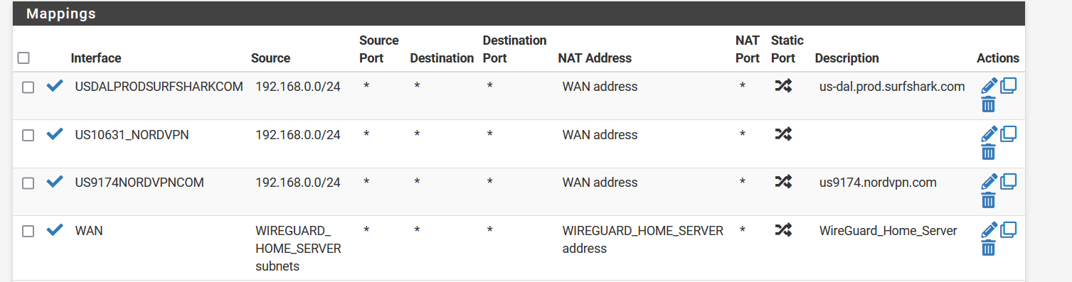

I am thinking maybe a nat outbound rule needs to be created. I have tried. But no luck.
My Outbound NAT rules
@elegantd There is so much wrong on your side, it is really hard to decide where to start... And what does it even mean: "My firewall rule for WG clients" and "My firewall rule for WG server". Usually, if the firewall is connecting towards a Privacy-VPN, this is called a VPN-Client on the firewall. If your phone is connecting to your firewall from the outside, on the firewall it is called a VPN-Server. In a router/firewall everything is named from the point of view of the router/firewall itself.
If you use WireGuard for the connections to the Privacy-VPN, you usually don't need to configure Outbound NAT, so keep it at automatic (or hybrid, if you also use OpenVPN for that) and remove your faulty rules there.
Destination is almost never your WAN-address, it is any (IP-address) if it is the internet.

Thanks Bob I was making it far more complicated than I needed. I have it fixed now. I have the Wireguard Clients connecting to my pfsense server and the ones I want are going out the nordvpn tunnels.
@Bob-Dig Thanks Bob I have it fixed now.
