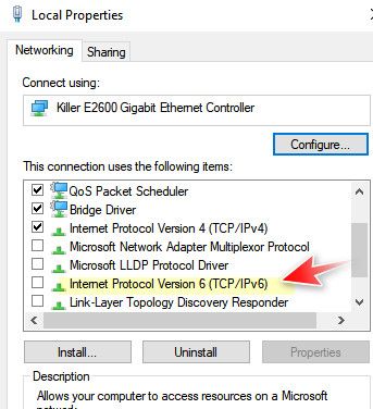

          Yup - if your not going to be using IPv6 - its best to stop it from sending noise if you ask me.
          If you can not disable it on the noise maker itself, prob want to set pfsense not to log the noise. Noise in a log just makes it harder to see stuff that would be of interest in the log.
          In windows - should be as easy as unchecking the ipv6 box on your nic

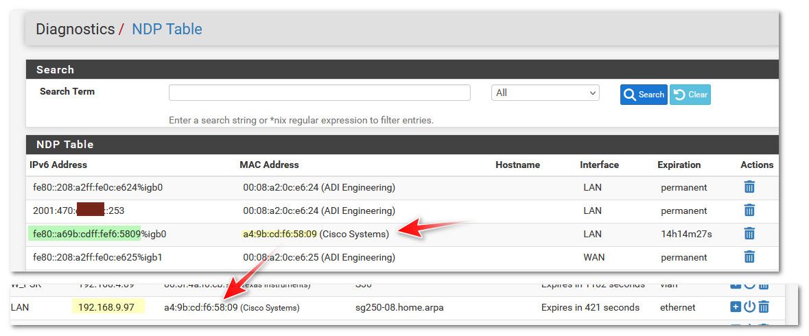

                    @deleted it really shouldn't be hard to track down.
                    You should be able to look in your NDP table and find that link-local address fe80::3eec:efff:fe34:3623
                    This will give you the mac address, you should then be able to look in your ARP table for that mac, and know what IPv4 address the device has.

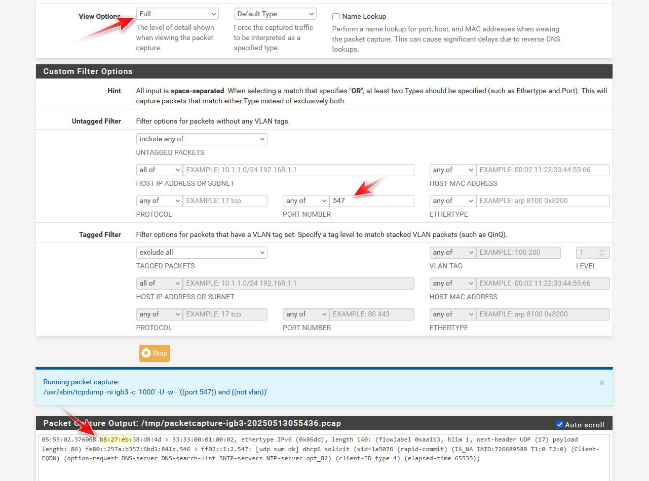

                    Another option would be packet capture (diag menu) and sniff for IPv6 going to [ff02::1:2]:547, this will then give you the mac address of the device sending it.

                                    johnpoz LAYER 8 Global Moderator @deleted
                                    @deleted said in Unknown DHCP ping:
                                    option-request DNS-server DNS-search-list
                                    Huh? I showed you how to find the actual mac address of the device. Not sure what your looking up, you can not lookup a link-local address to find the maker, like you can from a mac address.
                                    See in my example where it says cisco on that a4:9b:cd address..
                                    You can look them up on plenty of websites..
                                    https://maclookup.app/search/result?mac=a4:9b:cd
                                    If your not seeing this link-local address in your NDP table, then sniff, ie do a packet capture.. It will show you the mac address.
                                    That traffic is a dhcpv6.. https://en.wikipedia.org/wiki/DHCPv6
                                    Once you know the mac address, you should be able to get a clue to what device is asking for dhcpv6.
                                    edit: here is a packet capture showing the mac, set your view options to full, set the port to 547
                                    If I lookup the mac of the sender, that b8:27:eb I see that is my raspberry pi
                                    https://maclookup.app/search/result?mac=b8:27:eb
                                    Those dns-server dns-search-list are options the dhcpv6 client is asking for.. See on the last line of sniff above you see the options, mine is also asking for sntp and ntp servers..

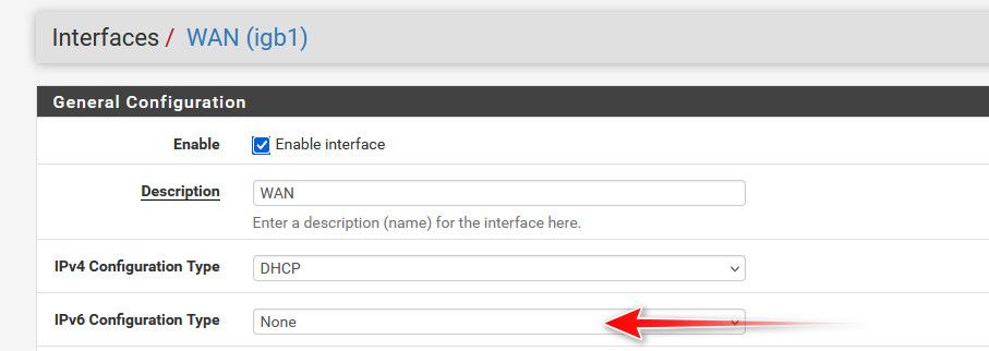

                                        @deleted I wouldn't try that with pfsense, it runs on freebsd - which is sim to linux, but not exactly.. So it might be a bit different.
                                        Where exactly are you seeing that? I assumed it was in your firewall log? So its pfsense asking for IPv6 via dhcp on its wan?? if so just set pfsense wan to not do IPv6 on its wan..
                                        Pfsense shouldn't log that it trying for dhcp - unless you unchecked the ipv6 box..
                                        If you uncheck that box, then yeah it creates block rules for anything IPv6. But just setting none on your wan interface for ipv6 would stop it from asking for IPv6 via dhcpv6

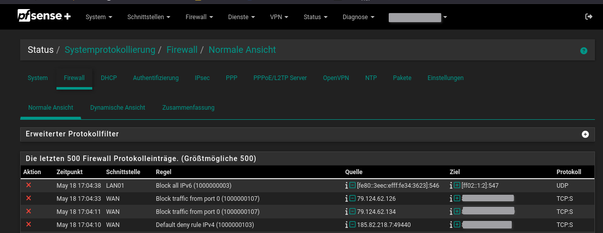

                                          deleted
                                          This is the entry in the log:
                                          I have configured my interface exactly as shown in your picture.
                                          Except that it has a static IPv4.
                                          The Allow IPv6 field is deactivated.
                                          The settings were already set as they were, I didn't update anything.
                                          Or is it in FreeBSD?
                                            @deleted so its not pfsense sending it.. Why would the firewall log outgoing traffic from pfsense?
                                            I have now been able to find out the MAC and as suspected it is the pfsense itself.
                                            The lan side interfaces should not be requesting IPv6 unless you had them set for dhcp for IPv6, the IPv6 setting on your lan side interfaces should be NONE as well.
                                            When you disable IPv6 it does create block rules - that could be blocking outbound? But an outbound block log normally shows direction arrow..
                                            Please show us how you determined the mac address of this traffic and that it pfsense itself. If the interface for IPv6 is set to none - it wouldn't be sending dhcpv6 requests.
                                            I do not disable IPv6 because I do use it for testing.. By default IPv6 is allowed - ie that check box is checked.. So I am not exactly sure the rules it creates when you uncheck it.. But it would seem odd that it would block outbound traffic and not log that it is outbound traffic like the above picture, where my outbound rule blocks rfc1918 going out my wan.
                                            But if an interface is set to none for IPv6 - it sure wouldn't be sending dhcpv6 requests.. I doubt its pfsense mac address sending that to be honest.. Unless you have the lan01 interface set to dhcpv6.. And even if you did I would think the block all ipv6 if set for outbound blocking it would log the direction, which from what you posted that is an inbound block.. So into the lan01 interface, not traffic leaving the interface into the lan01 network.

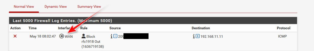

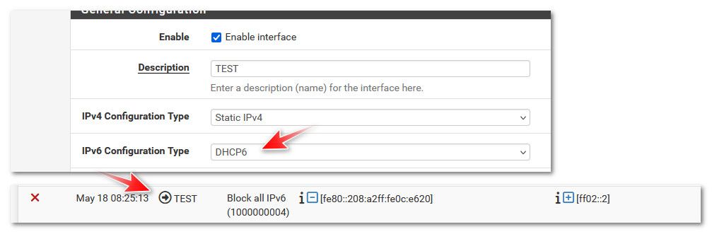

                                            edit: so I disabled IPv6 by unchecking the box, and it does create an outbound rule
                                            You can view the full ruleset
                                            https://docs.netgate.com/pfsense/en/latest/firewall/pf-ruleset.html
                                            Not all rules are shown in the gui, there are some hidden rules to see you have to use the above linked instructions.
                                            # Block all IPv6
                                            block in  quick inet6 all ridentifier 1000000003 label "Block all IPv6"
                                            block out  quick inet6 all ridentifier 1000000004 label "Block all IPv6"
                                            But as you see if the pfsense interface was sending it - it would show that it was in the outbound direction.
                                            I enabled dhcp for ipv6 on my test interface - and you can see pfsense with default logging on, logs that in the outbound direction, since your log does not show this - then the traffic was inbound into your lan01 interface - and not from pfsense itself
                                            And you can also tell that was inbound because of the rule ID, 1000000003 vs the 4 one which is the outbound rule.
