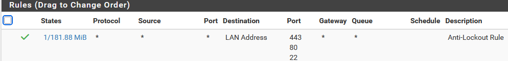

                                      @katakuri FWIW the only interface/rules tab with anything on it by default is LAN. The anti-lockout rule there looks like:
                                      There's a checkbox on System>Advanced>Admin Access to remove that.
                                      (there are also two default rules there to allow IPv4 and v6 to any)
