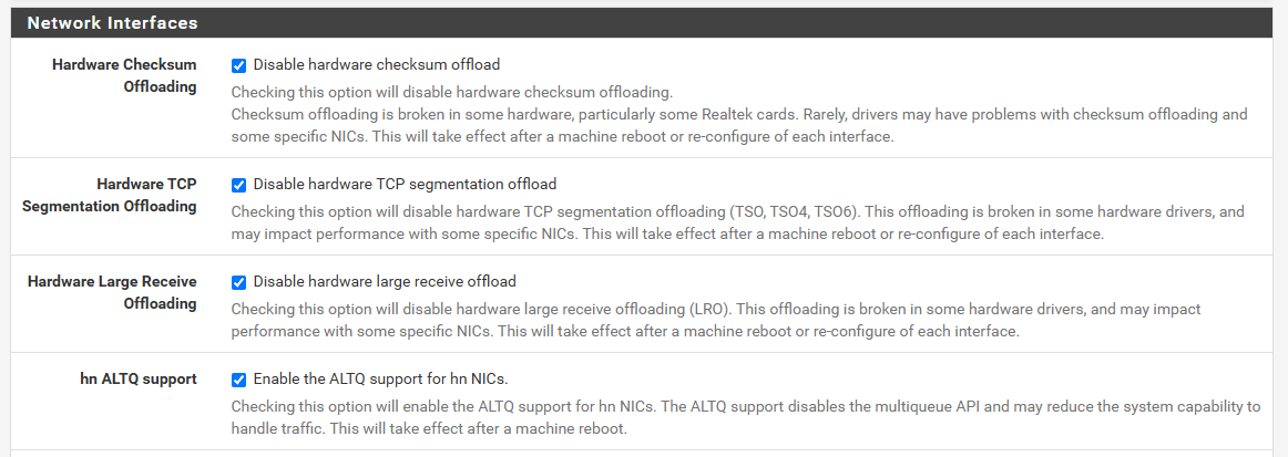

                                Hey guys.
                                While I am waiting on my ISP, I have been doing some research with respects to getting the most out of my X550-T2 NIC.
                                Regarding the options found in System>Advanced>Networking as highlighted in the below image, should any of these be unchecked?
                                I also did some other research regarding system tuneable and noted someone with an X550-T2 using the below to enhance performance:
                                net.inet.tcp.tso="0"
                                hw.ix.flow_control="0"
                                hw.ix.num_queues=40
                                hw.ix.enable_aim=1
                                hw.ix.max_interrupt_rate=30000
                                kern.ipc.nmbclusters="1000000"
                                kern.ipc.nmbjumbop="524288"
                                machdep.hyperthreading_intr_allowed=1
                                I am going to give these a test once I have some feedback, however I have bolded the ones I am unsure of as I believe these are CPU/Hardware specific and wondered if I could get some guidance.

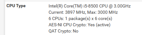

                                My CPU is shown below.
                                Could anyone help with some suggested values based on this?
                                Additionally as per the guide HERE I have added the following.
                                Happy for other recommendations or any thing I should avoid doing as noted above. While some testing would need to be done, just looking for some "best practice" optimizations concerning my setup.
                                Many thanks,
                                w0wW 1 Reply Last reply Reply Quote 0
                                  When you definitely don't need hn altq support. Those are only found in hyper-V VMs. But it does nothing having it set when you don't have the NICs.
