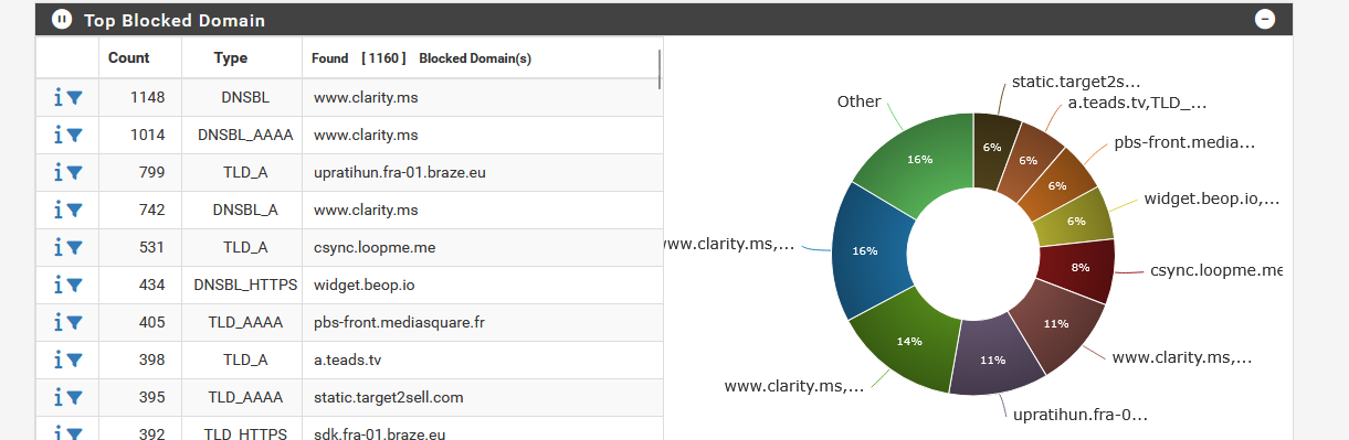

          parse constantly the firewall logs and DNSBL logs, so nice stats can be created from them :
          It is possible that you've created a setup where it seems that pfBlockerng blocks your internet connection.

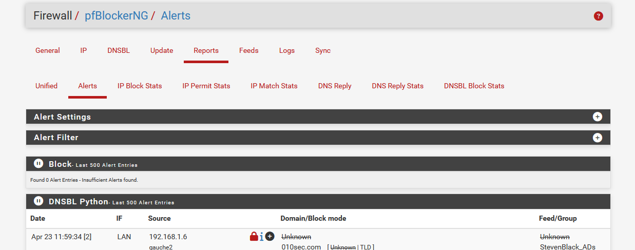

          DNSBL : same thing : there will be host names like "microsoft.com" that get listed in a DNSBL you use. Suddenly, you can't update your PCs anymore. After checking the pfBlocker's master alerts page :
          you'll see what happens, and you need to whitelist this "microsoft.com" - or just don't use the DNSBL feed anymore that listed "microsoft.com".
