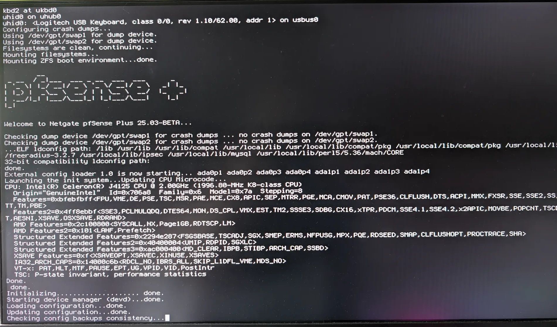

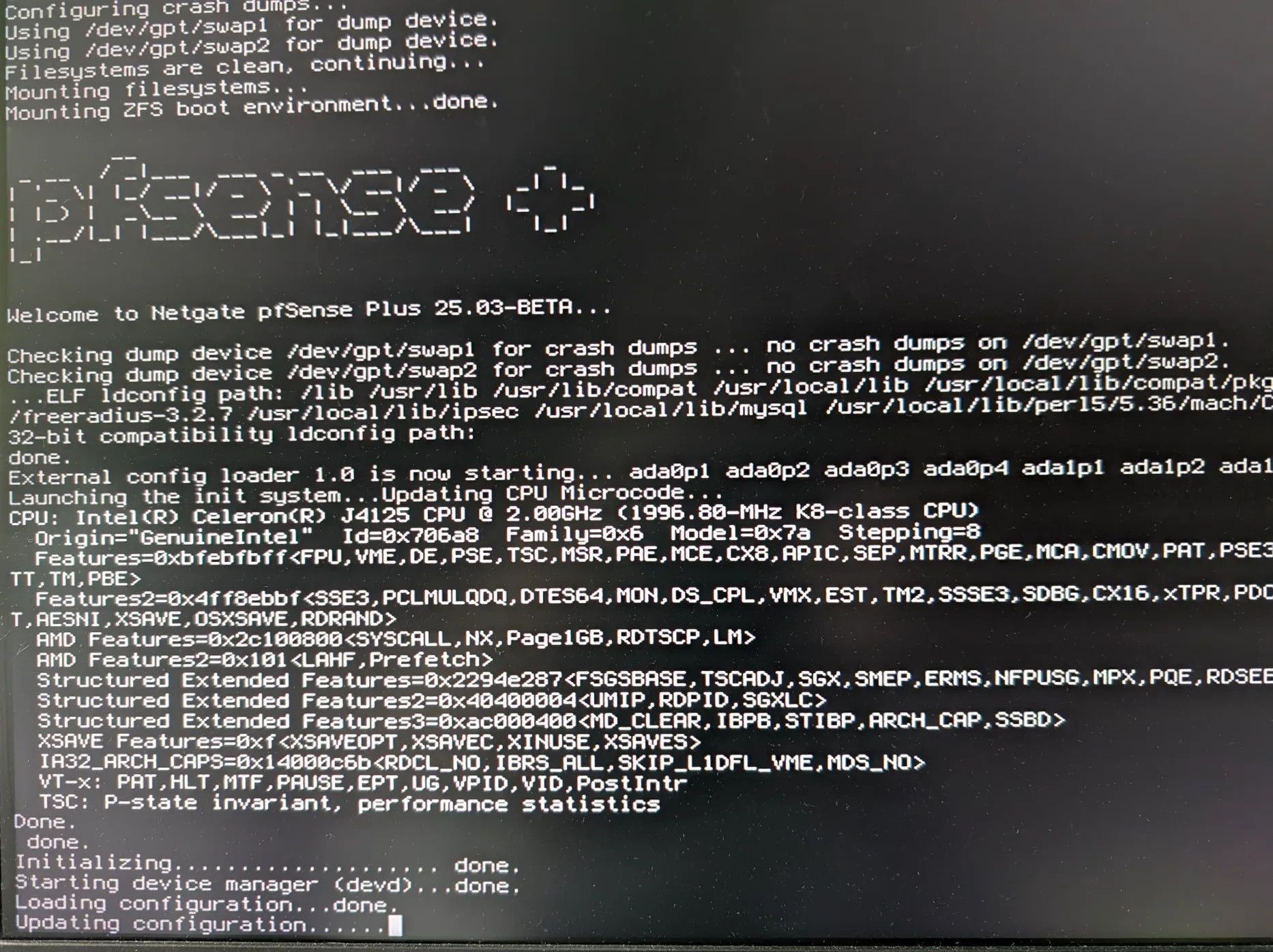

      I'm tryin to update my cheap generic chinese fw box with a J4125 CPU from 24.11 but I can't get it to boot.
      It always hangs at “Updating configuration” or when I try to boot the snapshot manually again at “Checking config backups consistency”.
      This was also the case with the previous snapshot 25.03.b.20250414.1838.
      Is there anything I could try to resolve this besides a complete reinstall?
      What I also noticed is that when I want to display the config history of the updated snapshot in the webgui, the request just runs into a timeout, i.e. as if the update runs through first and then something breaks with the snapshot at the first boot.
      Thanks
