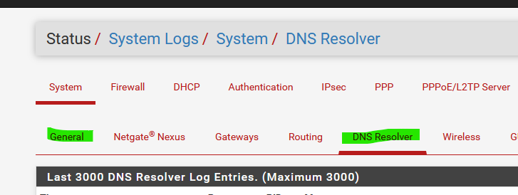

                Gertjan @bigsy
                @bigsy said in Problems after enabling if_pppoe:
                I then realised that there was no DNS resolution at the CLI,
                Check the resolver log ( and system log ) if you can find a reason why the resolver didn't start.
                /var/log/resolver.log and /var/log/system.log.
                B 1 Reply Last reply Reply Quote 1
