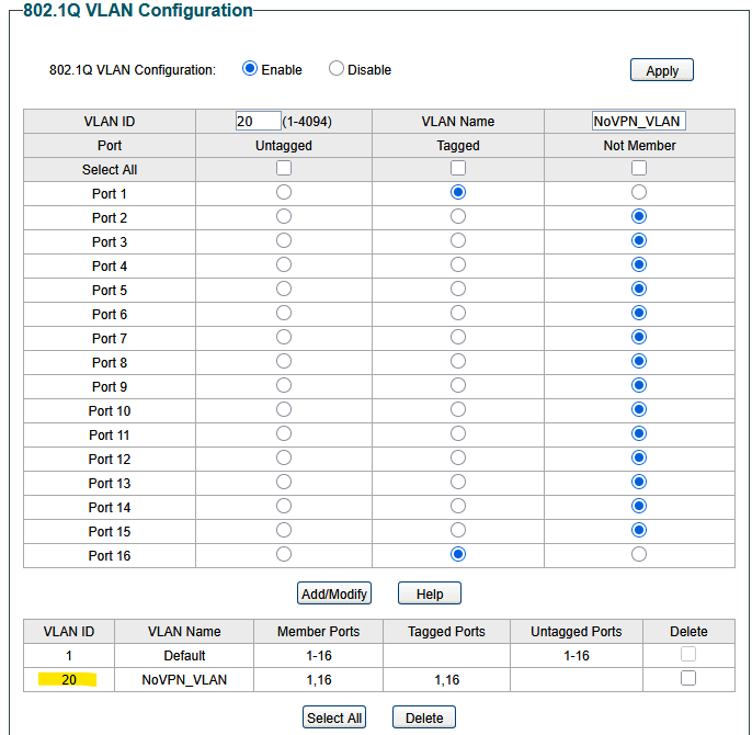

Configuration on the Switch:

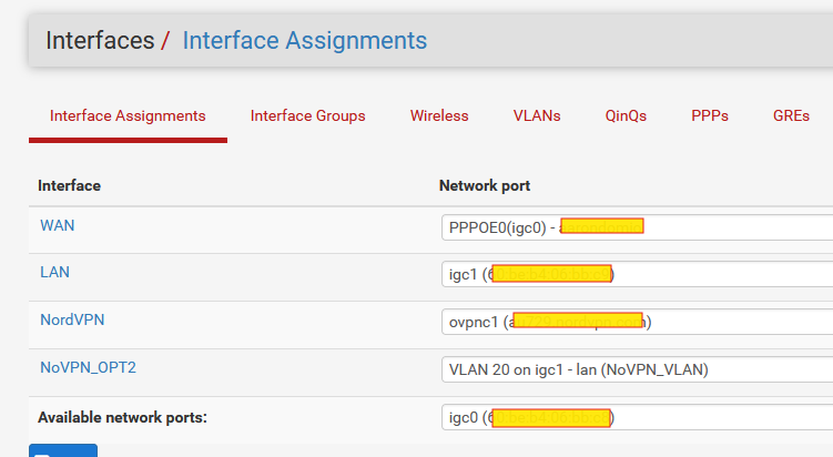

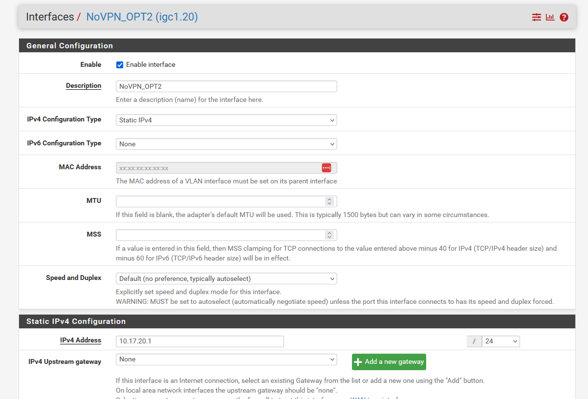

Network Interface:

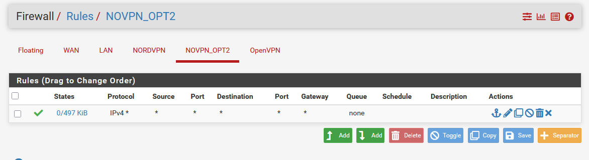

Firewall Rule:

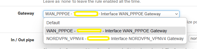

@Dom293 How have you set the gateway for that VLAN 20? I expected you to set the gateway in the NOVPN_OPT2 firewall rule.

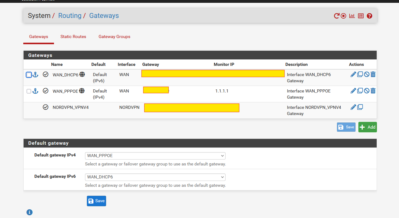

Have you set NordVPN as the default gateway in System / Routing / Gateways?
@patient0 I just had the VLAN20 firewall rule set as 'Default' gateway. But I just switched it to the WAN_PPPOE and re-tested and still no internet on my phone.
And the standard WAN IPV4 is the Default Gateway:
I don't have that configured on the WAN as my ISP doesn't support it
Regarding IPv6: you have configured something on your WAN for IPv6 if you get WAN_DHCP6 gateway.
If your ISP doesn't support IPv6 then just set IPv6 in PPPoE to none.Can you ping pfSense or access the pfSense webGUI from a VLAN20 device?
@patient0 Thx, I just disabled the IPV6 Gateway, all is good there.
