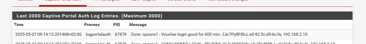

        But I've activated vouchers, created a new roll with 10 vouchers, and tried one :
        From what I make from the error :
        must not contain any null bytes
        or, the text string parsed is the voucher code entered 'manually' by the captive portal user on the login page.
        The function voucher_auth($voucher) is called with the voucher code, like
        voucher_auth("Lbr7Py8F8hJ"); where "Lbr7Py8F8hJ" was entered by the user.

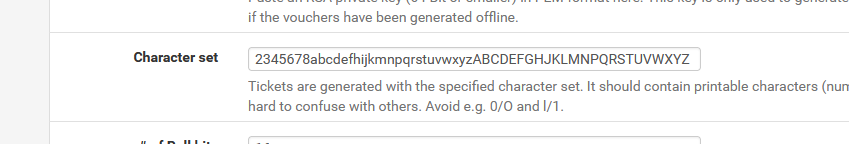

        Vouchers are generated with info you've supplied upfront, like :
        so if a voucher code contain 'text' anything other that what's outside of the character set, like a null byte, it should be disregarded.
        It look likes that test is actually done : look here : line 251. The /var/etc/voucher_cpzone1.cfg file contains this info, but that's moments to late, at line 242 just above the escapeshellarg() function already took the bullet - the PHP function escapeshellarg() fails.

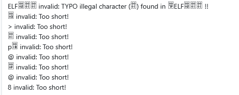

        That said, I 'tested' a voucher code by entering pure BS into the voucher test filed to see if it was valid.
        Just for fun, I copy pasted the binary code of the executable /usr/local/bin/voucher" and that will contain loads of null characters.
        No PHP errors, all I saw was a big list GUI warnings like :
        Note that the erroneous binary chars are copied verbatim to the html GUI output - that's not good neither.
