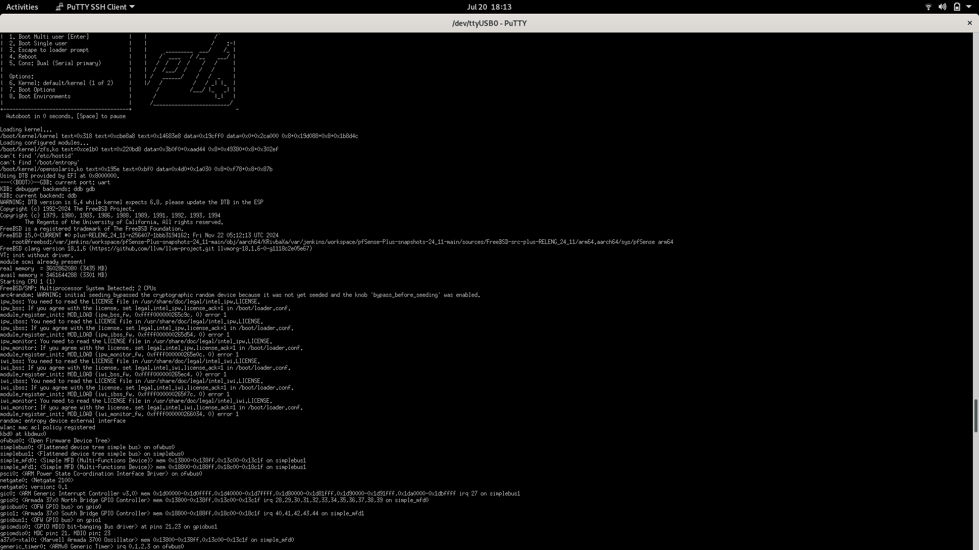

                  After many attempts on the SG-2100 MAX I found this in the logs:
                  WARNING: DTB version is 6.4 while kernel expects 6.8, please update the DTB in the ESP

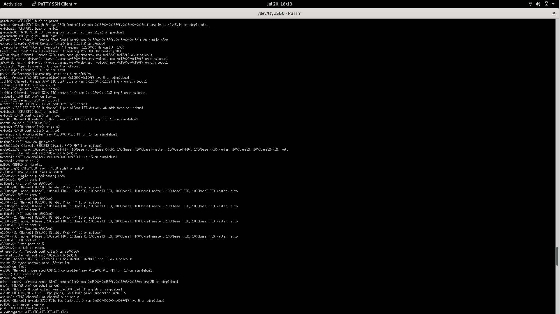

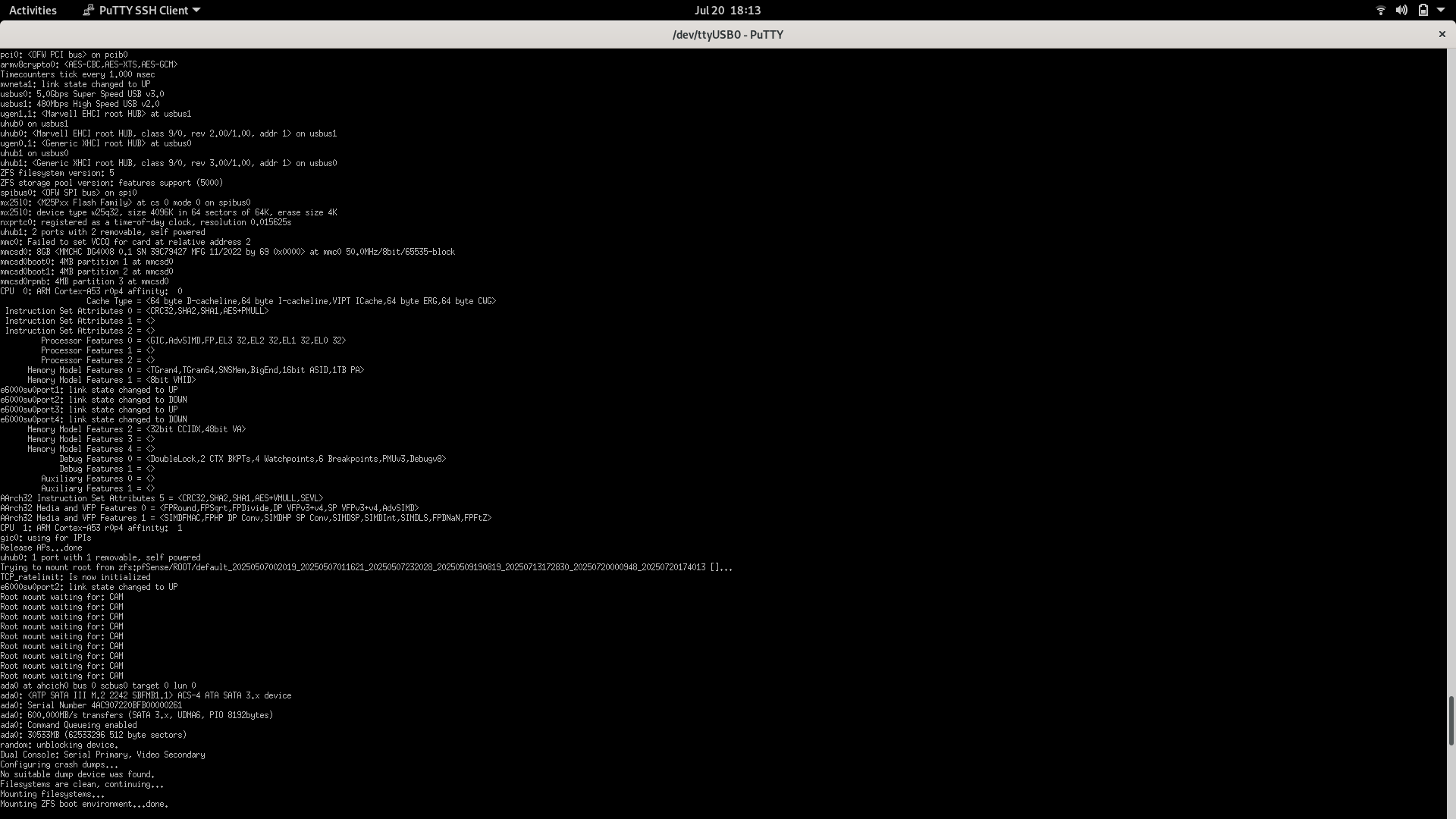

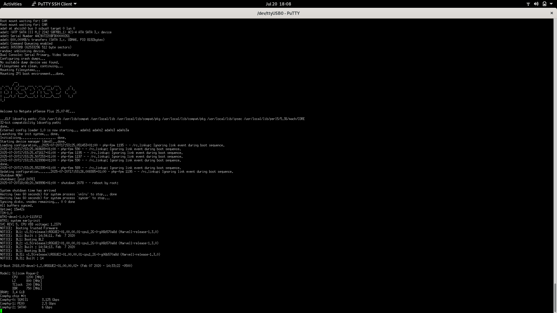

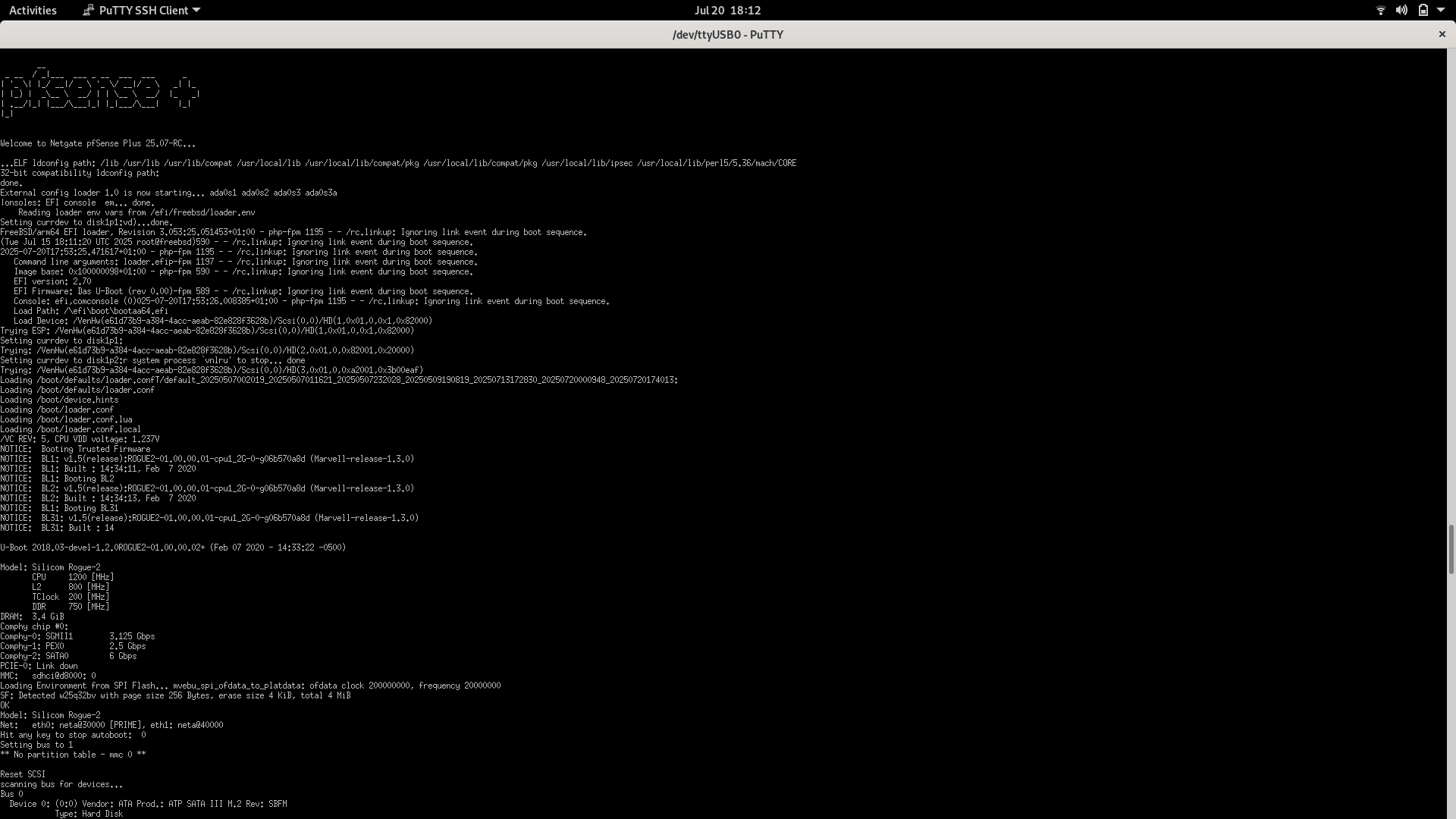

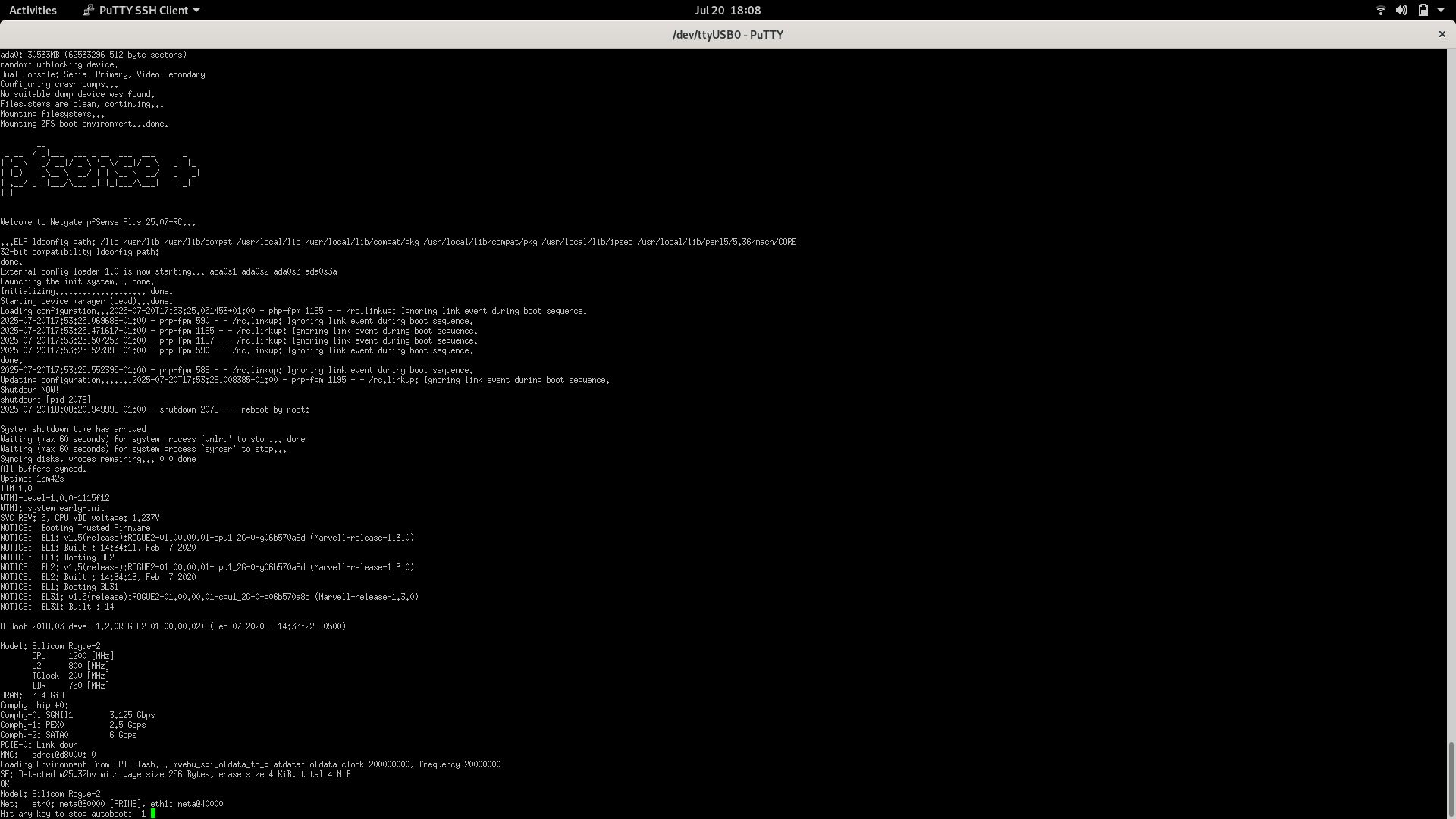

                      Got to the console to check the upgrade at least once before going to the install option for which I got the image ready as well.
                      As seen in the first pictures it hangs a few minutes in Updating configuration......2025-07-20T17:53:26 but then immediately says Shutdown NOW!
                      I can't even tell where it fails and goes back to version 24.
                      Should I just move on and install on top?
                      Or do you want me to check anything of interest?
                      Thanks again.
                      Screenshot from 2025-07-20 18-08-39.png Screenshot from 2025-07-20 18-08-40.png Screenshot from 2025-07-20 18-12-14.png Screenshot from 2025-07-20 18-12-58.png Screenshot from 2025-07-20 18-13-15.png Screenshot from 2025-07-20 18-13-26.png Screenshot from 2025-07-20 18-13-38.png
                      • stephenw10S Online
                        Hmm well that looks like it successfully upgrades but then fails the boot environmen check at the first boot after that. Hence it reverts to the old 24.11 BE.
                        It should show an alert in 24.11 confirming that it reverted to a previous BE.
                        If you check the list of BEs you should see some created for the upgrades that are marked as failed.
                        It's odd it doesn't show that in the console output though. It could be simply timing out at the first boot if something there is taking a very long time? How large is the config? Or does it have anything unusual that is ripping up the config update script perhaps?
