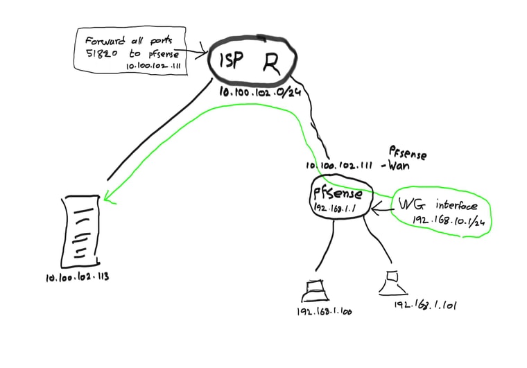

      My home LAN behind the ISP router is 10.100.102.0/24 .
      I have pfSense behind my ISP router in a LAN subnet 10.100.102.111 ( pfSense WAN )
      My pfSense LAN is 192.168.1.1
      My WG tunnel interface is 192.168.10.1
      I setup WG successfully and i can connect my WG interface tunnel from outside no problem. of course i port forwarding from ISP Router to the pfSense wan. I can reach all LAN's behind the pfSense from outside with no problem but i want also to reach my home LAN 10.100.102.0/24 .
      When im connected via WG i cannot reach my LAN subnet 10.100.102.0/24 - this LAN is behind the ISP router and NOT under the pfSense LAN's . I need to reach that subnet. What can i do ?
      I cannot ping or reach my ISP router via 10.100.102.1 and no other device in that subnet .
      please look at the uploaded image and follow the green arrow .
      thanks.

                Is the WAN subnet even routed over the VPN?
                • J
                  johnytb @viragomann
                  @viragomann
                  i can reach the firewall LAN's from outside if that what you asking...
                  but cannot "go back" to the WAN subnets ( my home LAN 10.100.102.0/24)
