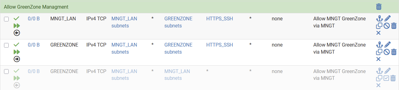

          Here an example of one of the thing which confuses me
          Three rules which should allow management of the green zone
          • the first rule related to the management interface = > allow access to the greenzone
          • the second rule related to the greenzone intrface => allow traffic from managment to enter
          • the third rule => allow to replay to the managment lan
          However .....
          • It seems to work without the third rule !!?? (see documentation sentence The firewall does not automatically add reply-to on floating rules in the inbound direction)
          • I do not like the third rule since there is no port filtering possible since I do not know which ports will be used / where used

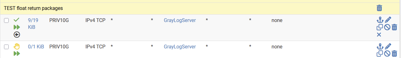

            Here another test
            Two rules here
            • allow access to my graylog vm
            • block access to my graylog vm
            The intention of the test is to verify if the in rule can work without an explicit return rule. If the first rule is not taking care of the return path, graylog would not be accessible due to the second rule.
            However graylog is accessible which proves that the firewall does take care of the return path.
            I just wanted to be 100% sure that this works.
            And also like to emphases that the documentation in at least IMHO is not clear
            • V Offline
              viragomann @louis2
              @louis2 said in Not sure about Floating & Interface Group rule behavoir:
              This is pretty normal filter rule behavior, as it's doumented in pfSense book.
              The first match wins. If a pass rule matches pfSense adds a state for this connection to its state table and response packets to this are allowed by this automatically.
