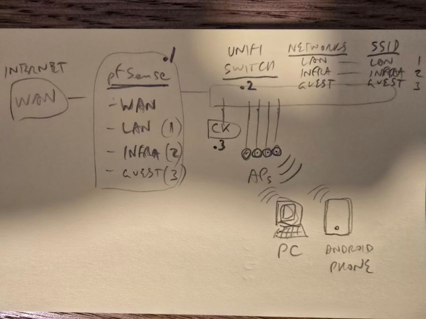

              @johnpoz thanks for trying but the reason I am posting the question is I also don't understand why going static IP would cause the issue I am seeing. Here is a napkin :)
              Its the .2 and .3 that went static and caused the WiFi androids to lose internet access...

                @dj_jc_jase the management IP of a switch would have zero to do with anything.. And your cloudkey doesn't even need to be on..
                But what could happen is an adoption thing since your clouldkey manages your switch. Are your PCs on the same ssid/vlan as your android?
                When your cloudkey changes its IP or the switch does - guess its possible that they get re provisioned??
                I have a unifi switch, I could try changing its IP and see if provisions or has to re-adopt it?
                Are you changing them both at the same time? Are you moving them to a different vlan? Are they currently in your lan that is untagged, and your trying to move them to infra that is tagged vlan?
                And that drawing is perfect by the way to help understand! Thank you!!
                edit: Here I changed the IP of my flex mini.. It was on .6, I made sure nothing was on .7.. I then changed it and you could see it provisioned it to change the IP, I could then ping it on .7
                The ping at the bottom was me pinging a device that is connected to flex mini on a different vlan - I started the ping from my pc that is on different vlan and multiple switches away from my flex mini before I changed the IP.. And then waited until after it had been changed - didn't even loose a single ping while the switch was provisioned with its new IP.
                But I bet when you changed the IP of your cloud key things have to be readopted and provisioned. I would change your switch IP first. Then after that working change your CK IP..
                Another thing that could be going on, but not sure is when that switch gets updated, I wonder if poe cycles and your APs reboot? I wouldn't think so? But maybe.. Changing the IP of the switch first would allow you to see if your APs go offline, etc. Maybe get a ping going to one of their IPs from pfsense or some other device on your network that is wired..
