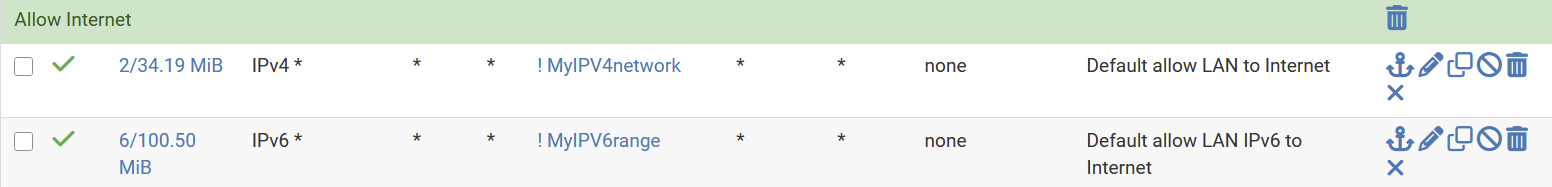

      I have an awful lot of multicast related alarms in the log. Especially alarms telling me that address '224.0.0.22' is blocked. I want to get rid of them!
      The block alarm below
      Seems to be related to the following pass rules (also without logging).
      So a pass rule should not raise a block alarm
      A rule without logging should not generate logging
