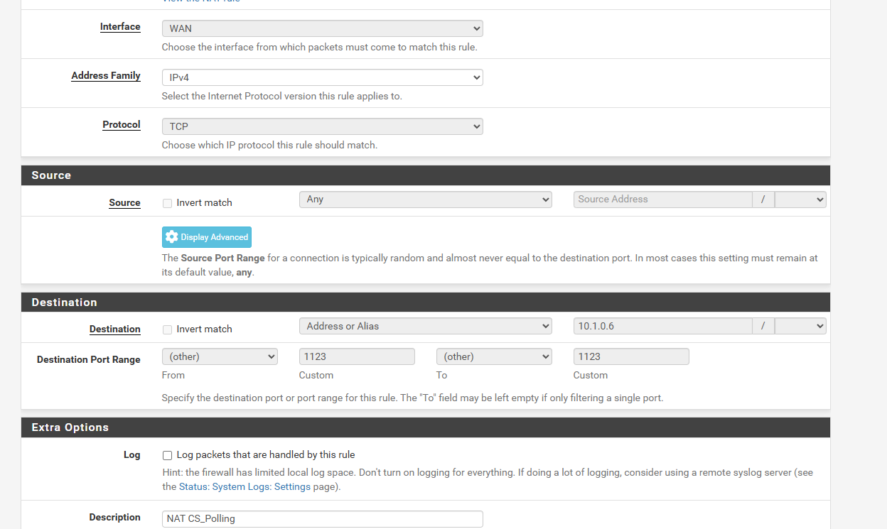

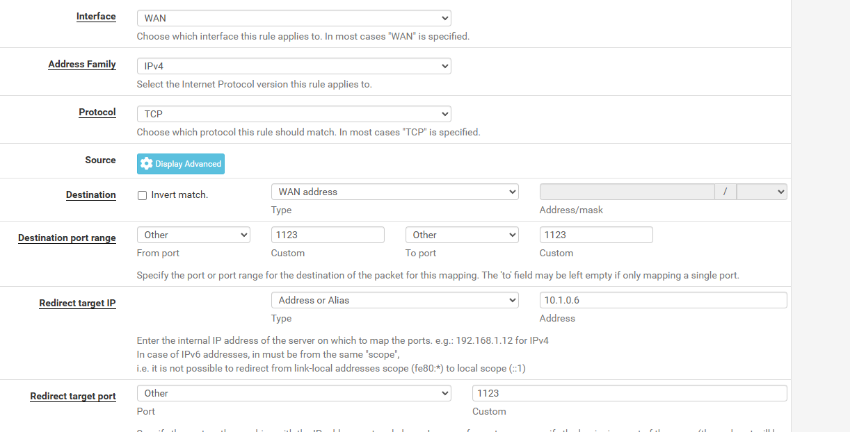

        • G Offline
          Gianni71 @Gertjan
          • GertjanG Online
            Gertjan @Gianni71
            @Gianni71
            Destination is "WAN address" ... why ?
            Is this rule part of a NAT refection ?
            NAT rules are for traffic coming from the outside, mostly known as 'the Internet' so it can reach a device on your LAN, in your case 10.1.0.6 - port 1123, TCP.
            What er you trying to do ?
            Btw : why do you need NAT reflection ?
            For example, if a device on your LAN needs to connect to another device on LAN, it doesn't need to connect to the pfSense WAN so it gets 'redirected back' into pfSense so it goes to a LAN device .... That's ... let's call it pretty broken.
            Why not using the LAN IP directly ? Or create a resolver host name override where it points to the destination LAN IP, and now you can use a host name.
            • G Offline
              Gianni71 @Gertjan
              Here is the port rules on WAN.
              my client needs to connect from their dinamic ip to my public static ip address port 1123 and forward to 10.1.0.6 and works fine.
              but in my app i can detect the source ip but it's always 10.1.0.4 (pfsense) not the client public ip address.
              Thanks.
