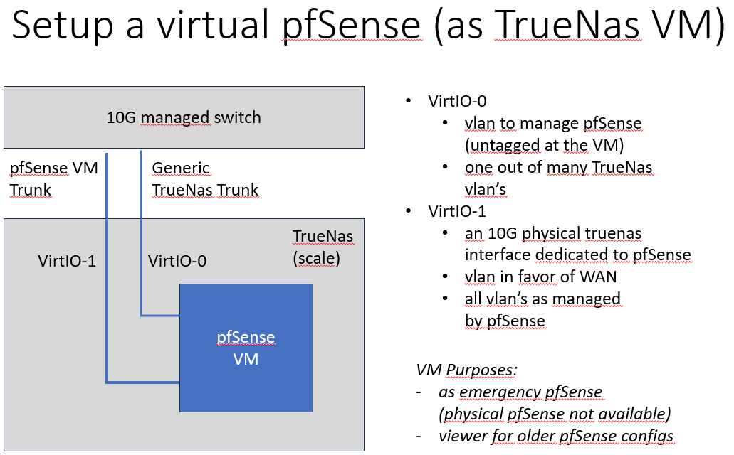

After doing so I could start a (TrueNAS based) VM only having two virtIO interfaces. One as management interface and one as trunk for all other pfSense vlan's
At the same time I felt the need to have an backup for my physical pfSense system. And when having the VM I felt it could serve both purposes.
In the picture my actual setup.
At this moment I have this setup running as ^pfSense-config viewer^, but not yet as real pfSense system.

- if my idea to assign a complete physical TrueNas NIC as virtIO-1 works / if that interfaces is going to transport the set of vlan's the pfSense VM is trying to forward to the 10G switch above (I did not do any test in that regard yet)

Thanks! My system is completely different but given your result I will probably have a reasonable performance.
As you can see in my post I am using two virtio channels:
- Actually effectively I am only using virtio-0 the one vlan channel needed to access and if needed to change the virtual pfSense
- The Intention of the second channel (VirtyIO-1) is to have quasi direct ^physical^ access to a the second (unused) 10G port of the NIC (mellanox connect X4-Lx).
In TrueNas I did select ^enp4s0f1np1^ as VirtIO-port in opposite to a vlan related bridge I used for virtio-0
Will that work in your opinion?
@louis2 I do passthru of disks to TrueNAS and I pass thru the NIC's (LAN and WAN) to pfsense, simply because I want the application to be in total control of what they each do best. But I also have a second TrueNAS at our summer home where disks are virtualized and I have been running firewalls with virtualized NIC's, no problem... In fact I do have my failover WAN assigned using VirtIO, and no issues whatsoever...
