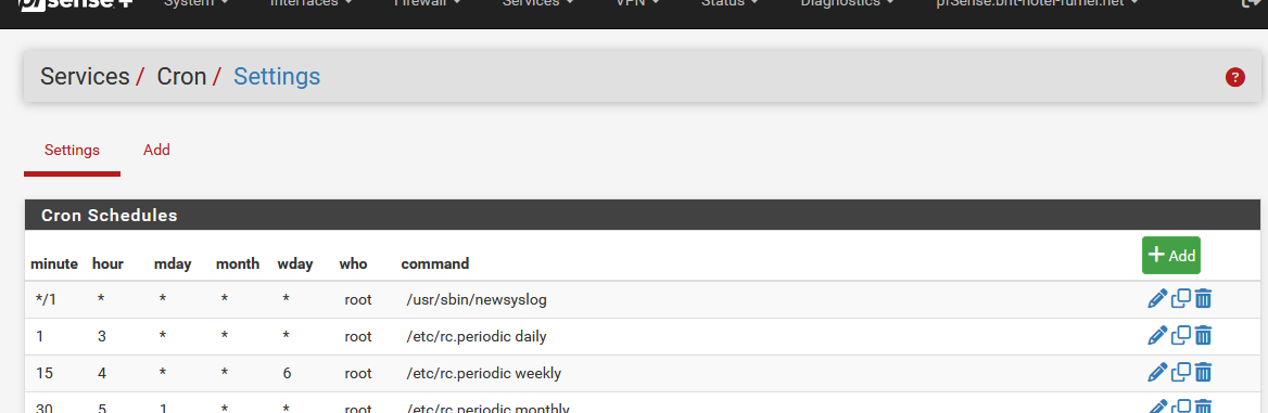

        When you install the cron package, you'll have this :
        can you 'edit' an existing cron entry, change nothing and then save it ?
        This will update the pfSense configuration file "/cf/conf/config.xml", create a backup etc.

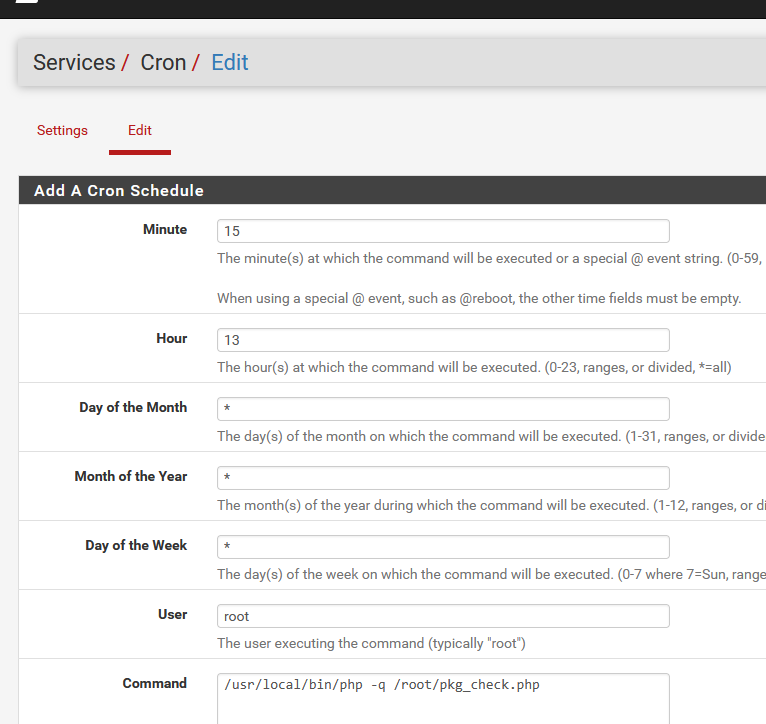

        If you can save an existing entry, but not create your own, can you show us what you were trying to do ?
        Like example : a cron I made myself :
