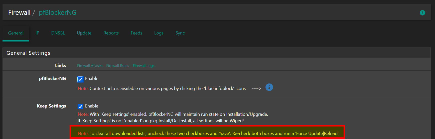

                  • BBcan177B Offline
                    BBcan177 Moderator @Draco
                    @Draco try to goto the General Tab, first ensure that the Keep Settings option is checked. Then unchecked Enable pfBlockerNG so that its disabled. Hit save. Force Update. Then reenable pfBlockerNG and Force update.

                      Draco @BBcan177
                      @BBcan177 I turned off pFBlocker and hit RUN on Update. Nothing happened except my firewall complaining about the loss of the aliases used in rules. Re-enabled and did another Force Update. Still failing the db sanity check:
                      Database Sanity check [  FAILED  ] ** These two counts should match! **
                      Masterfile Count    [ 33142 ]
                      Deny folder Count   [ 34562 ]
                      What else should I try or do you need from me to diagnose? THanks!

                          Like BBCan177 said: unchecked pBlocker, hit save. Force update (so click on Update and click the RUN button on the screen).
                          BBcan177B tinfoilmattT 2 Replies Last reply Reply Quote 0
                          • BBcan177B Offline
                            @Draco did you also uncheck "Keep Settings" that would wipe out all downloaded files and start fresh. If not need please repeat those steps and post the whole log output from this Reload.
