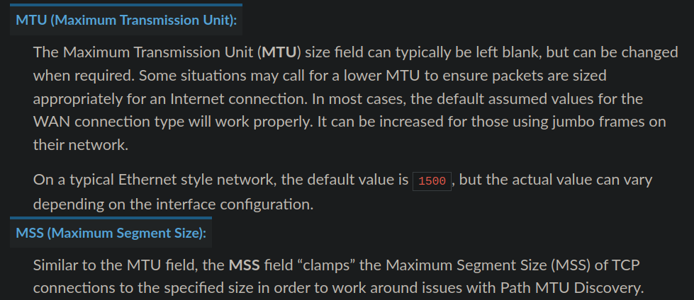

        @tiiash I think you just want to set the MTU and MSS directly on the Wireguard interface:
        https://docs.netgate.com/pfsense/en/latest/interfaces/configure.html

          I configured the MTU on the Wireguard interface as described in the docs. However, it turns out that in order for getting the Zyxel switch to work I had to also specify a value for the MSS.
          For future readers: I set the MSS value to exactly the same as the MTU (1420). The field description states that the actual MSS is calculated by subtracting 40 from this value. Which results in 1380, the same value that can be found in the referenced OPNsense documentation.
