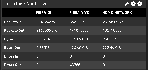

      Hi everyone,
      I'm testing the new pfSense feature that allows using the kernel-based PPPoE driver (if_pppoe) instead of the traditional mpd5, by enabling the following option:
      System > Advanced > Networking
      In my setup, enabling this option successfully establishes the PPPoE connection, but I immediately start seeing a large number of "Errors Out" on the WAN interface connected to Vivo Fibra (PPPoE ISP).
      Additional details:
      Affected interface: WAN - VIVO_FIBRA
      NIC: Ethernet Controller I226-V
      ONU/Modem: MitraStar GPT-2742GX4X5
      Hardware checksum, TCP segmentation offload, and large receive offload are all disabled (all boxes checked under System > Advanced > Networking)
      MTU is set to 1492
      As soon as I revert back to the traditional mpd5 PPPoE client, the errors stop entirely.
      Question:
      Has anyone else experienced this issue with the new if_pppoe module?
      Could this be a bug or a driver compatibility issue?
      I'm happy to provide logs or run further tests if needed.
      Thanks in advance!

                    stephenw10S 1 Reply Last reply Reply Quote 1

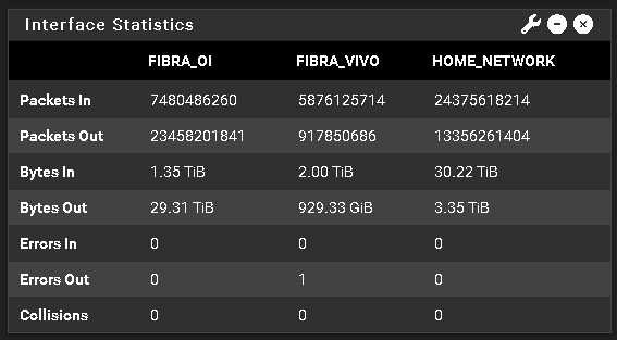

                      dorabiatto
                      [EN_US]
                      Just wanted to share my experience that might help others dealing with the same issue described in this thread.
                      I was getting a lot of “Errors Out” on the WAN interface when using pfSense with PPPoE on Vivo Fibra, specifically with the Mitrastar ONU provided by the ISP. I tried changing MTU, tuning system settings, updating pfSense — nothing helped. The errors kept increasing, affecting connection stability and performance.
                      I decided to replace the Mitrastar ONU with a VSOL V2802RH ONU set to bridge mode — and that completely stopped the errors. Since the switch, pfSense shows at most 1 single error out right after boot, and then nothing more.
                      Summary:
                      Before (Mitrastar): constant Errors Out, especially under load.
                      After (VSOL): only 1 error after boot, then stable with no further errors.
                      So it seems the issue is likely related to some kind of compatibility quirk between the Mitrastar ONU and the new if_pppoe module. Switching to a different ONU (VSOL) significantly reduces or eliminates the issue.
                      [PT-BR]
                      Fica aqui meu relato que pode ajudar outros usuários enfrentando o mesmo problema descrito neste tópico.
                      Estava tendo altos “Errors Out” na interface WAN ao usar pfSense com PPPoE da Vivo Fibra, especialmente com a ONU Mitrastar fornecida pela operadora. Nada resolvia: MTU ajustado, tunable, atualizações — e os erros persistiam, afetando a estabilidade e performance.
                      Resolvi trocar a ONU por uma VSOL XPON configurada em modo bridge — e os erros pararam completamente. Desde a troca, o pfSense mostra no máximo 1 erro Out isolado após boot, e depois disso a conexão segue estável, sem erros acumulando.
                      Resumo:
                      Antes (Mitrastar): errors out constantes, especialmente com alto tráfego.
                      Depois (VSOL): apenas 1 erro após boot, e mais nada.
                      Ou seja, o problema parece estar relacionado à compatibilidade (ou comportamento estranho) da Mitrastar com o módulo PPPoE novo (if_pppoe), e a troca de ONU resolve ou mitiga o problema drasticamente.
