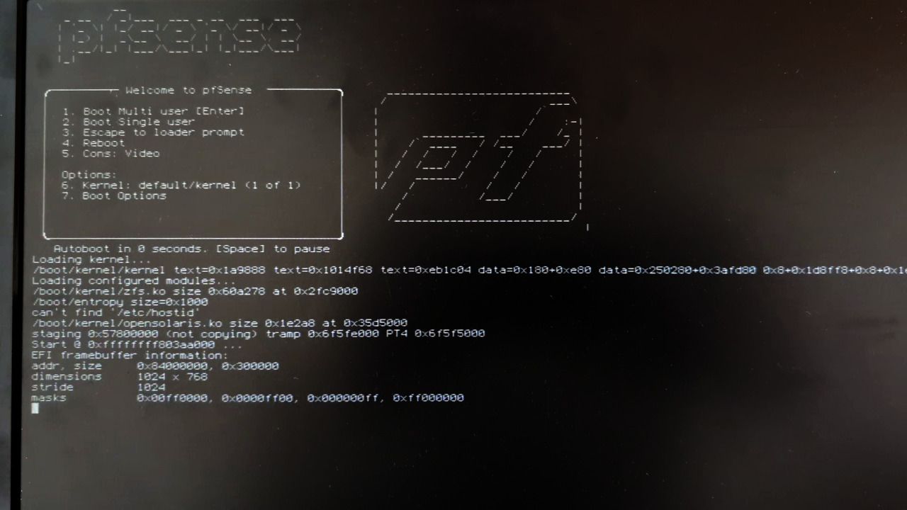

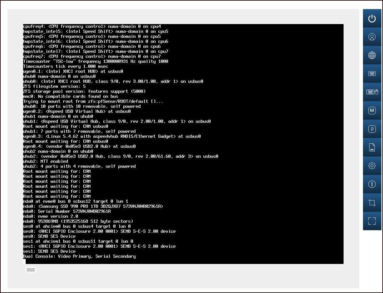

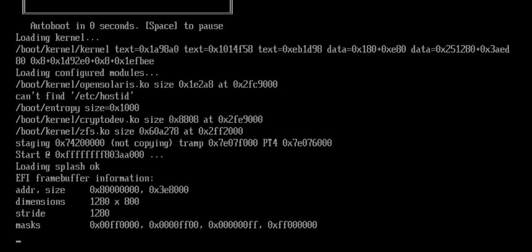

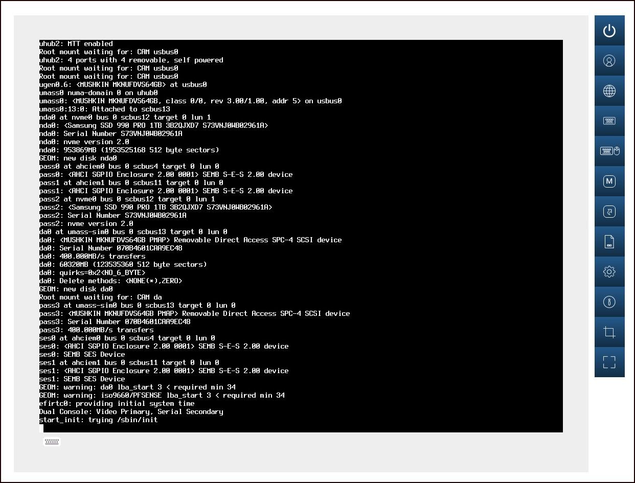

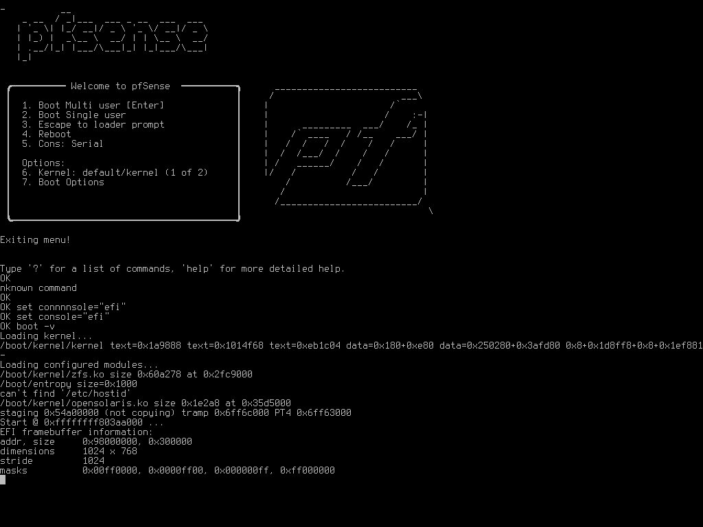

      I've been using pfSense for about ten years and have never had an upgrade issue until today. My pfSense CE 2.8.0 upgrade stalls after reboot and gets stuck when loading.
      • Hardware: SuperMicro X12SDV-4C-SPT4F with latest firmware, Intel Xeon Processor D-1718T
      • Using the 10GB (ix1) copper connections for both WAN and LAN
      • Upgrading from 2.7.2-RELEASE with full system patches installed
      • Removed all packages except for System_Patches
      • Backed up configuration (as always)
      • pfSense-CE-2.7.2-RELEASE-amd64.iso on hand just in case (thank god)
      The upgrade via the web interface looked normal, no issues detected. After the reboot, pfSense CE 2.8.0 loads and starts to initialize the hardware, but then gets stuck at some point and won't continue. Resetting the system brings it back to the same place. See the screenshot of the console.
      I had to revert back to 2.7.2 to get back up and running.

                It's not clear that the upgrade actually stalled. Something about the fact that your board apparently has "Dual Console" enabled may be it at-play.
                @stephenw10 assisted in a similar post from the past 24-hours which I cannot find to be able to link to at the moment.
                EDIT: The similar post.
                I 1 Reply Last reply Reply Quote 2
                • I Offline
                  InstanceExtension @tinfoilmatt
                  @tinfoilmatt This system has always used the Video console and as you can see in my screenshot that is set as the primary console. Plus, the web interface never comes up, so yes it is stuck at that point in the boot process.
                    Mmm it looks mostly like what you might see when not looking at the primary console. But, as you say, it's set to video as primary and it would normally show interfaces linking etc after that point. So it may actually be hanging there.
                    Hoe does that compare with the 2.7.2 boot? Most likely issue is some driver regression or some new driver that supports something in that box that was previously ignored.
                    Is it entirely unresponsive at that point? To ctl+t for example?
                    • I Offline
                      InstanceExtension @stephenw10
                      @stephenw10 Thanks for the reply. The system is completely non-responsive at that point. Hard reset (via IPMI console or Reset switch) is the only thing that gets it back.
                      I don't see any of this behavior in 2.7.2, the boot process is just quick and clean.
                        Hmm can you enable a serial console and check that?
                        I would definitely compare the boot log with 2.7.2 if you can though. I'd bet there is some new or changed driver at play here.

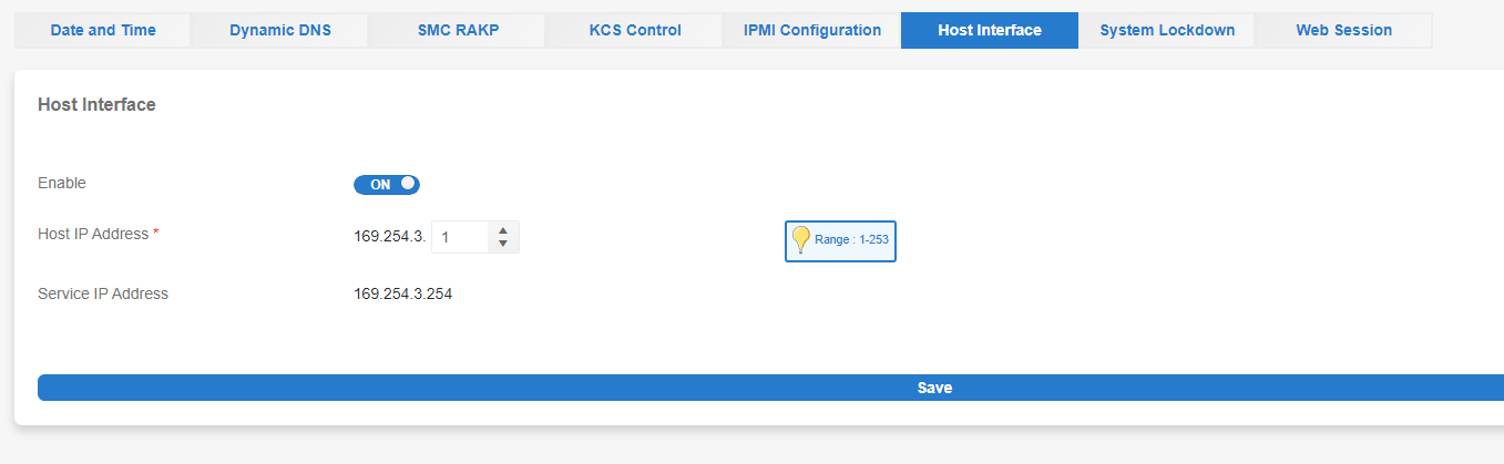

                              First thing I will try is to turn off the "IPMI Host Interface" and let that fall back to KCS for communication between host and BMC.

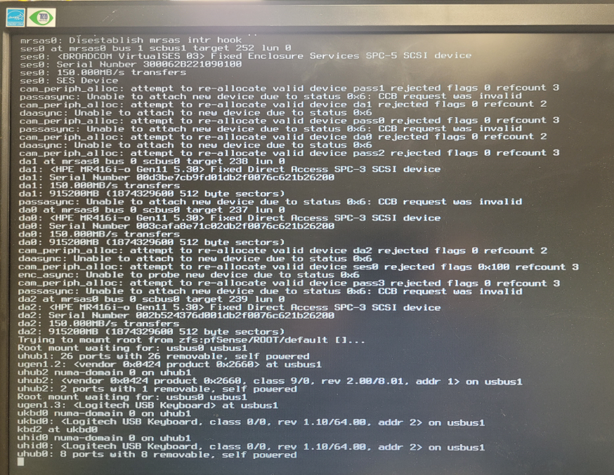

                                • F Offline
                                  Fifty21

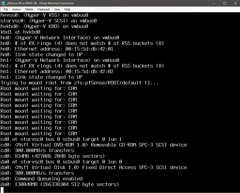

                                  I had a long pause at the same boot point as you (5-10 minutes) on both of my servers but they successfully completed the upgrade afterwards.
                                  Both servers are bare metal Dell PowerEdge R220s.
                                    Mmm, if it does eventually show the console menu that's a sign that it just isn't using the current console as primary. The menu is shown on all consoles.

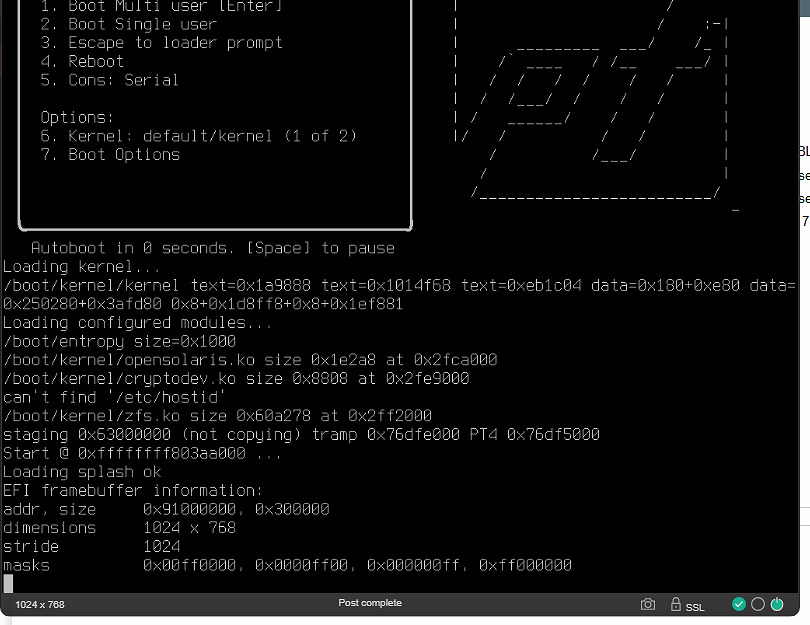

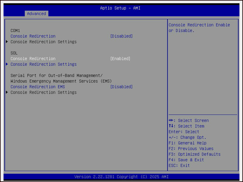

                                      I spent a couple of hours on this today. No resolution yet.
                                      Tried:
                                      • Disabled BMC "Host Interface"
                                      • Verbose logging
                                      • Safe Mode
                                      • Disabled Serial ports and console in BIOS
                                      • Letting it sit trying to load for an hour
                                      • Manually set Console to Video and Serial at pfSense boot screen
                                      • Reset BIOS to optimized defaults. I did have a slight change in there to support Intel Speed Shift. Setting that to back to default did not help. Was set to : Hardware P-States: Native Mode (to support Speed Shift)

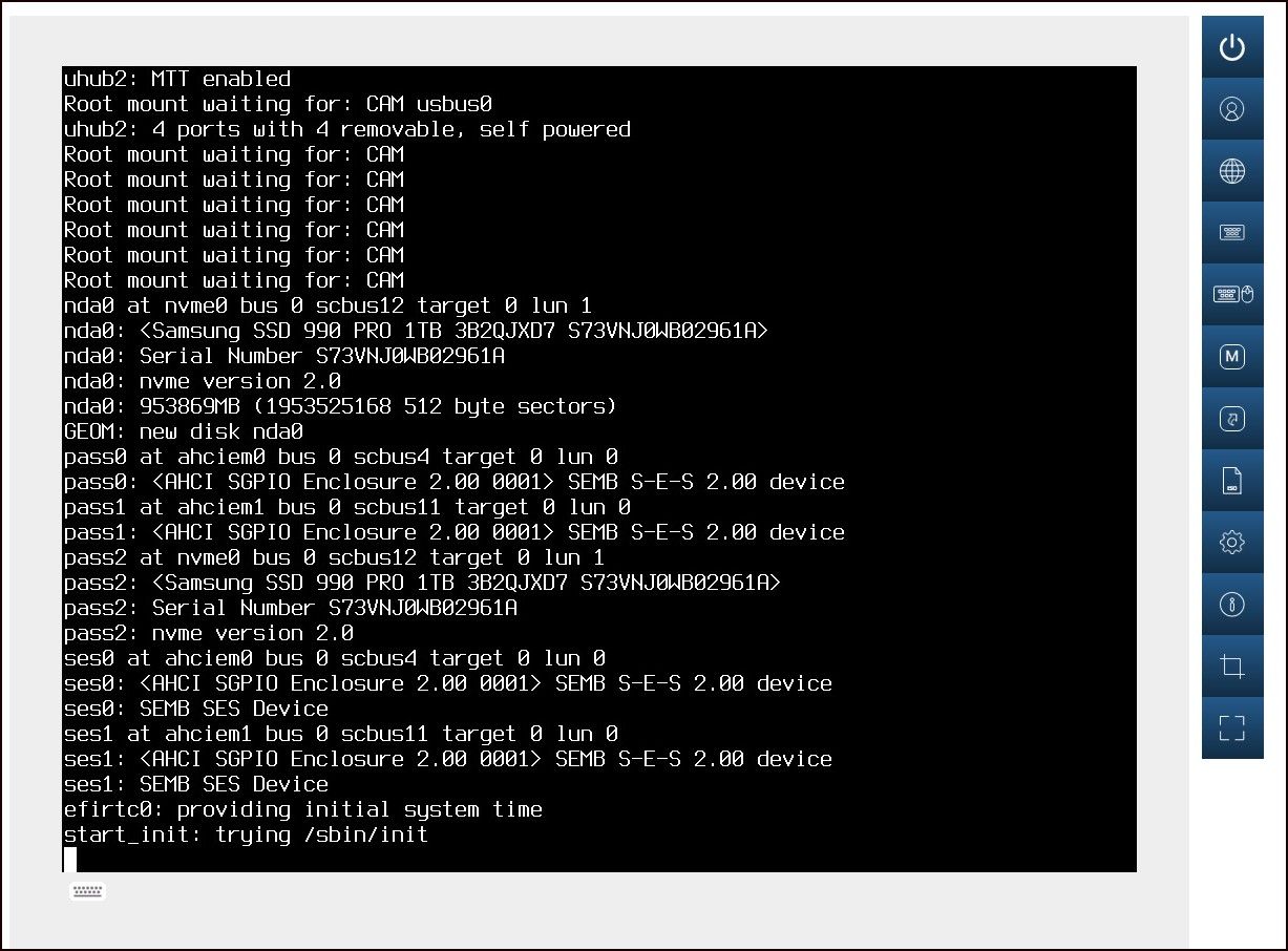

                                      I just can't get it to load pfSense. This was the console output with Verbose logging turn on and using the Serial console output. (was the same when using just Video console)
                                      I'm not sure what to do next.
                                      tinfoilmattT 1 Reply Last reply Reply Quote 0
