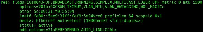

        I don't remember exactly now and it's different with the older driver I'm currently running, so I can't look it up, but I believe only TXCSUM_IPV6 was removed. For sure TXCSUM and RXCSUM were still there on 1.100.00 after running ifconfig re0 -rxcsum -txcsum -rxcsum6 -txcsum6.
        What I get now with disable checksum offloading checked on the 1.98.00 driver is:
        [2.8.0-RELEASE][admin@router]/root: ifconfig re0
        re0: flags=1008843<UP,BROADCAST,RUNNING,SIMPLEX,MULTICAST,LOWER_UP> metric 0 mtu 1500
        	description: LAN
        	options=2018<VLAN_MTU,VLAN_HWTAGGING,WOL_MAGIC>
        	ether xx:xx:xx:xx:xx:xx
        	inet x.x.x.x netmask 0xffffff00 broadcast x.x.x.x
        	inet6 x::x prefixlen 64 scopeid 0x1
        	media: Ethernet autoselect (2500Base-T <full-duplex>)
        	status: active
        In this case everything checksum related was disabled as expected. The 1.100.00 driver as you are seeing as well doesn't allow clearing all the flags. The behavior appears to vary I guess depending on the particular chipset?
        SpunkThingS 1 Reply Last reply Reply Quote 0

          Yeah if you run ifconfig -vm re0 it should show you what the driver thinks the hardware is capable of too.
          zeroepochZ 1 Reply Last reply Reply Quote 0

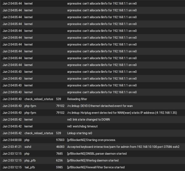

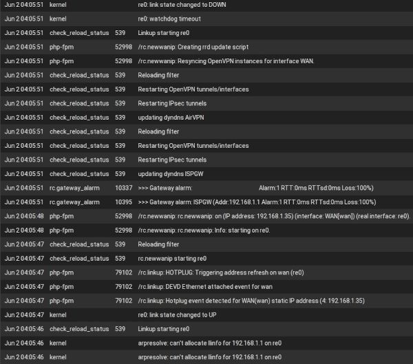

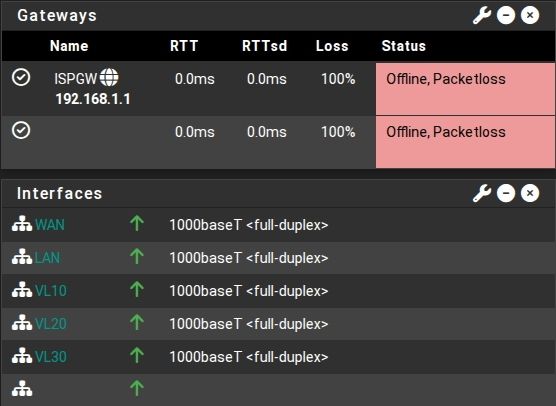

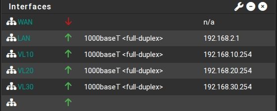

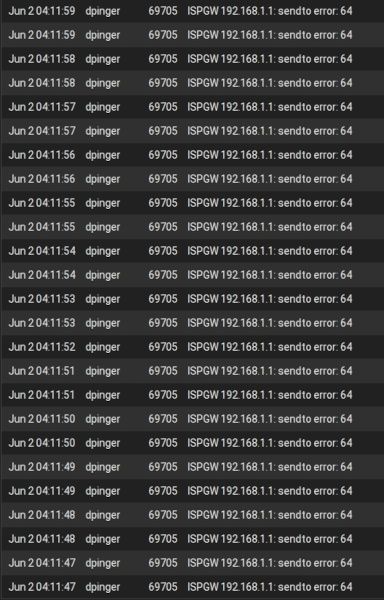

            Took me a while but I finally have an update.
            Unfortunately it did exactly the same as the 1.100.00 driver.
            And to make things even stranger, both these drivers left my pfSense installation inoperable even after uninstalling them.
            I've not got the faintest idea what kind of voodoo witchcraft sorcery stuff is at work here.
            The first time after installing your version of the 1.98 driver the WAN interface immediately came online after the system rebooted, so I thought bingo!
            Less than 3 minutes later it collapsed just like before.
            The only difference is that this time it was possible to bring it back online by disabling the interface in the GUI and then enabling it again. Not every time though.
            I noticed that in the Gateways widget there sometimes was a downward facing red arrow next to the WAN interface. When this happened it could only be brought up again by first doing ifconfig re0 up via SSH and then the GUI steps.
            So after fiddling around for a while I decided I had enough and removed the driver, rebooted and to my shock and horror the same strange thing occurred. The WAN interface was down after booting like with the 1.100.00 driver. It could be brought up either through the GUI or ifconfig + GUI, but like before it always went down within a matter of minutes.
            I dug up some other, more recent unused computer parts including a different NIC. Still a Realtek based one, but who knows.
            Now putting it together and I'll do a fresh install of pfSense 2.7.2 to see how that works out.
            Attached a few screenshots again. Maybe, hopefully there is something useful to be seen in them.
            If you'd like any other info about my latest adventure, feel free to ask.

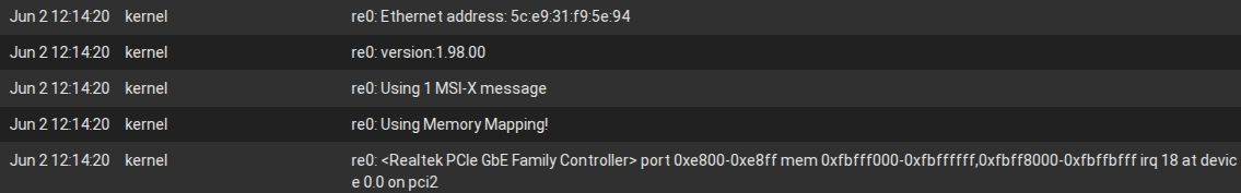

              Are you sure it's actually loading either of those drivers and not just hitting a timeout on the in-kernel driver?
              You should see the version reported in the boot log if a module is loaded correctly.

                Thanks for sharing that command! I was reading online 1.99+ added support for IPv6 checksum offloading, which explains why the suggestion to disable IPv6 (set to None) on those interfaces helps somewhat.
                For 1.98.00 I get:
                capabilities=381b<RXCSUM,TXCSUM,VLAN_MTU,VLAN_HWTAGGING,WOL_UCAST,WOL_MCAST,WOL_MAGIC>

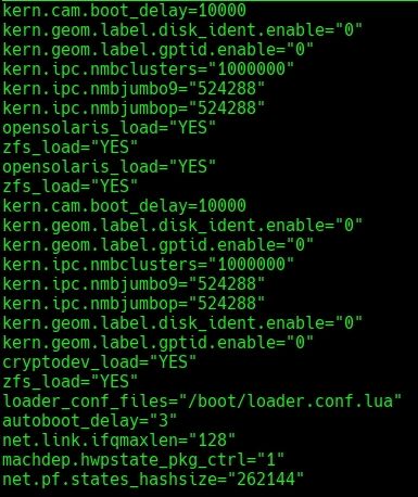

                  If I'm reading your output correctly (based on kern.ipc.nmbjumbo9?) you enabled jumbo frames? If not there is an additional setting you can add to /boot/loader.conf.local to fix a possible hang (if not using jumbo frames). I did the following on my system.
                  By default, the size of allocated mbufs is enough
                  to receive the largest Ethernet frame supported
                  by the card.  If your memory is highly fragmented,
                  trying to allocate contiguous pages (more than
                  4096 bytes) may result in driver hangs.
                  For this reason the value is tunable at boot time,
                  e.g. if you don't need Jumbo frames you can lower
                  the memory requirements and avoid this issue with:
                  hw.re.max_rx_mbuf_sz="2048"
                  My /boot/loader.conf.local looks like:
                  if_re_load="YES"
                  if_re_name="/boot/modules/if_re.ko"
                  As @stephenw10 suggested you should check dmesg to see what version was loaded.
                  # dmesg | grep "re[0-9]: version:"
                  re0: version:1.98.00
                  re1: version:1.98.00

                      SpunkThing @zeroepoch
                      @zeroepoch
                      That's not something I would deliberately enable. At least not that I remember.
                      Actually I think that's one of those things I used to turn off on network adapters in Windows in the old days because it caused trouble.
                      But on the other hand I am the type that messes around with settings often while not completely understanding them. So don't rule it out completely.
                      Anyway, as I said I'm currently working on a fresh installation of 2.7.2 and that version has always worked nicely for me, except for that one problem with the WAN going down under "heavy" loads. Suppose I'll be looking out for better NIC's if it happens again. ๐Ÿ˜…
                      I'll restore a recent-ish configuration backup and leave it at that for the time being.
                      I'll keep following this though if you decide to dive further into it.
                      Very curious why both drivers were acting up on my system while they work fine for you.
                      Could be anything, my messing in settings not being the least likely of causes... Hehehe
