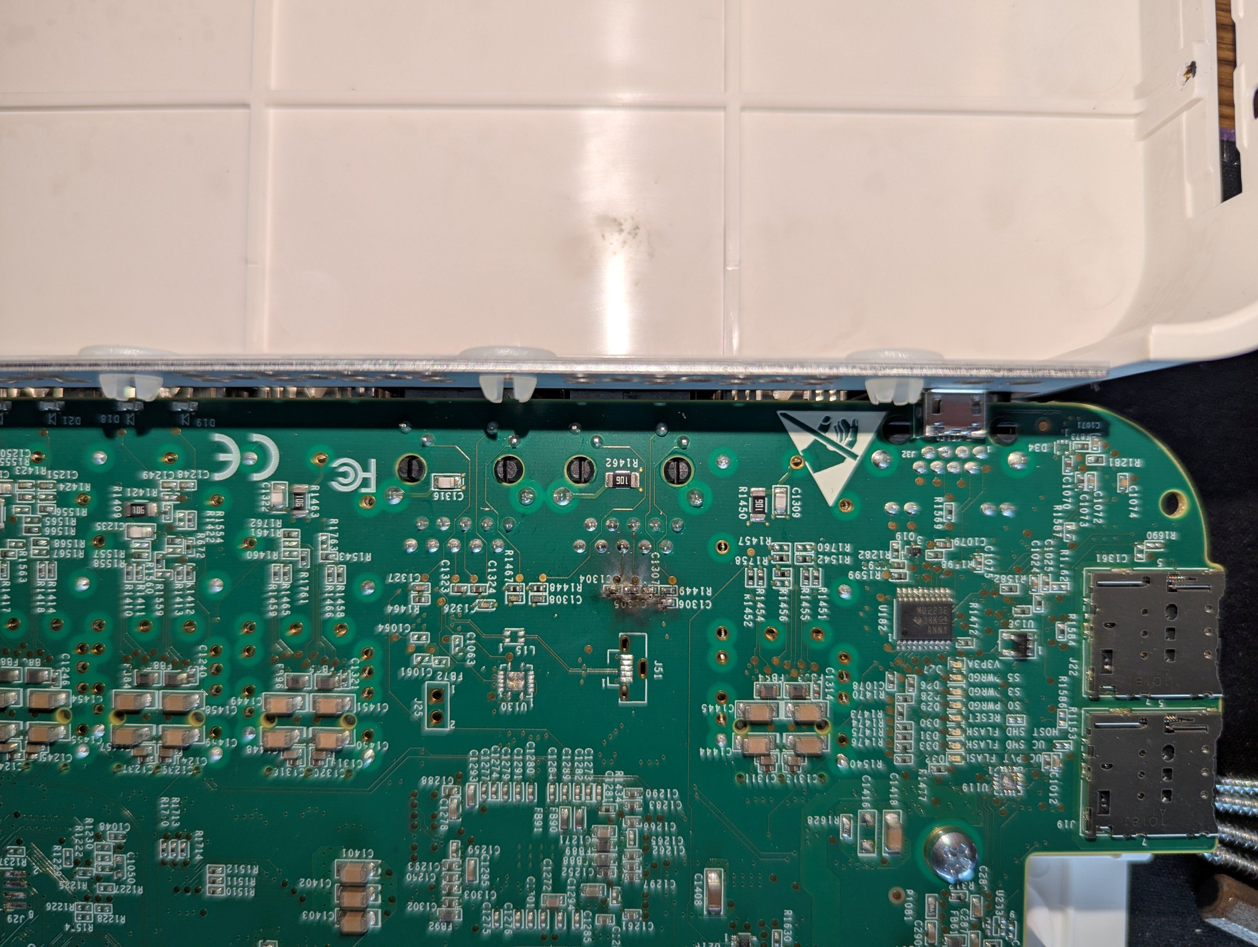

      Hello.
      I recently had a lightning strike that fried some of the parts inside my 6100 MAX. I did have the unit plugged into a APC UPS but the surge came through the cable internet and through the ethernet. It also fried the ethernet port on one of my PCs.
      The 6100 MAX will boot up for a bit but then shuts down after about 3 minutes. I do not get any sort of login to the box, and my PC does not receive an IP. I am assuming it is stuck in a boot loop and then times out.
      My question, is there any way to get the configuration off the unit to be imported to a new 6100 MAX unit?
      My assumptions is no, since I read in the online manuals that the configuration is stored on an internal chip and not the SSD that comes with the 6100 MAX. Worst case is I will have to go through and set up the new unit.

                  Burizado @patient0
                  @patient0 Yes, true.
                  I do believe it is fine, as I see no physical damage like I see on the main board (see image; you can actually see where it left a mark on the white lid as well).
                  I do have a few external cases I can put it in and connect to my PC or UNRAID server to see if it is still good (I know you mentioned before it needs to be a FreeBSD based OS).
                  • patient0P Offline
                    patient0 @Burizado
                    @Burizado said in Netgate Configuration Export (6100 MAX):
                    Wow, no doubt about the damage there.
