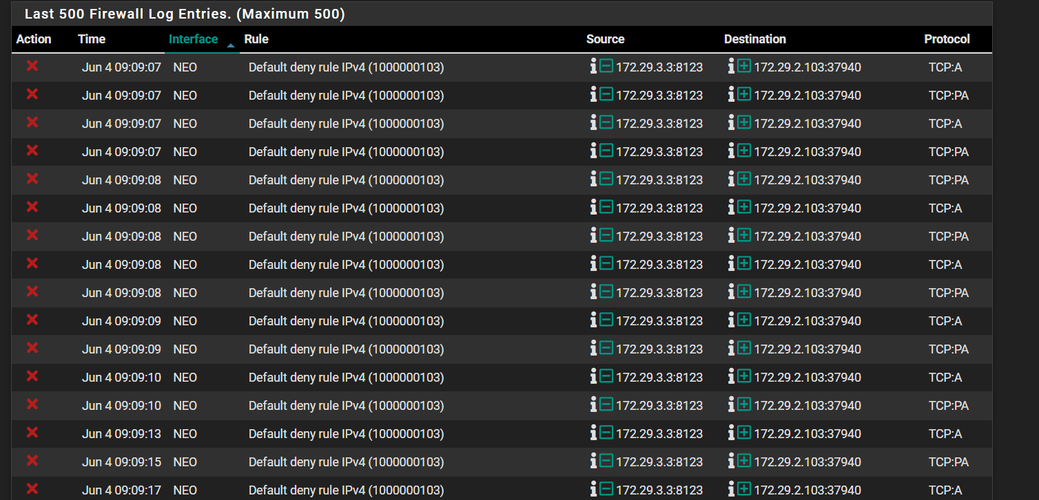

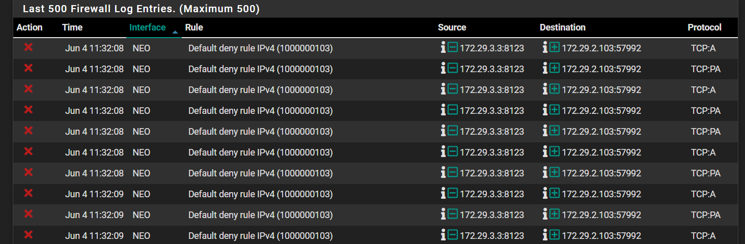

      Browser on network port igc1 (172.29.2.0/24, aka Trinity) trying to access web site (Home Assistant) on port igc2 (17.29.3.0/24, aka Neo) and the return packets are getting block by a Default Deny Rule. The odd part is this used to work just a few days ago, but I don't recall changing anything in the Firewall Rules:

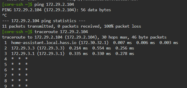

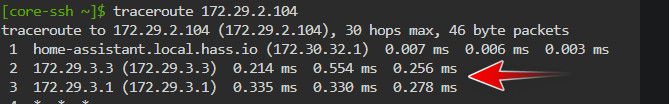

      Ping between the two devices works both ways, and traceroute reports just 2 hops (both ways).

          And these entries are still appearing in the Firewall Log:

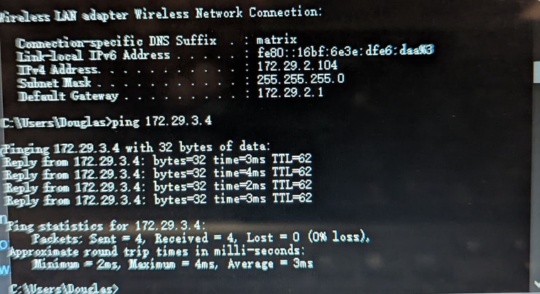

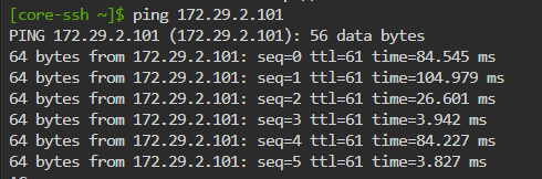

                This is odd. I could have sworn I could ping the browser PC on 172.29.2.104 from HA on 172.29.3.4, but now I cannot. Maybe I had confused myself before.
                From Windows PC to Home Assistant
                From Home Assistant to Windows PC

                  Ok. Turns out Windows PCs don't like to be pinged.
                  iPads don't care.
                  So data (pings) are crossing over between 172.29.2.x and 172.29.3.x

                        I let it run again, from my Pixel Phone on 172.29.2.102 until its finally timed out, then checked the Firewall logs: No 'SA' anywhere. Just 'A' and 'PA'

                              @DaHai8 I would sniff to see if you are seeing the SA, and then just traffic stops? Maybe one side sent a fin or a rst - and the state closed.
                              You really need to see a packet capture that captures the full conversation.
                              The reason ack are blocked is there is no state to allow it.. Why the state is not there is what you need to figure out. Either your traffic is asymmetrical and pfsense never saw the syn to open the state. Or the state went away at some point and that is when you start seeing blocks.

                              edit - this trace looks really wrong to me.. Why would you have 2 hops in the same network? And that first hop - that is odd name for your pfsense box ;)
                              Can you put together a napkin drawing of how you have this connected together - what are the 3.3 and 3.1 boxes?

                              Also that first hop - .007 ms - that has to be itself that your tracing from - is that a container network or something? Are you running this stuff as VM?
                              If your tracing from a 172.29.2.x - why is your first hop an IP in 172.30.32??
