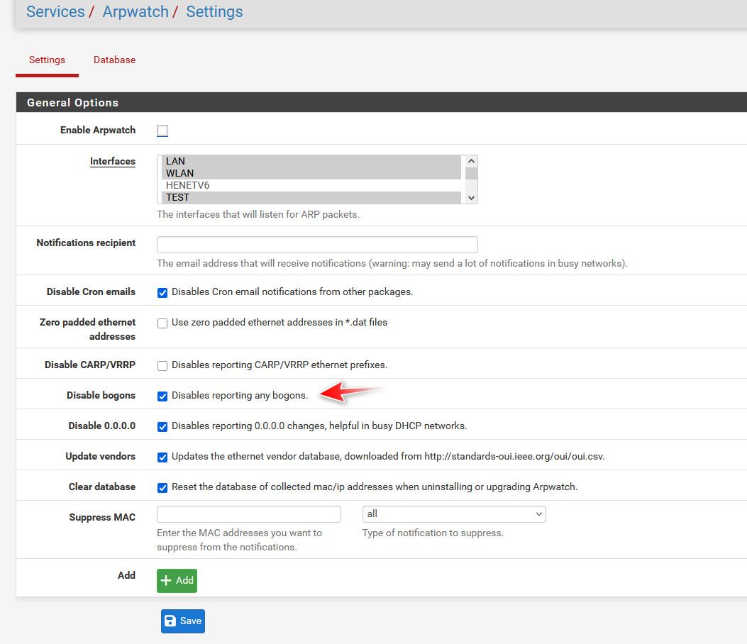

                    I haven't ran it in a long time - its too noisy, that one where 0.0.0.0 changes disable report, I am pretty sure that just doesn't work - but thought the disable bogon did.. Maybe something changed in 25.03? Do you have that set? And still seeing them?

                      I set wrong IP on device - and bam!!!! let see if disable bogon stops those?
                      edit: ok telling it to disable bogon got rid of that flood, but did get notice of new station
                      Jun 4 16:59:28 arpwatch 23451 new station 192.168.33.10 2:11:32:28:ef:98
                      But the network its on is actually 192.168.3.0/24 I don't have a .33 network.. So if your being flooded, seems to me arpwatch is seeing some device traffic on the wrong interface for that source IP.

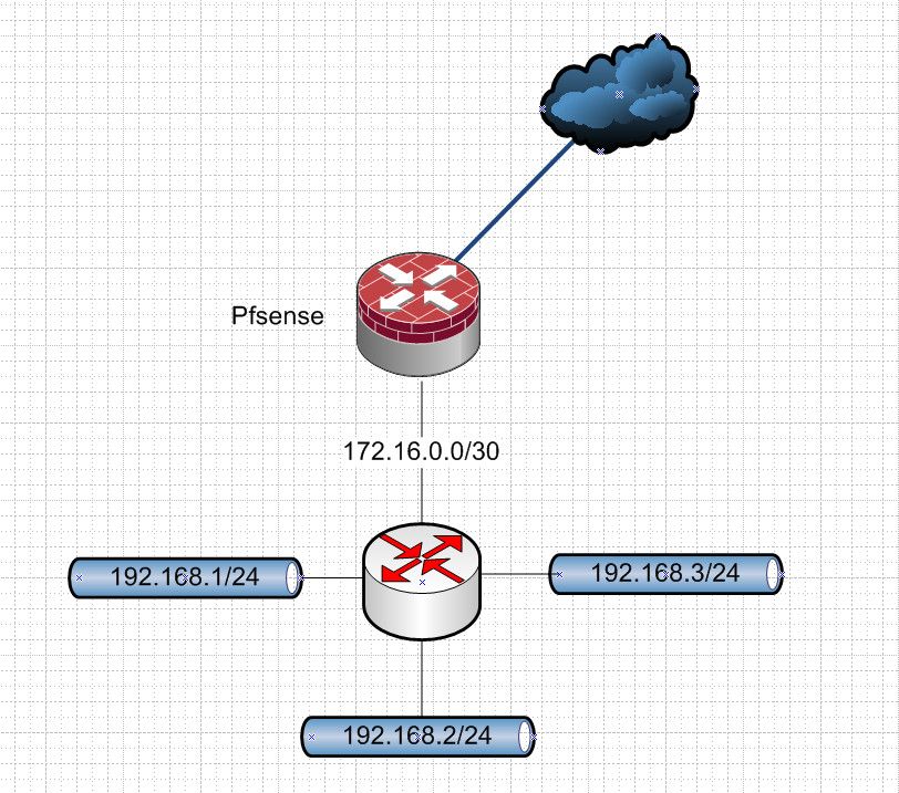

                                        Is your switch management IP a downstream network being routed over a transit/connector network?
                                        If you had something like this, where some downstream router was routing over a transit into pfsense to be routed, then yeah pfsense seeing traffic sourced from say 192.168.2.x into its 172.16.0.1/30 interface would be normal and shouldn't be reported as bogon by arpwatch.
                                        arpwatch should have a method of listing what source networks could be seen on an interface, so not to report such traffic as bogon without having to turn off reporting of bogon completely.
                                        It is also possible that arpwatch is looking at traffic it shouldn't be to report that. If you have an physical interface say igb0 and then you have sub interfaces for vlans igb0.10 igb0.20 etc.. arpwatch shouldn't be reporting that traffic meant for igb0.20 for example with a tag of vlan ID being seen on igb0 which it would be but tagged shouldn't be reported as bogon.
