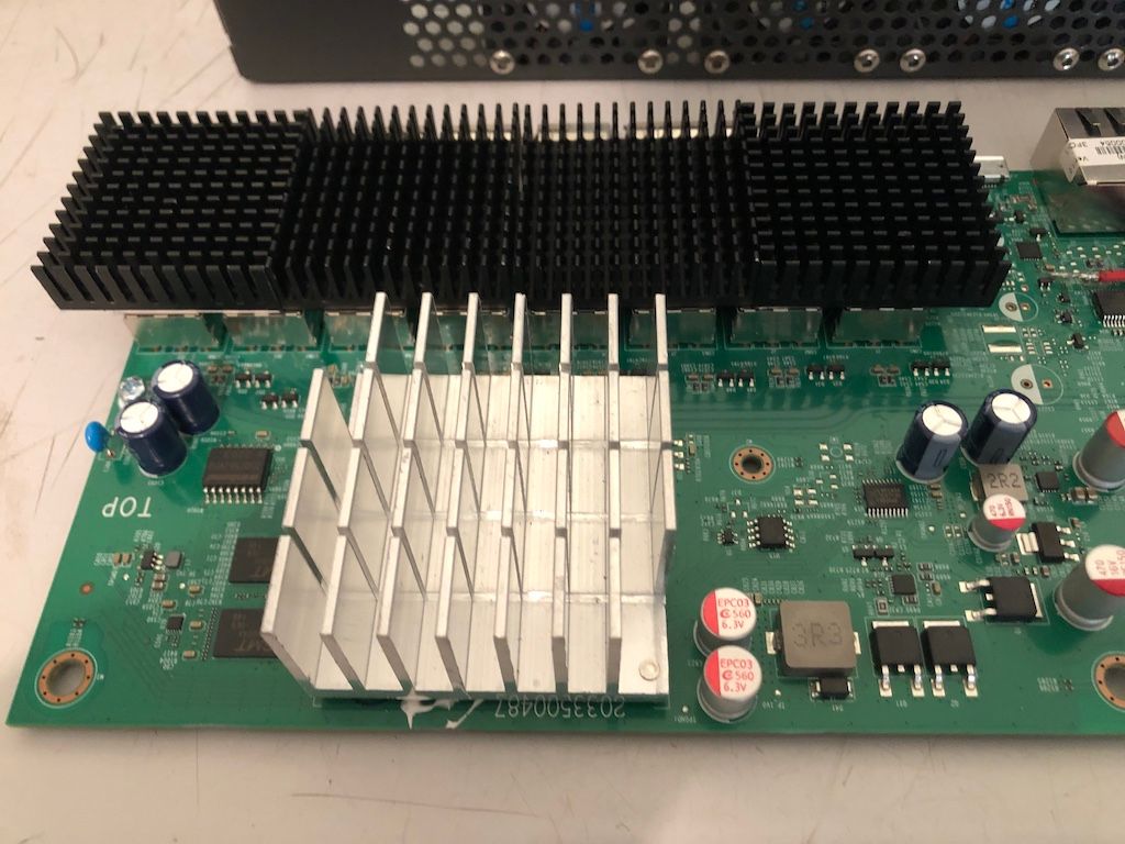

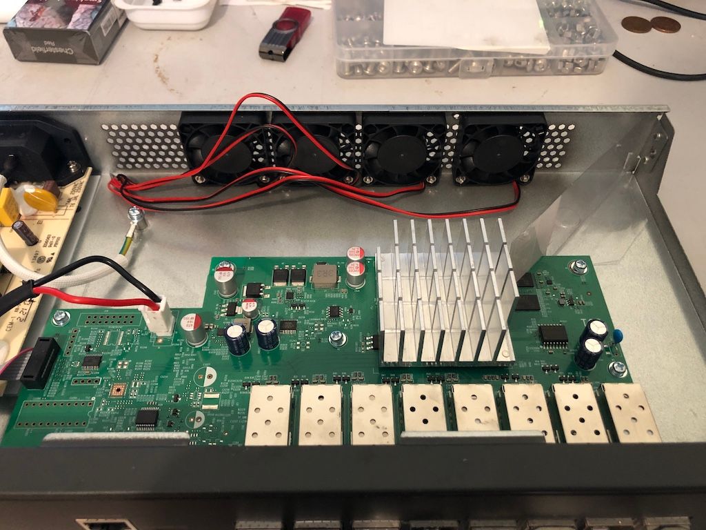

                                  We did have quite bad over-heating issues in a TP-Link SX3008 switch. The problem was the SFP cages, so we modified the switch adding cheap self-adhesive heatsinks. Attached pictures show the main board before & after. Approx 20degC SFP temperature reduction.

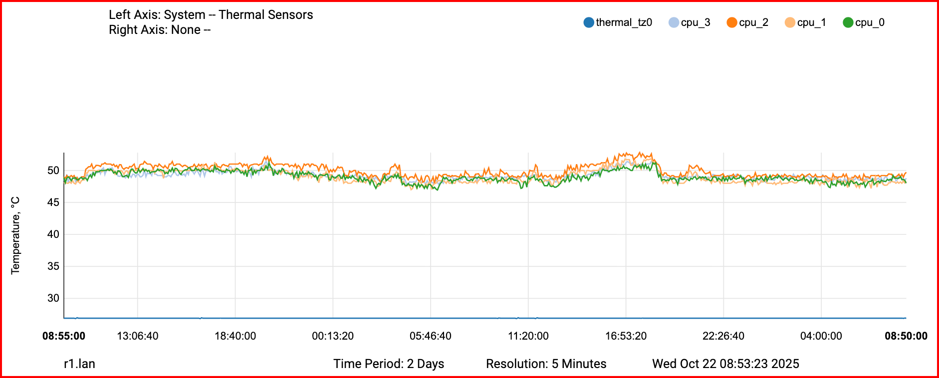

                                          @stephenw10 Thanks. I've already somewhat wrecked the SFP cage of my 6100... somehow the old module got stuck in there, and no amount of jiggling would release it. I just kept pulling on it until it eventually came loose. Now the modules no longer lock/click in place they just sort of slip in and out.
                                          The thermals on the CPU itself seem "ok" and tend to hover right around 50C:
