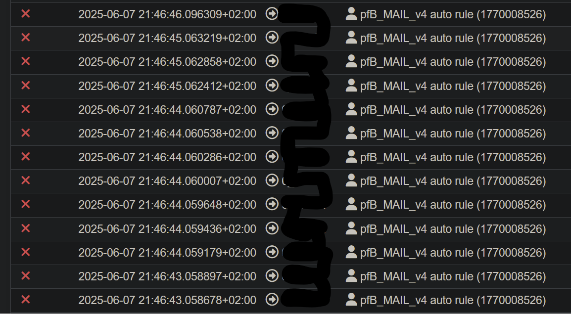

      As a test I changed pfBlockerNG to use floating rules instead of the per-interface rules I had always used. It did not go well, I got immediate blocking of everything going out on the WAN.
      The cause seems to be the MAIL spammer IP list configured:
      It is configured to deny inbound only, so it doesn't make any sense to block the outgoing direction.

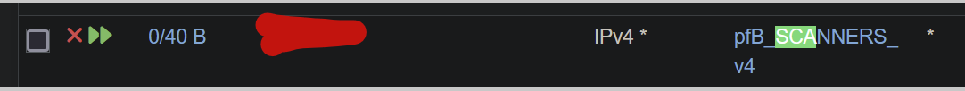

      I checked the floating rule, and it had direction "any" configured. Once I changed it to "in" traffic started to flow out of the WAN again. Every generated floating rules seems to be bi-directional, SCANNERS for example
      gets this floating rule
      whereas it should have been a
