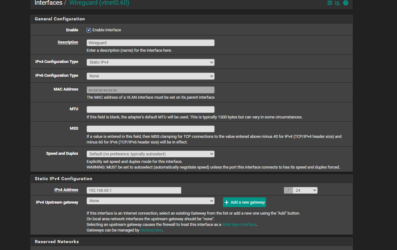

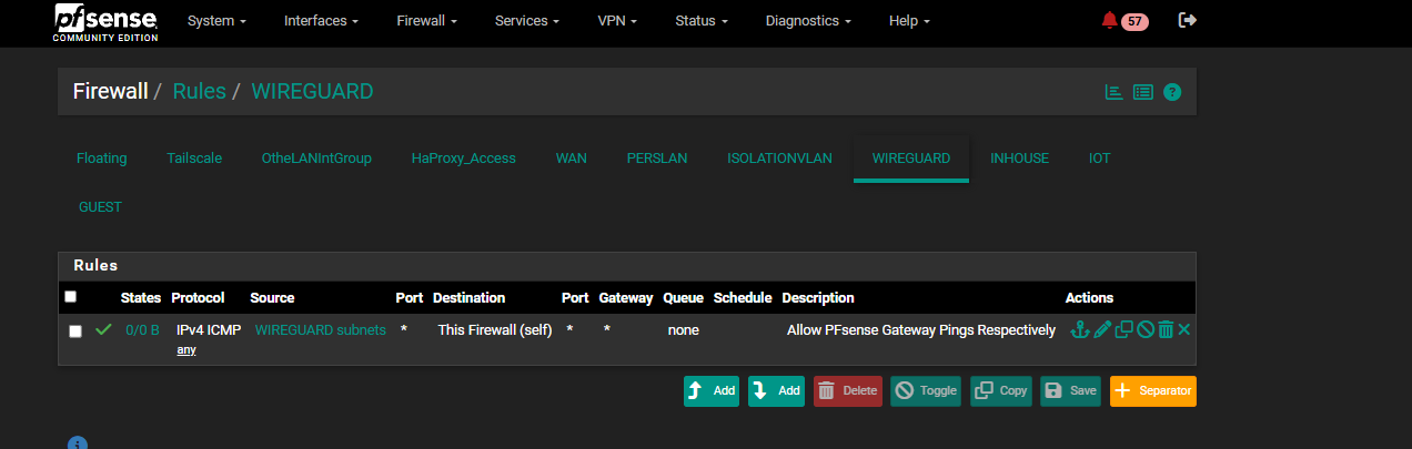

    Hi All,
    I'll get right to the point and I'll admit if it's my own fault, but I cannot see why this VLAN 60 (192.168.60.x /24) cannot ping its own gateway (Eg 192.168.60.2 (Linux VM Host) -> 192.168.60.1 (Pfsense Vlan Interface))
    I already have 3-4 other vlans that have different ID and ip ranges and all work fine. Some are for physical devices, some are VMS. In this case, I am pinging or attempting to hit pfSense from a VM. All physical interfaces are trunked and allow for the respective VLAN ID just like the others do now and work fine, but for some reason I cannot get 192.168.60.2 to ping 192.168.60.1.
    I will post my rules below and changes I have made. "WireGuard" is the name of the interface for VLAN 60.
    5ea0890e-1458-4a32-9069-5d56b7965c68-image.png 4f30e2cd-3f1e-4bd5-9be0-b22cc1488153-image.png 01e731cd-d327-4ac3-bdd9-7ae4418afdbe-image.png

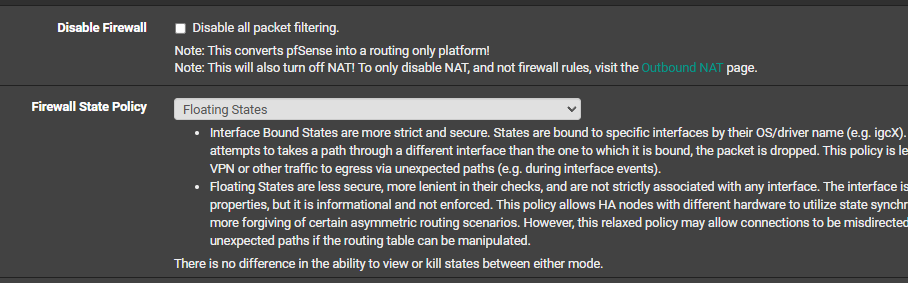

    Unsure if it helps, but I'm using kea DHCP, although this is all with static IPS and I have changed the firewall state policy to "floating states"60186600-28cb-40cc-9849-1f43ac765921-image.png

              Your rule looks ok so it might be a problem outside of pfSense.

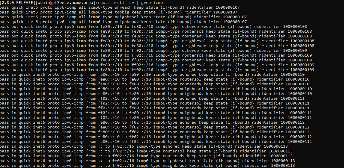

                  Not sure if this helps and came from chat, but ran this in the pfsense shell and my icmp rule if im not mistaken should be labeled here but its not.

                    I have a feeling my issue is for some reason after submission via the webgui its not actually applying it on the backend.

                        It appears after more digging I found my fix. Sort of my fault In a way. I noticed in the command above that my rules that were being applied from the webgui were not showing on the backend rules. After scratching my a head a while, I looked at pfblockerng and noticed it was creating a lot of table IP entries and erroring due to limit. I did enable Geo and IP blocking which would created massive lists and due to this getting stuck it wouldn't write my firewall changes down. So I have adjusted the list limit and audited the IP lists I have enabled, and my rules are now showing.
