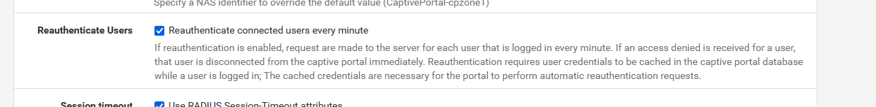

          Ones logged in, when I changed the password, and because I've set this :
          the user was thrown of the portal within a minute 👍
