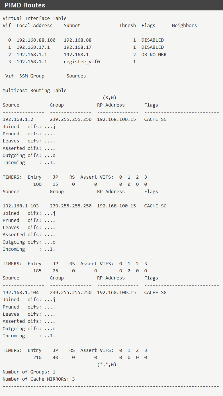

                                              pkg remove pfSense-pkg-pimd-3.0.1
                                              pkg remove pimd-3.0.b1
                                            • installed them again from the roots home
                                              pkg install pfSense-pkg-pimd-3.0.1
                                              pkg install pimd-3.0.b1
                                            • installed pimd from the pfsense package manager
                                              I did not remove my pimd config so that config is still there
                                            • start pimd from the pimd service menu now present option pimd
                                            • pimd starts and status shows info but the output is not showing pimd clients as expected. (see picture below)
                                            • looking in the system logs System LogsSystemGeneral
                                              I see that pimd has problems with the config
                                              Jun 13 08:01:49 pfSense pimd[3561]: /var/etc/pimd/pimd.conf:14 - Invalid phyint address 'mlxen0.26'
                                              Jun 13 08:01:49 pfSense pimd[3561]: /var/etc/pimd/pimd.conf:13 - Invalid phyint address 'lagg0.130'
                                              Jun 13 08:01:49 pfSense pimd[3561]: /var/etc/pimd/pimd.conf:12 - Invalid phyint address 'bridge0'
                                              Jun 13 08:01:49 pfSense pimd[3561]: Recommended querier timeout = Robustness x query-interval + response-time / 2 = 3 x 12 + 10 / 2 = 41
                                              Jun 13 08:01:45 pfSense check_reload_status[678]: Syncing firewall
                                              Jun 13 08:01:44 pfSense php-fpm[68271]: /pkg_edit.php: Configuration Change:
                                              Jun 13 08:01:37 pfSense pimd[90461]: /var/etc/pimd/pimd.conf:14 - Invalid phyint address 'mlxen0.26'
                                              Jun 13 08:01:37 pfSense pimd[90461]: /var/etc/pimd/pimd.conf:13 - Invalid phyint address 'lagg0.130'
                                              Jun 13 08:01:37 pfSense pimd[90461]: /var/etc/pimd/pimd.conf:12 - Invalid phyint address 'bridge0'
                                              Jun 13 08:01:37 pfSense pimd[90461]: Recommended querier timeout = Robustness x query-interval + response-time / 2 = 3 x 12 + 10 / 2 = 41
                                            So on my machine PIMD (as said the version as compiled long ago) is running but not the way it should. I still have to find out why.
