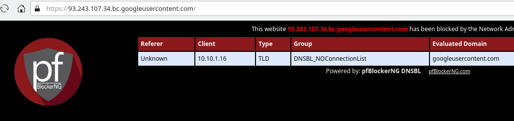

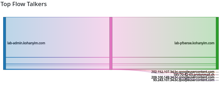

      Evening, I can block connections via browser to *.googleusercontent.com, but firefox, librewolk, and alike connects internally by code. I can see these connection via ntopng:

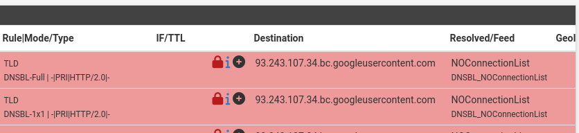

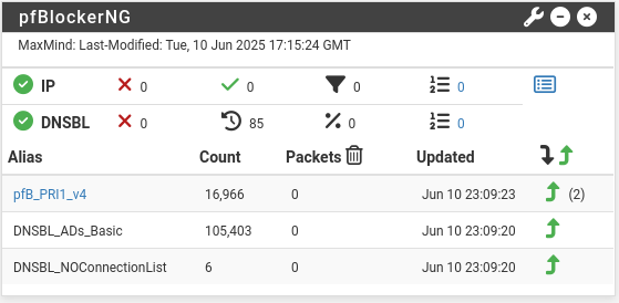

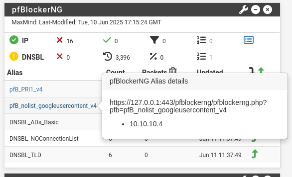

      and the packets [DNSBL_NOConnectionList are not showing there being blocked:
      only when I try to connect via brower:
      So, how can I block any IP trying to connect via browser, application, etc., using pfBlockerNG?

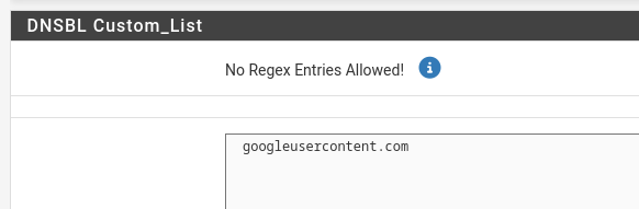

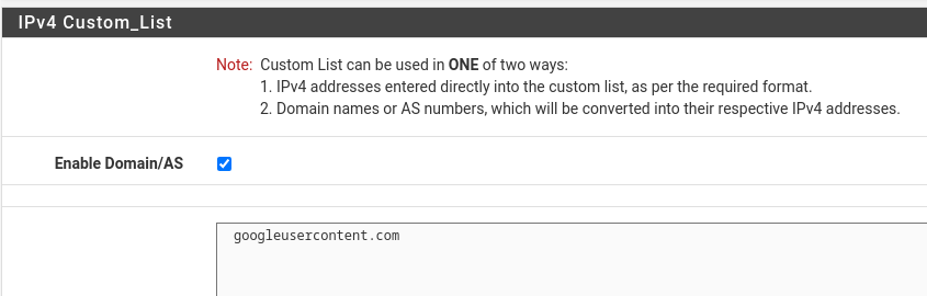

      I tried this:
      and this:
      and my /var/db/pfblockerng/google.txt is:

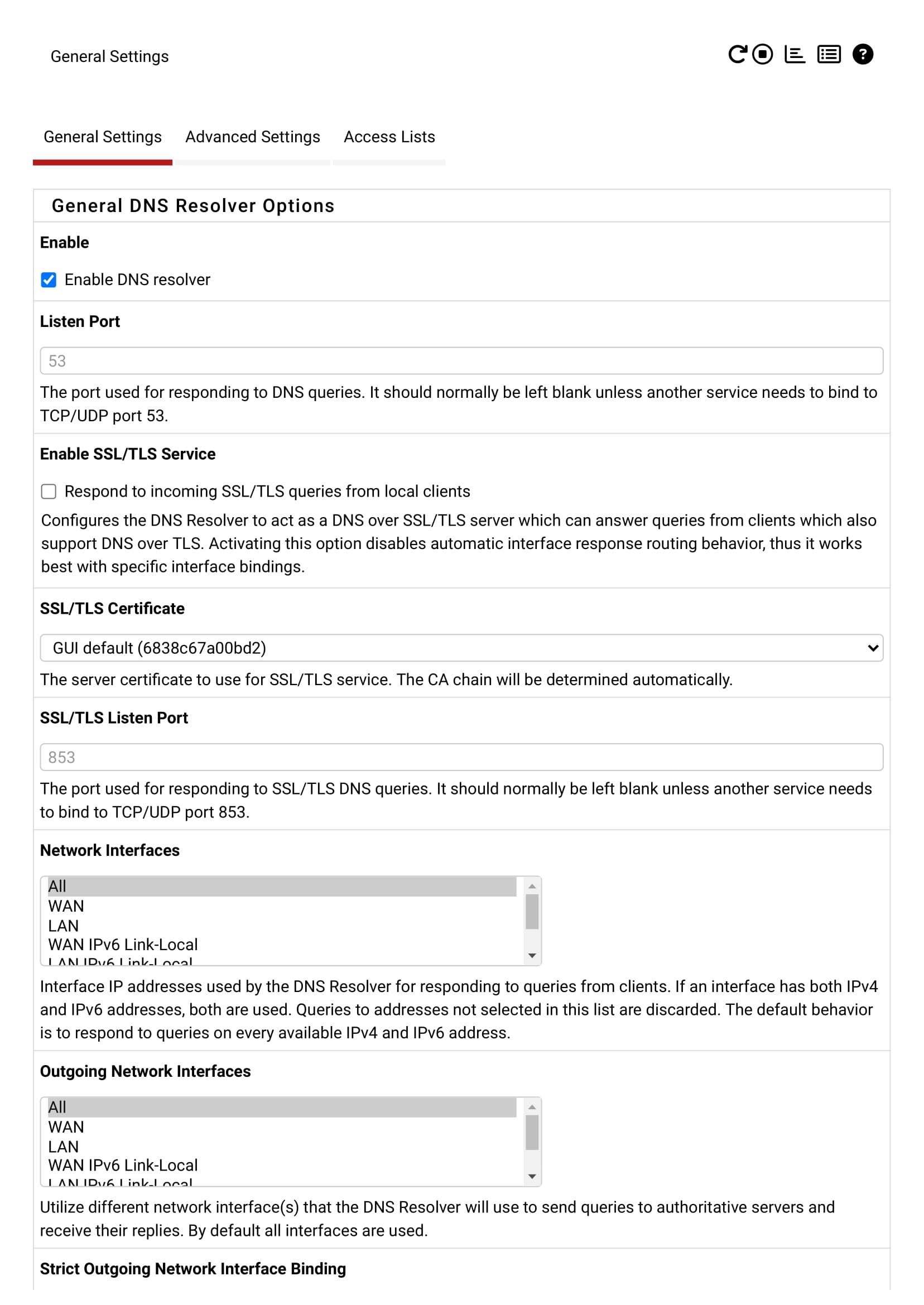

          Okay, I have those set, but not getting any hits on the packet blocks. This is how my DNS Server / General Settings look:
          Do I need to change anything?

              Even tried this pfBlockerNG Customize Blocklist with:
              IPv4 Cust_List:
              bc.googleusercontent.com
              209.100.149.34.bc.googleusercontent.com
              191.144.160.34.bc.googleusercontent.com
              93.243.107.34.bc.googleusercontent.com
              202.152.107.34.bc.googleusercontent.com
              and
              TLD Blacklist:

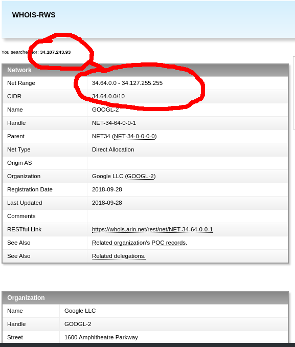

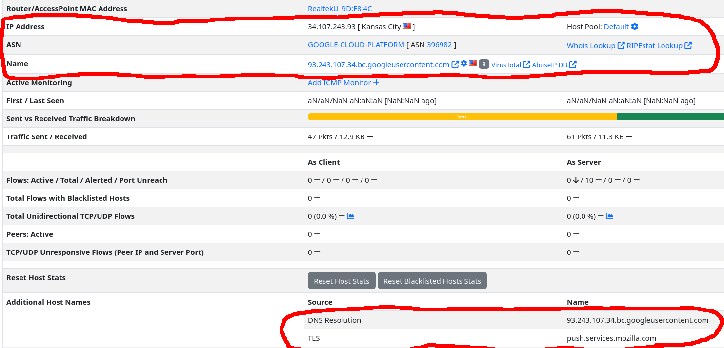

              and Librewolf and Firefox is still connecting with no block hits. Looking at ntopng in little details I get this:
              Host:
              ARIN Look-up has:

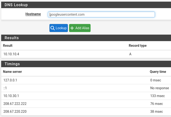

              Could this be the reason its not being blocked? It appears too, because pfBlocker is coming up with:
              on the IPv4. The DNS Lookup is returning:
              What goes on? How do I properly just block all googles:
              Net Range	34.64.0.0 - 34.127.255.255
              It appears to be some masquerading here to defeat the pfBlocker? Maybe pfBlocker should make changes to use:
              http://itools.com/tool/arin-whois-domain-search
              as does ntopng.
              • U
                Uglybrian
                Hi, your OPEN DNS servers are using DOH. Thats why its not working, consider using resolver mode. Aso, what is 10.10.30.1?

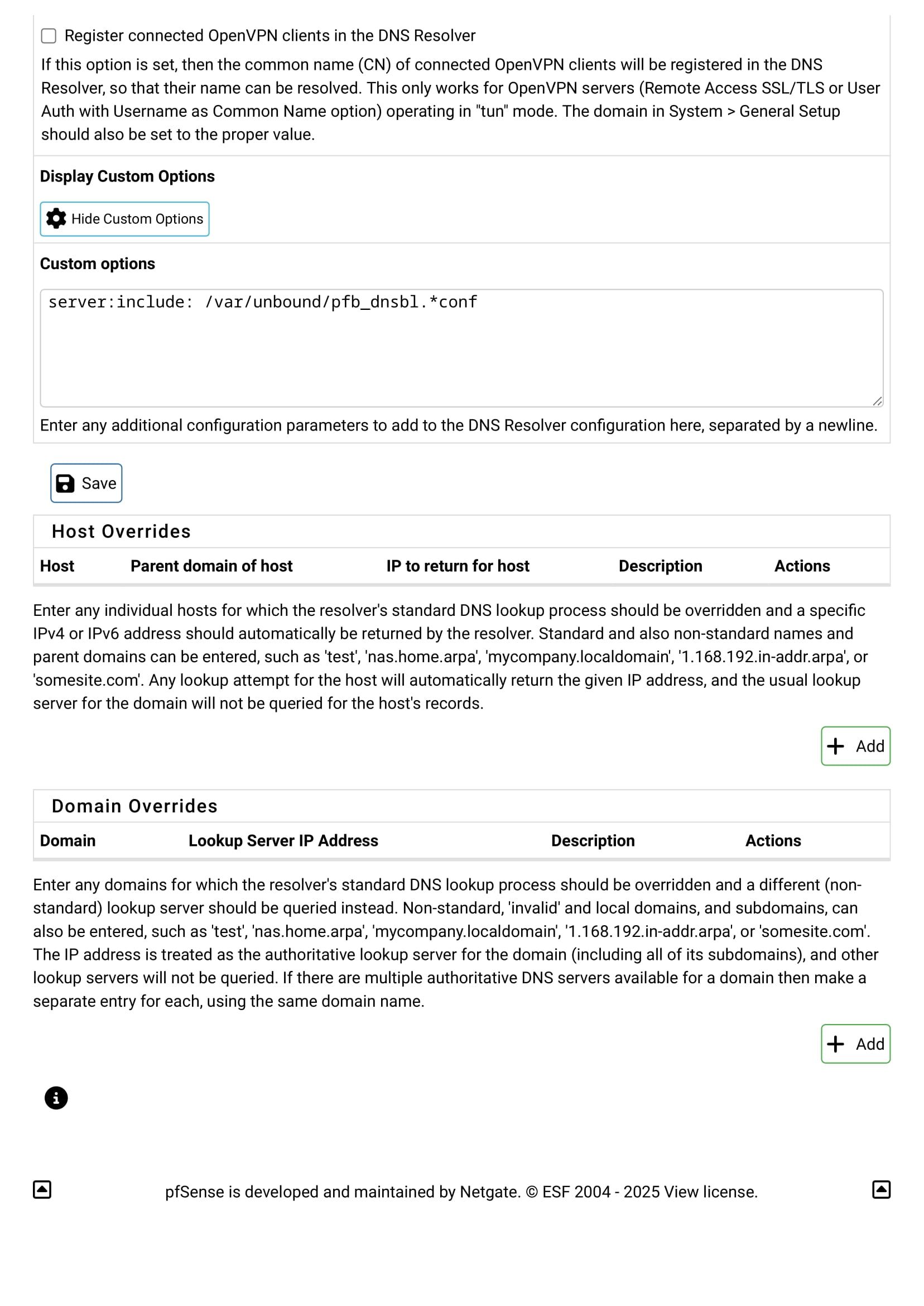

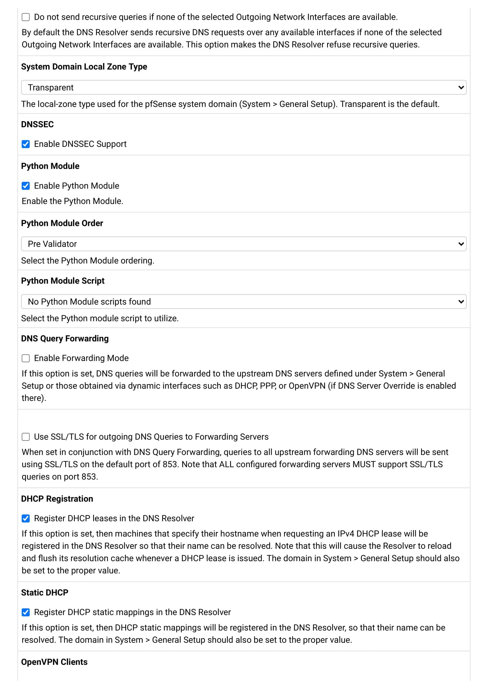

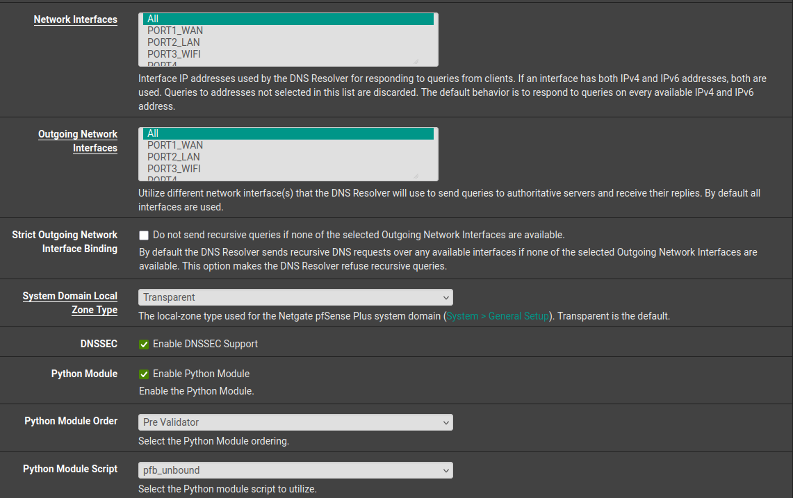

                    Below are my resolver settings. Its stock settings with only 2 changes. In system General set up. I changed DNS resolution behavior to ignore remote DNS servers from fall back.
                    In resolver I use python mode for pf Blocker. All other settings are stock.
                    I am still using ISC as my backend. If you decide to make these changes, afterwords reset your state table.

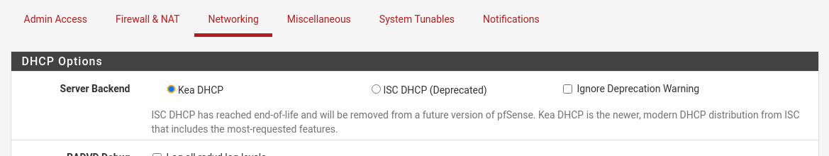

                      What is ISC?
                      UPDATE: I did a reset and just made adjustments to your settings. I also found my answer for ISC switching to the Kea DHCP and hoping this will give me the same results as your setup:
                      Anything else you can suggest to make sure I get the same results as you making sure pfBlocker handles all (browsers, apps, etc.) port 53 requests?

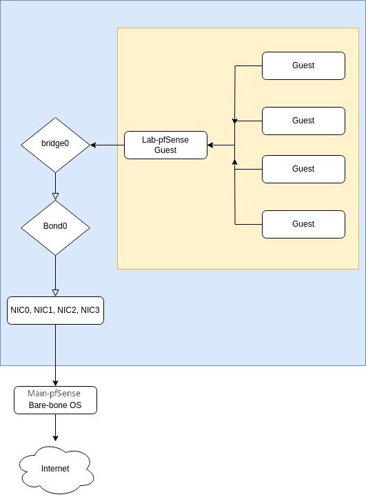

                          Yes, I've done this before myself in another system but keep putting it off for my current, I used pfSense pfBlockerNG configuration guide. So I decided today to get this back working. Its much easeir using granular control then generic. My system diagram is like:
                          I will be using the above quide for the Lab-pfSense. I was trying to get blocking working just using pfBlocker alone, but unsuccessful. This guide and pfSense baseline guide with VPN, Guest and VLAN support for the Bare-bone pfSense.
                          What do you think, any inputs and additions?
