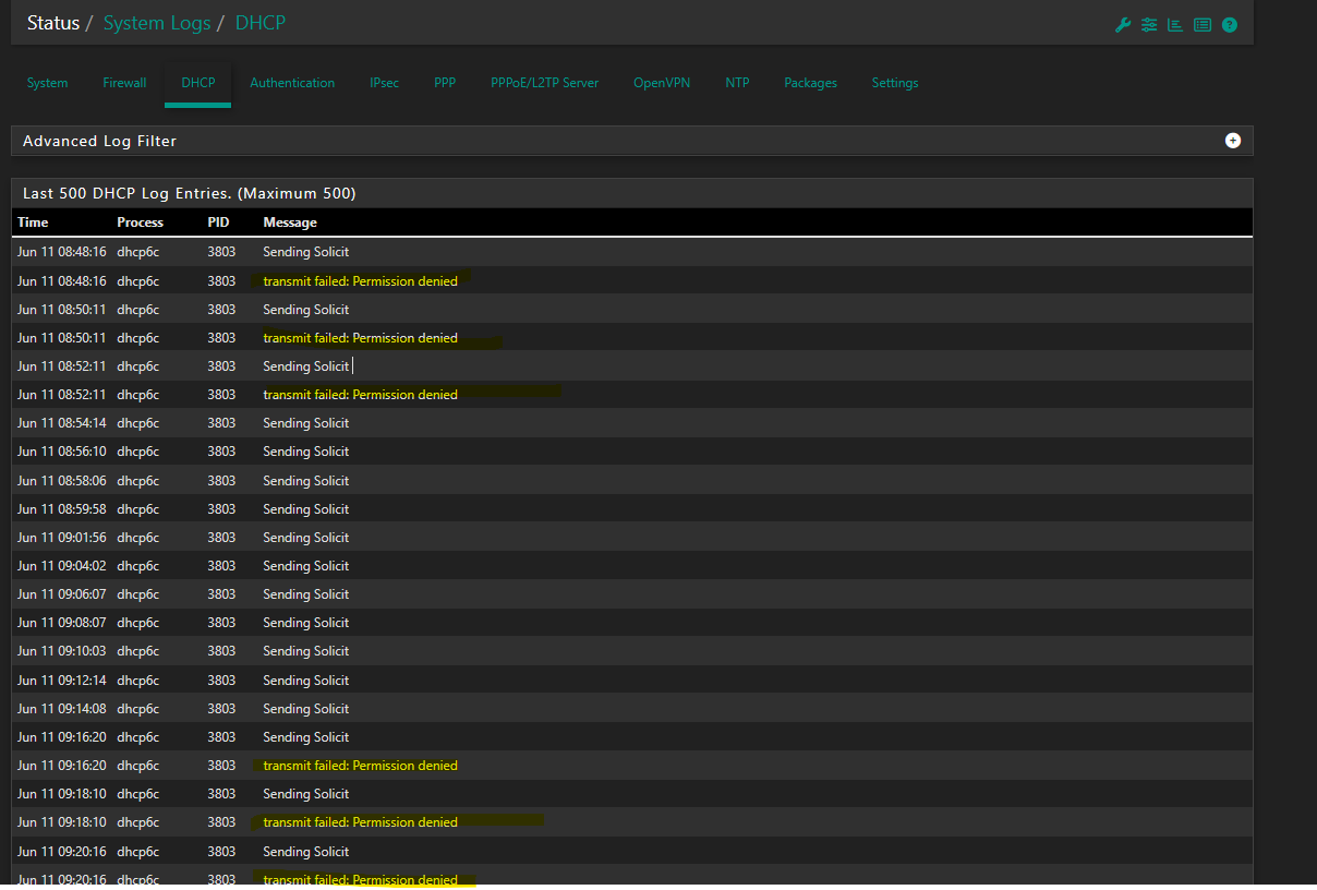

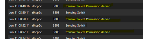

      The last I found in the logs was this strange error.
      Can you please give me an advise what to do?

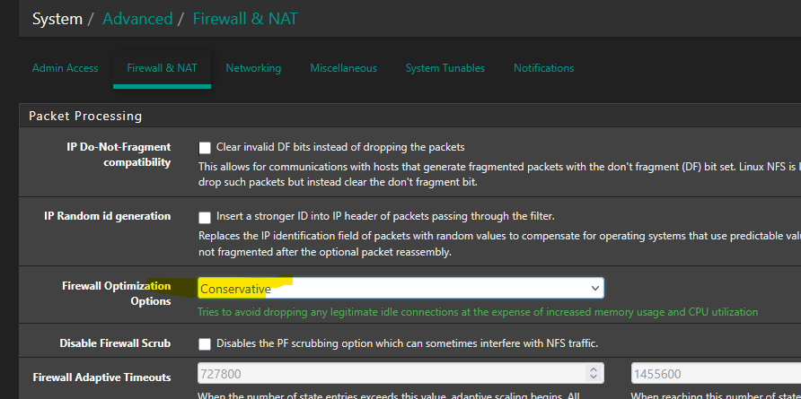

          Try setting it to conservative mode so the links don’t go down for the wan as often. Sometimes with the lag it drops the wan and the system can see it as offline. Try that

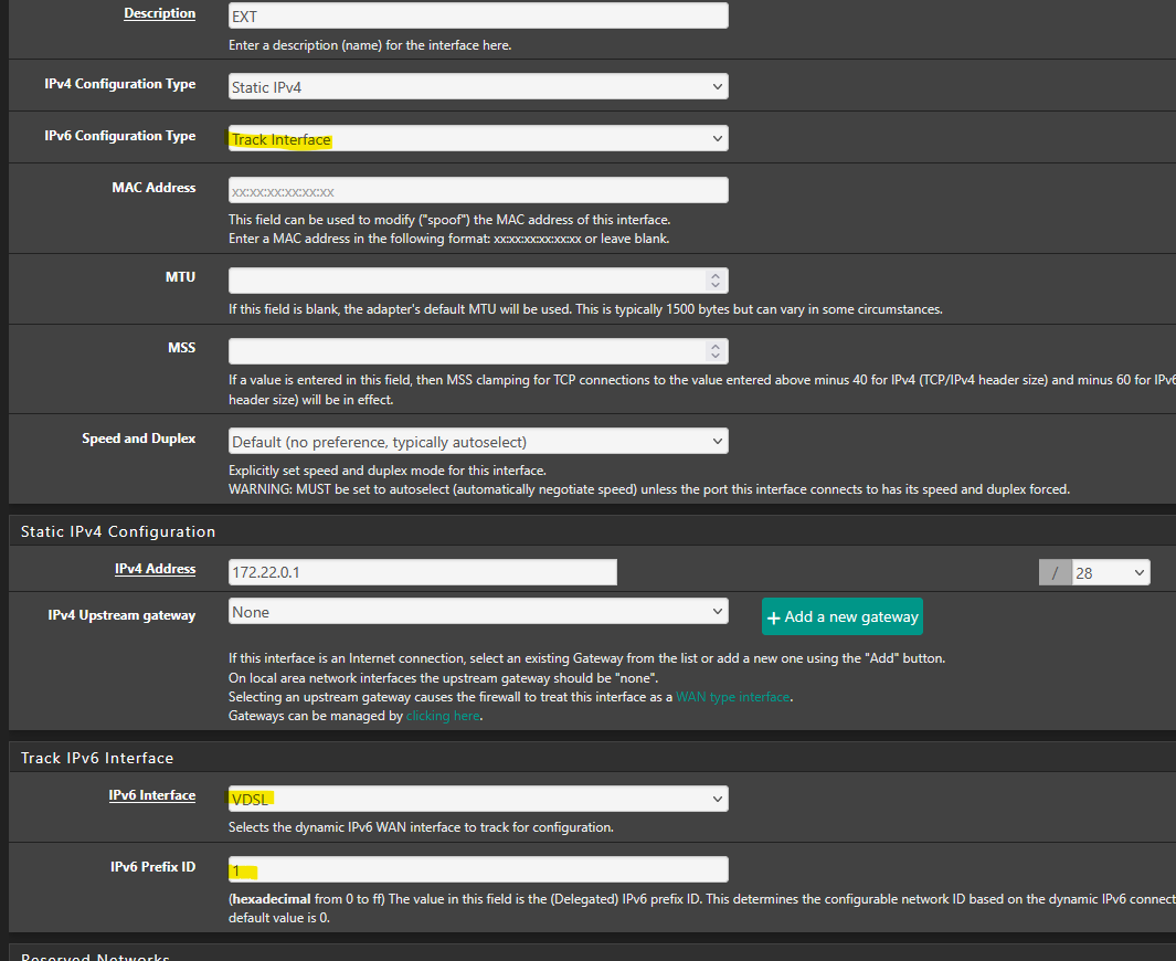

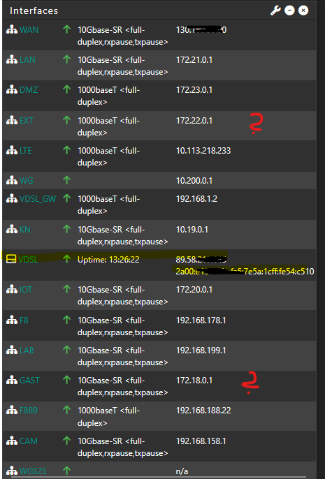

            heiko3001 @stephenw10

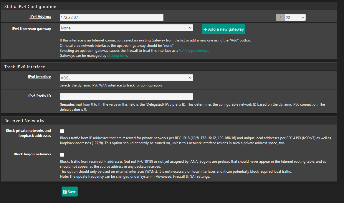

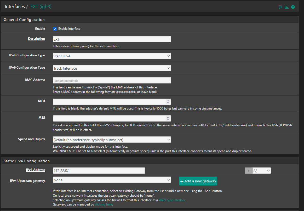

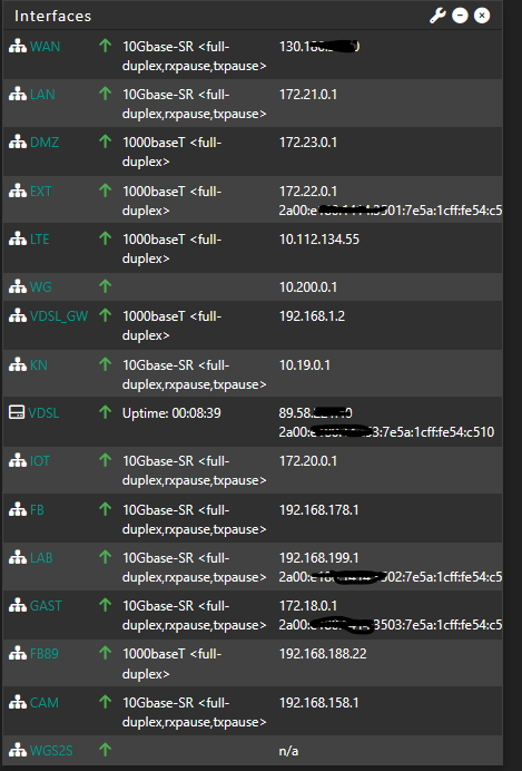

            Yes correct, the DSL WAN is pulling a correct and working lease (I can ping and resolve dns entries over the pfsense)
            I have some LAN interfaces, the are set to track the DSL-WAN, but they failed to be assigned prefix.
            0941d544-0f3c-4f67-99b9-912fa12b6707-grafik.png 2095d2dd-68da-4070-a204-d2f3369860a1-grafik.png

                @JonathanLee said in Dual WAN Setup - LAN interfaces lost their IPv6 adresses.:
                I will give it a try.

                  @heiko3001
                  This :
                  means that dhcp6c wanted to send it's periodic "Solicit" upstream, but the interface was pulled down.
                  Btw the device/modem at the other side ?
                  You have two wans, I can't see which one makes dhcp6c unhappy.

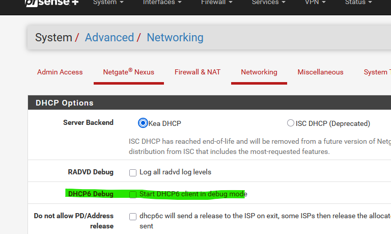

                  You want to know more ?
                  Ask pfSense : check :
                  and from now on you can see (DHCP logs) what dhcp6c does, what it obtained as an answer (prefix etc)
                  • H
                    heiko3001 @Gertjan
                    @Gertjan
                    From now I started the DHCP Debug mode...

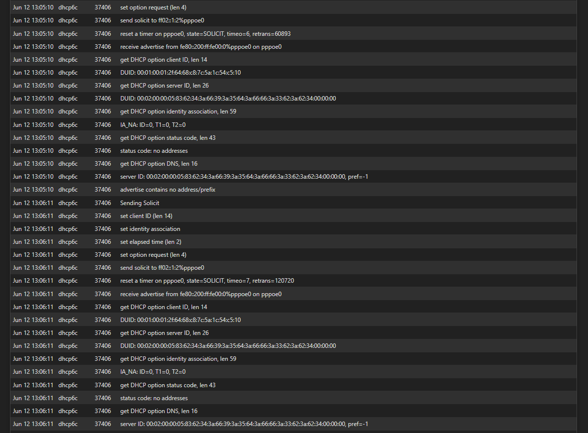

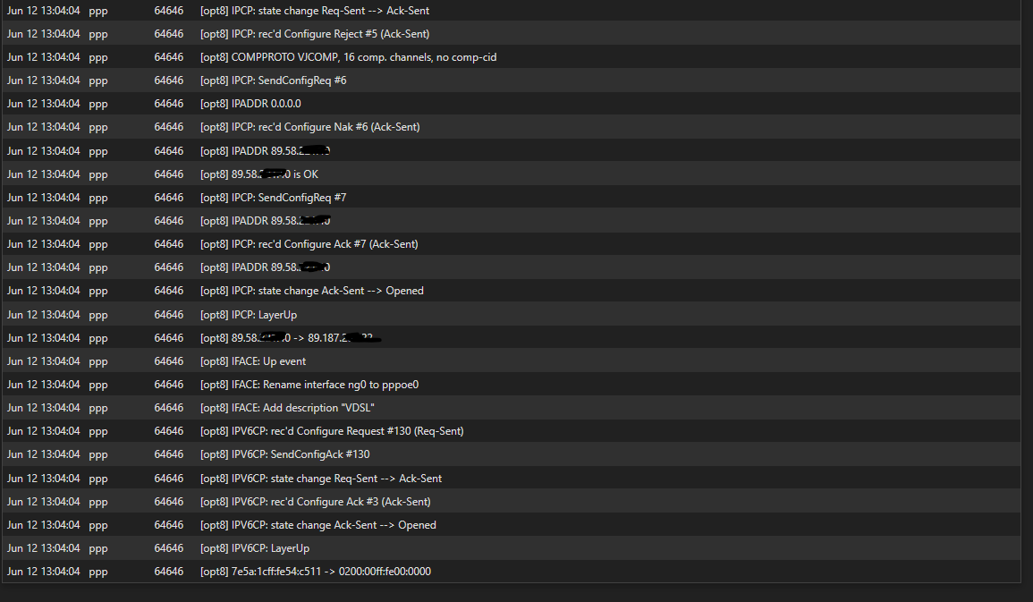

                            In the dhcp6c image I couldn't see any prefixes getting attributed ...
                            ![76b289c3-965e-4a5d-9537-95582ef58fca-image.png](Something went wrong while parsing server response)
                            You copied the wrong / non interesting part ?
                            ppp : IPv4 is ok
                            Interfaces : the 2a00:exxxxxxxx are ISP attributed, right ?

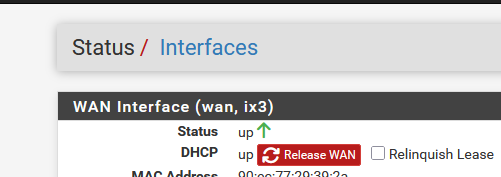

                            I released my WA. (both IPv4 and IPv6) with :
                            and waited 30 seconds or so.
                            Then I activated WAN again with the same button :
                            My 'dhcp6c' story :

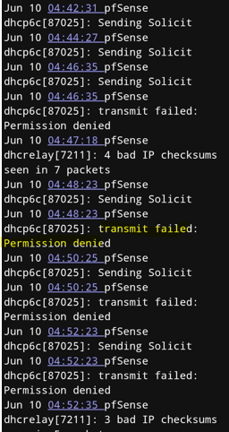

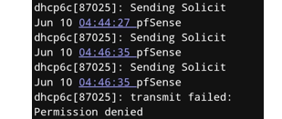

                                    Before it works I got this error message:
                                    After triggering (Interface Off, Interface On, Interface Off ....) I got this log, and everything looks good.

                                        I think you misunderstand me...
                                        I have to trigger that it works. I do this by turning the VDSL Interface off and on and again.
                                        After a clean restart IPv6 is not working and I get the error message above (Permission denied- transmit failed)
                                        Then I trigger the VDSL interface by turning it off and on, then it takes a few seconds and all LAN interface have a working IPv6 connection.

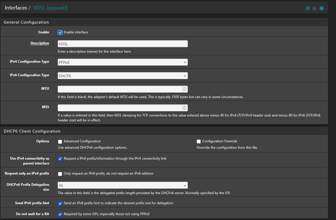

                                        • stephenw10S
                                          Do you see any Received RA messages in the main system log?
                                          If not do you have 'Do not wait for a RA' set in the dhcpv6 client setup?
                                          It sounds like you may need that.
                                          Also are you using if_pppoe in 2.8?
                                          • GertjanG
                                            Gertjan @heiko3001
                                            @heiko3001 said in Dual WAN Setup - LAN interfaces lost their IPv6 adresses.:
                                            That's what I understood.
                                            The dhcp6c gets started when the WAN interface becomes active.
                                            And then it fails with the message "Transmit failed - Permission denied" which means : the interface is down (again).
                                            Or, is this something else :
                                            at 04h42:31 a solicit is send - it does this very often, I see Solicit every 300 seconds or so.
                                            at 04h46:27 same thing, 116 seconds later,
                                            at 04h46:35 same thing, 8 seconds later .... wow...
                                            at 04h46:35 This solicit failed - interface gone.
                                            If you saved the WAN config at that moment - between 46:27 and 46:35 - then I presume the dhcp6c would log would show a lot more - like the logs you've showed above.
                                            Btw : Not sure if this is related - dhcprelay - are you using dhcprelay ?
