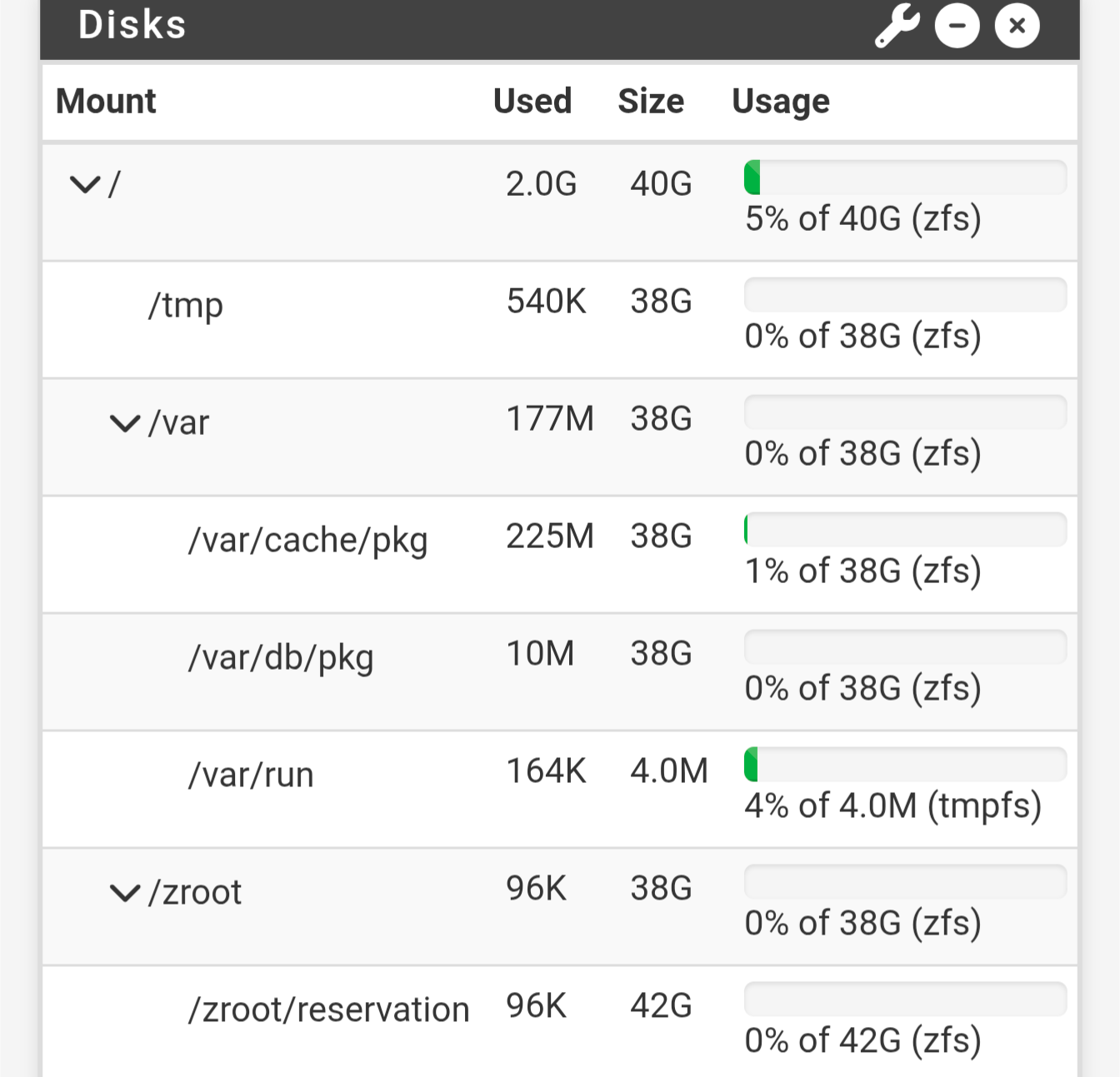

                    maverick_slo @stephenw10
                    pool: zroot
                     state: ONLINE
                    status: Some supported and requested features are not enabled on the pool.
                    	The pool can still be used, but some features are unavailable.
                    action: Enable all features using 'zpool upgrade'. Once this is done,
                    	the pool may no longer be accessible by software that does not support
                    	the features. See zpool-features(7) for details.
                    config:
                    	NAME        STATE     READ WRITE CKSUM
                    	zroot       ONLINE       0     0     0
                    	  da0p4     ONLINE       0     0     0
                    errors: No known data errors
                    NAME                                                                                 USED  AVAIL  REFER  MOUNTPOINT
                    zroot                                                                               8.40G  37.6G    96K  /zroot
                    zroot/ROOT                                                                          3.61G  37.6G    96K  none
                    zroot/ROOT/auto-default-20230818173559                                               392K  37.6G  2.00G  /
                    zroot/ROOT/auto-default-20230818173559/var_cache_pkg                                   8K  37.6G   217M  /var/cache/pkg
                    zroot/ROOT/auto-default-20230818173559/var_db_pkg                                     64K  37.6G  10.0M  /var/db/pkg
                    zroot/ROOT/auto-default-20230818173559_20250611064117                                704M  37.6G  2.00G  /
                    zroot/ROOT/auto-default-20230818173559_20250611064117/var_cache_pkg                  218M  37.6G   218M  /var/cache/pkg
                    zroot/ROOT/auto-default-20230818173559_20250611064117/var_db_pkg                    3.10M  37.6G  10.1M  /var/db/pkg
                    zroot/ROOT/auto-default-20230818173559_20250611064117_20250611195530                2.92G  37.6G  2.00G  /
                    zroot/ROOT/auto-default-20230818173559_20250611064117_20250611195530/var_cache_pkg   442M  37.6G   225M  /var/cache/pkg
                    zroot/ROOT/auto-default-20230818173559_20250611064117_20250611195530/var_db_pkg     15.3M  37.6G  10.0M  /var/db/pkg
                    zroot/reservation                                                                     96K  42.2G    96K  /zroot/reservation
                    zroot/tmp                                                                            560K  37.6G   560K  /tmp
                    zroot/var
                      Ah, I'm guessing that's an old install that has been upgraded for some time (years)?
                      That looks like the old ZFS layout we used when it was first introduced in the installer. That's why you're still hitting this issue.
                      Are you able to just reinstall? That's the easiest way to get to the new layout TBH.
