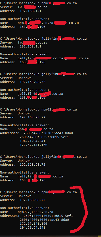

          I'm using this guide but there seem to be a lot that isn't explained so trying to understand what goes where etc https://docs.kois.cc/networking/pfsense/firewall/port-forward/ but below is what I'm getting if I do a nslookup from outside the network I can see the wan IP just doesn't resolve
          • Z Offline
            zari90 @johnpoz

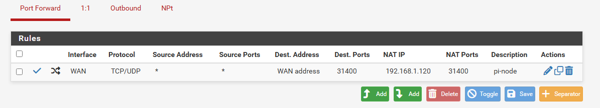

              zari90 @zari90

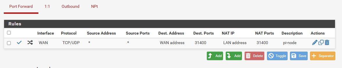

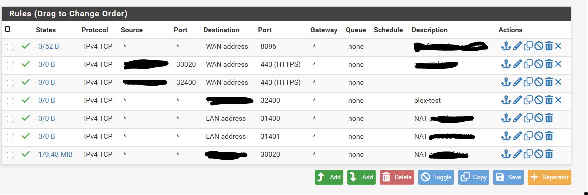

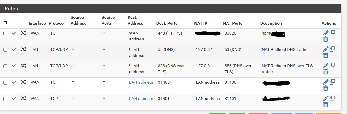

                Not sure what your trying to show with your nslookups - for starters, who is 192.168.98.72 - if that is dns running on pfsense, it should be able to resolve its own name.. If its some other nameserver - it should resolve its own name. That it doesn't shows something wrong with it.
                nslookup
                Server:  sg4860.home.arpa
                Address:  192.168.9.253
                not sure what interfaces your showing me for those rules.. And your port forwards - if you can redirect dot, your client your using for dot is not sane - because your not handing him a cert for where he is doing the dot query, and if can not validate your the dot server that I want to talk to - throws major portion of point of dot and doh, validating who your asking for dns.
                And those ports 31400 and 31401 - when would destination ever bee your lan subnets hitting your wan?? And if they were why would you forward them to pfsense lan interface???
                Not sure what rules those last ones are on - but none of them make much sense..

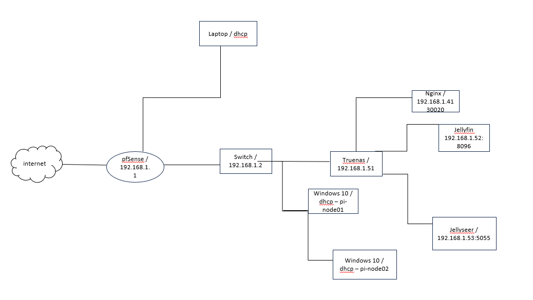

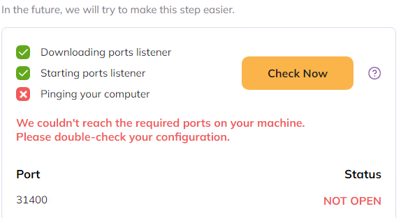

                        don't know much about pfSense correct what I know is dangerous and really need help hoping this diagram helps, the nodes are ports that I need open to pass network traffic through to the pi application sitting on windows 10 which is port 31400, 31401 etc, watched a lot of youtube but everything I watch doesn't really help
                          Gertjan @zari90
                          @zari90
                          Applying the "Keep It Simple" rules :
                          This :
                          can be replaced by a straight cable.
                          This :
                          your TrueNAS is a 4 port switch also ?
                          Here :
                          A windows PC with dual NIC ?
                          Z 1 Reply Last reply Reply Quote 1

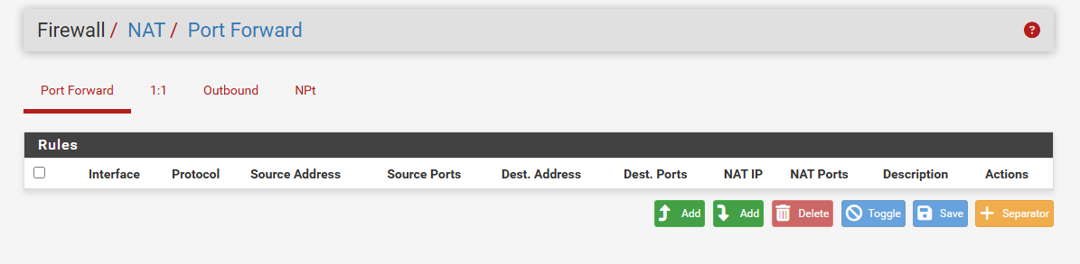

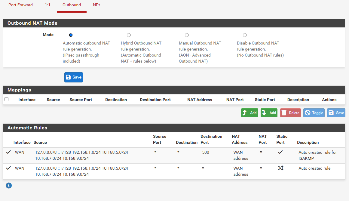

                                  @zari90 Your network diagram isn't that good. Anyways, you have only one LAN on pfSense? And please remove all of the NAT rules (port forwards) other than the first two.
                                  Show them again and NAT Outbound.
                                  Z 1 Reply Last reply Reply Quote 0
                                  • Z Offline
                                    zari90 @Bob.Dig
                                    @Bob-Dig

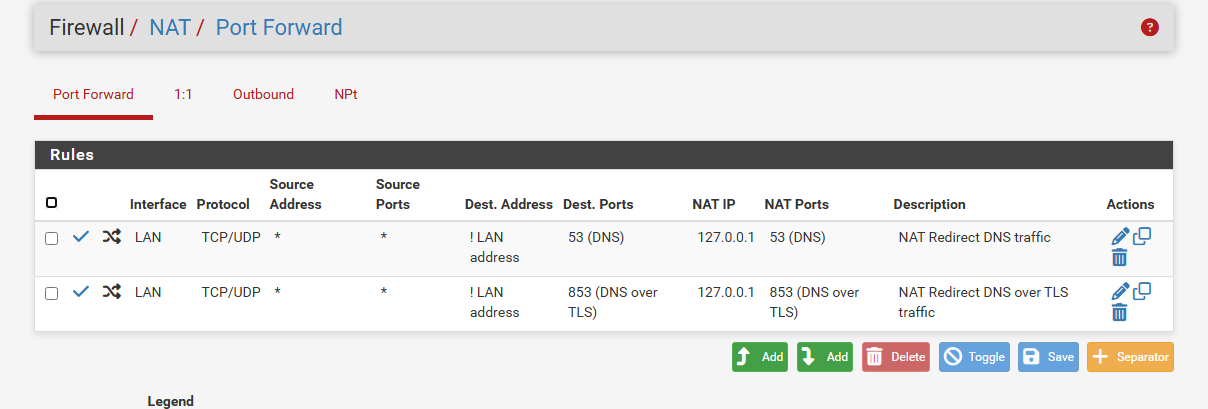

                                    Apologies for the poor diagram I have one LAN currently yes 5b815cc7-0fb2-4ed9-9f2a-34e41245325a-image.png a066c720-f550-497f-8661-4fb7f5031f81-image.png
                                    Bob.DigB 1 Reply Last reply Reply Quote 1

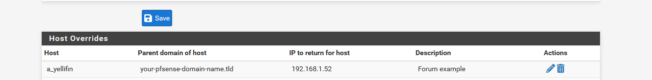

                                      The clean and better way to do things :
                                      Use the LAN IP.
                                      You want to use host names ? That's ok.

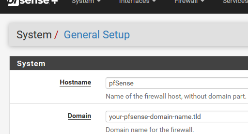

                                      Go here and note down the domain name - or ask the admin :
                                      With this knowledge, create a host override here :
                                      and from now on you can use
                                      a_yellifin.your-pfsense-domain-name.tld
                                      from everywhere on your local networks instead of the IPv4.

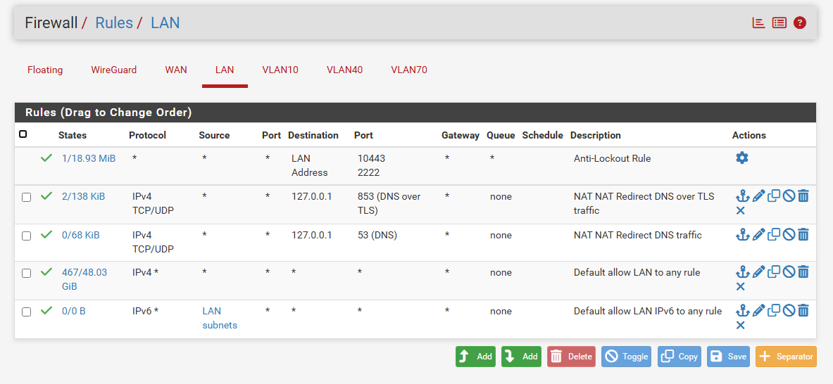

                                        @zari90 Good. You can't redirect DNS over TLS (DoT) so this can be removed too.

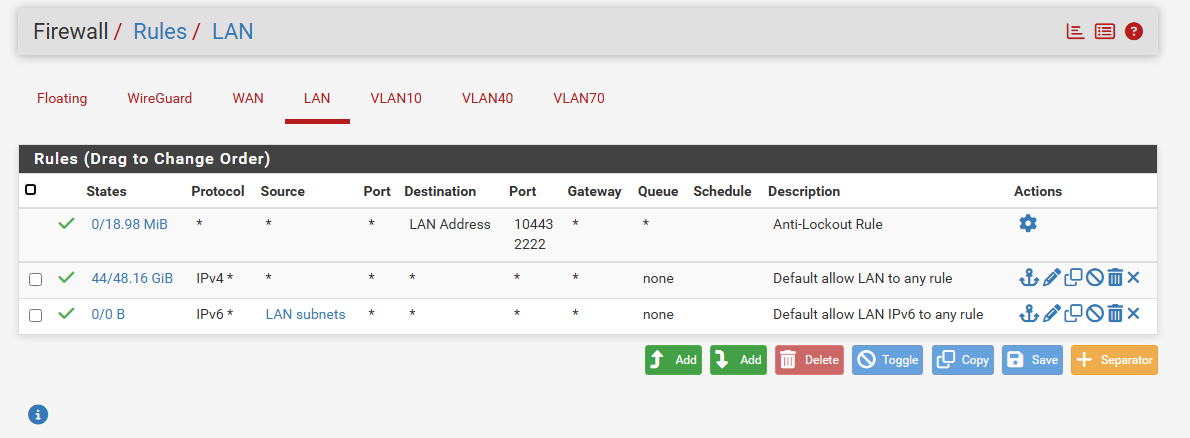

                                        You haven't showed your LAN rules right? It is probably a mess too. Reset the LAN rules to the two default allow any rules. And then we go step by step, you start with an easy task you decide and we will guide you. ;)
                                        Z 2 Replies Last reply Reply Quote 0

                                          • Z Offline
                                            zari90 @Bob.Dig
                                            @Bob-Dig
                                            This is the current LAN rules
