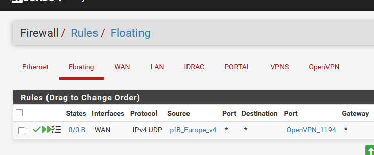

            It can place firewall rules for you - on selected interfaces, or as a Floating rule :
            Here is an example : what I use :
            My example works the other way around :
            This rule accepts (passs) all OpenVPN UDP traffic from any IP in Europe.
            ( and the rest of the planet gets blocked )
            This rule permits me to contact my pfSense OpenVPN server, as long as I stay in Europe.
            Normally, you could make the rules to 'log' so you can see what LAN device was hitting what IP on which list ... And if you know the name of the list you're close to a solution.

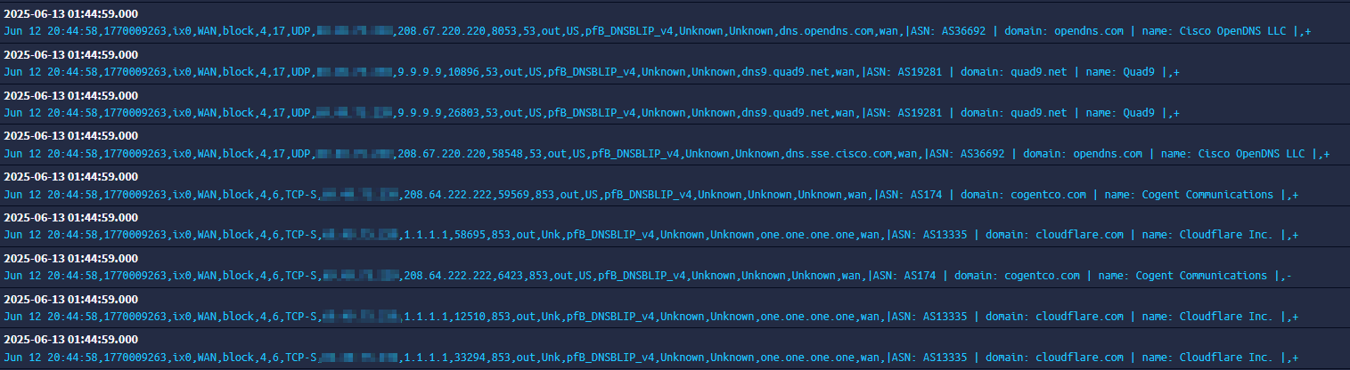

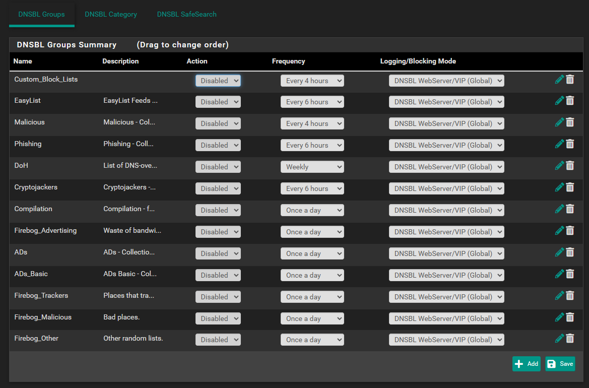

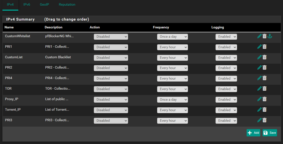

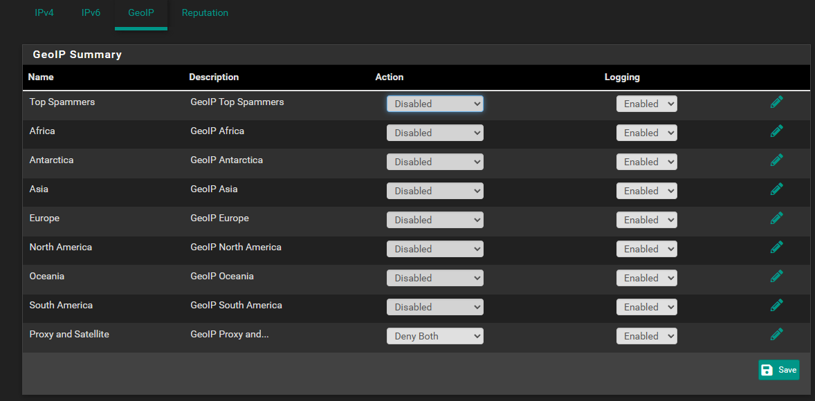

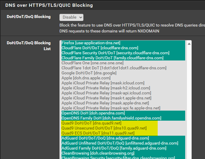

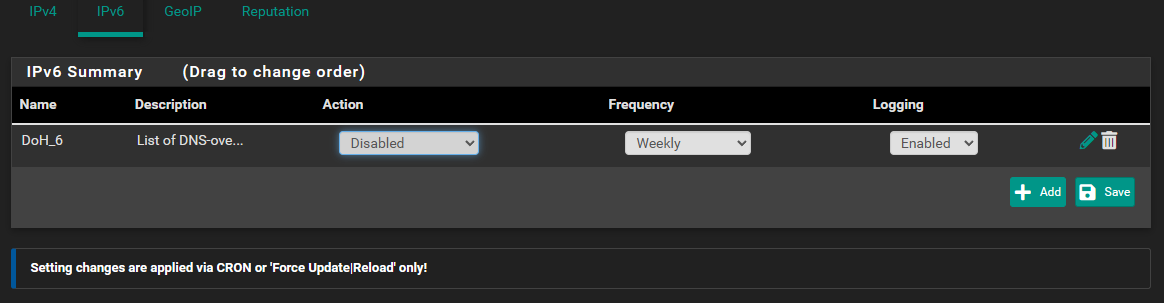

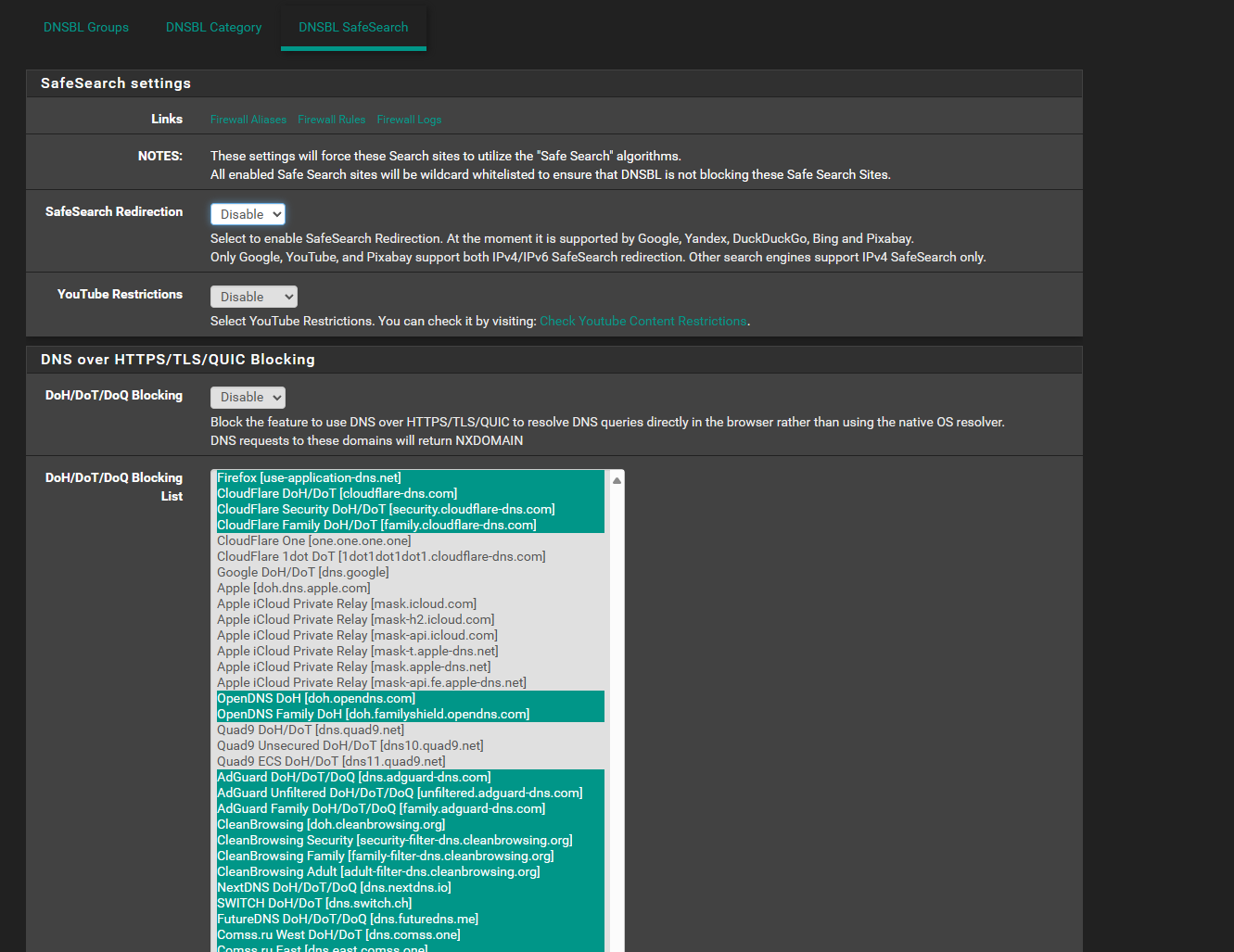

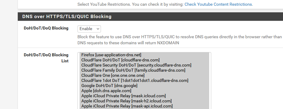

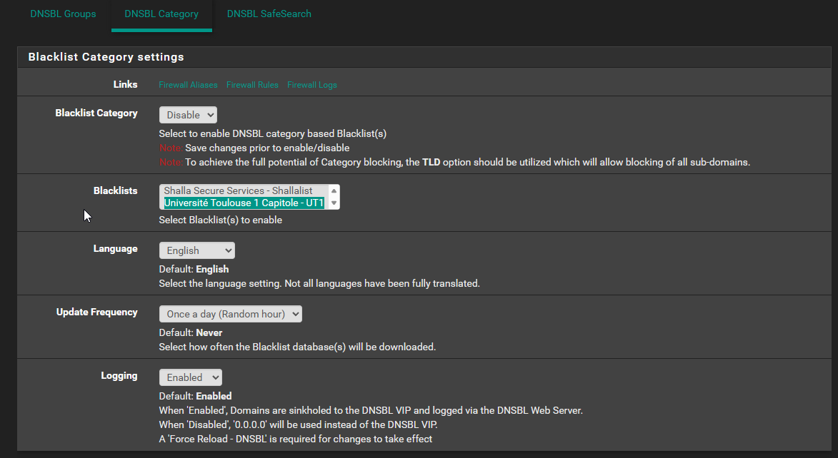

              So in the context of disabling lists and such, here's the DoH/DoT/DoQ status. Disabled or not it's still blocking Quad9, which I can't correlate that to the settings.
              I fully understand pfBlocker is about firewall rules for IP blocking and unbound hooks for DNS blocking, never disputed that.
              So with everything turned down, this is what I still see:
              As you can see from the logs, 9.9.9.9 is still being blocked even though it's not selected on the DoH/DoT/DoQ list, which is disabled anyway, and all my lists being disabled. So something has changed in the basic configuration of pfBlocker, or there's some other setting I'm missing.
              I understand your stance that by default pfBlocker does nothing, but that's not the behaviour I'm witnessing after toggling all the list controls off, so there's still something missing. Short of nuking pfBlocker and considering persona non-grata, not sure what else I can do.
              BTW, 30 years in IT both infrastructure and networking tells me there's no magic coincidence or just "oh well, something happened", everything has a reason behind it, I'm just not seeing that reason right now.

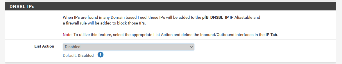

              • BBcan177B
                BBcan177 Moderator @jlw52761
                @jlw52761
                DNSBL_IP is a firewall aliastable that is created from a DNSBL tab option that collects any IPs found in any of the enabled DNSBL feeds and adds those to this aliastable. You could disable that option, or remove the feed that contains that IP, or from the Alerts/Reports tab, suppress or whitelist that IP.
                "Experience is something you don't get until just after you need it."

                  @jlw52761 said in pfBlockerng Stopped Packet Forwarding:
                  I understand your stance that by default pfBlocker does nothing, but that's not the behavior I'm witnessing
                  Go figure that @BBcan177 just proved me wrong.
                  He mentioned about this :
                  Knowing that DNSBL list can include IP addresses (and not only host names - this is understandable for DNS servers) and if that option is activated, every IP found will be add to a 'global' pf alias table called "pfB_DNSBL_IP".
                  This means that you had a "DNSBL IPs" activated (maybe just ones) and it started to include all found IPs, that included all DNS servers, as you would have had also used (ones ?) a list with all these DNS IP addresses ... the same ones you also use to forward to.
                  This table by itself does nothing (me presuming again) but if it is used in a firewall rule, even when pfBlockerng is de-activated or even removed completely, this rule still functions (?)
                  This rule is probably placed on the floating rules tab.
                  Disable this option, remove, if needed, this firewall rule, and your issue is gone.
