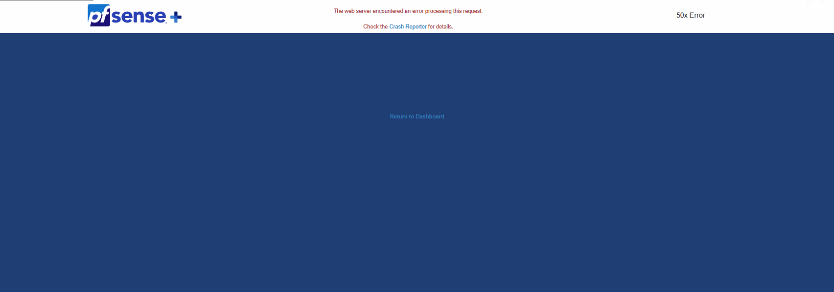

      Investigating further, I noticed that I could not login to firewall webui and got this screen.

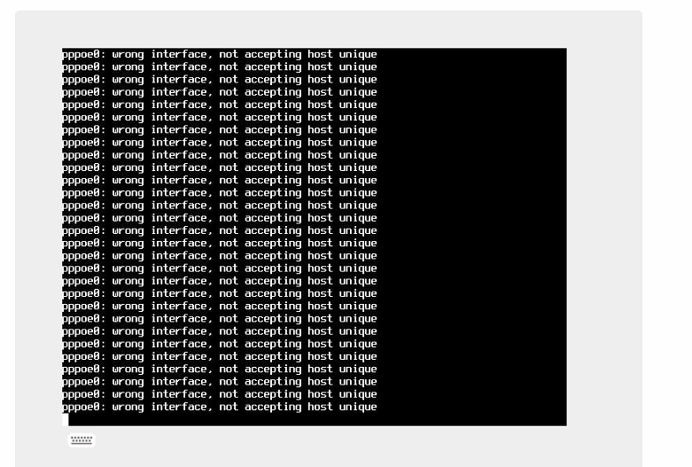

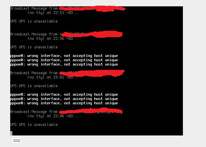

      Then I checked the system via IPMI and saw this

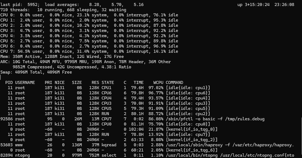

                                    same thing is happening again since my ISP is still working on the lines. I left it as is to troubleshoot which is kinda hard since I am remotely connecting via cellular. If you are interested to troubleshoot and get to the bottom of this, you can pm me with your discord? I have to bring this online and cannot keep it like this for a long time. Please, let me know.
                                    console output I see
                                    top -HaSP
                                    ps -auxwwd
                                    [25.03-BETA][root@<<>>]/root: ps -auxwwd
                                    USER     PID  %CPU %MEM     VSZ    RSS TT  STAT STARTED        TIME COMMAND
                                    root       0  58.9  0.0       0   2480  -  DLs  Tue08     498:25.09 [kernel]
                                    root      11 527.6  0.0       0    128  -  RNL  Tue08   37708:03.62 - [idle]
                                    root       2  22.0  0.0       0    128  -  WL   Tue08     287:39.83 - [clock]
                                    root       1   0.0  0.0   12376   1232  -  SLs  Tue08       0:01.18 - /sbin/init
                                    ntopng 82894  10.3  2.3 1002512 773128  -  Ss   19:55      23:24.75 |-- /usr/local/bin/ntopng /usr/local/etc/ntopng.conf
                                    root   78380   6.9  0.0   14692   3072  -  Ss   23:28       0:00.00 |-- /usr/local/bin/dpinger -S -r 0 -i IPSEC_S2S_VTI_VTIV4 -B 172.28.15.1 -p /var/run/dpinger_IPSEC_S2S_VTI_VTIV4~172.28.15.1~172.28.15.2.pid -u /var/run/dpinger_IPSEC_S2S_VTI_VTIV4~172.28.15.1~172.28.15.2.sock -d 1 -s 500 -l 2000 -t 60000 -A 1000 -D 500 -L 20 172.28.15.2
                                    root   73869   6.8  0.0   14692   3076  -  Ss   23:28       0:00.00 |-- /usr/local/bin/dpinger -S -r 0 -i VPNAC_WG -B 10.11.7.113 -p /var/run/dpinger_VPNAC_WG~10.11.7.113~10.11.0.1.pid -u /var/run/dpinger_VPNAC_WG~10.11.7.113~10.11.0.1.sock -C /etc/rc.gateway_alarm -d 1 -s 500 -l 2000 -t 60000 -A 1000 -D 500 -L 20 10.11.0.1
                                    root   75484   6.8  0.0   14692   3080  -  Ss   23:28       0:00.00 |-- /usr/local/bin/dpinger -S -r 0 -i MNG_DHCP -B 192.168.2.3 -p /var/run/dpinger_MNG_DHCP~192.168.2.3~192.168.2.1.pid -u /var/run/dpinger_MNG_DHCP~192.168.2.3~192.168.2.1.sock -C /etc/rc.gateway_alarm -d 1 -s 500 -l 2000 -t 60000 -A 1000 -D 500 -L 20 192.168.2.1
                                    root   70976   6.7  0.0   14692   3084  -  Ss   23:28       0:00.00 |-- /usr/local/bin/dpinger -S -r 0 -i WAN_PPPOE -B <<ip redacted>> -p /var/run/dpinger_WAN_PPPOE~<<ip redacted>>~10.98.238.224.pid -u /var/run/dpinger_WAN_PPPOE~<<ip redacted>>~10.98.238.224.sock -C /etc/rc.gateway_alarm -d 1 -s 500 -l 2000 -t 60000 -A 1000 -D 500 -L 20 10.98.238.224
                                    root   72461   6.7  0.0   14692   3084  -  Ss   23:28       0:00.00 |-- /usr/local/bin/dpinger -S -r 0 -i OVPN_S2S_VPNV4 -B 172.31.254.1 -p /var/run/dpinger_OVPN_S2S_VPNV4~172.31.254.1~172.31.254.2.pid -u /var/run/dpinger_OVPN_S2S_VPNV4~172.31.254.1~172.31.254.2.sock -C /etc/rc.gateway_alarm -d 1 -s 500 -l 3500 -t 60000 -A 3000 -D 2000 -L 60 172.31.254.2
                                    www    53603   5.5  0.1  139244  38444  -  Rs   23:25       0:13.90 |-- /usr/local/sbin/haproxy -f /var/etc/haproxy/haproxy.cfg -p /var/run/haproxy.pid -D -x /tmp/haproxy.socket -st 46347
                                    root   50665   1.0  0.0   13988   2604  -  Ss   23:28       0:00.00 |-- /usr/local/sbin/dhcpleases -l /var/dhcpd/var/db/dhcpd.leases -d domain.org -p /var/run/unbound.pid -u /var/unbound/dhcpleases_entries.conf -h /etc/hosts
                                    root   35734   0.3  0.0   13980   2396  -  SNC  23:28       0:00.00 |-- sleep 60
                                    dhcpd    337   0.0  0.0   28564  15492  -  Ss   23:27       0:00.02 |-- /usr/local/sbin/dhcpd -user dhcpd -group _dhcp -chroot /var/dhcpd -cf /etc/dhcpd.conf -pf /var/run/dhcpd.pid lagg0 lagg0.25 lagg0.88 lagg0.200 lagg0.105 lagg0.33 lagg0.135 bridge0 lagg0.45 lagg0.40 lagg0.30 lagg0.55 lagg0.150 lagg0.95
                                    root     591   0.0  0.1  112460  33192  -  Ss   Tue08       0:05.59 |-- php-fpm: master process (/usr/local/lib/php-fpm.conf) (php-fpm)
                                    root   76974   1.5  0.2  123852  60440  -  S    17:07       0:33.73 | |-- php-fpm: pool nginx (php-fpm)
                                    root   79050   1.1  0.2  123852  62756  -  S    16:51       0:44.38 | |-- php-fpm: pool nginx (php-fpm)
                                    root   12418   0.3  0.2  125900  62416  -  S    19:19       0:53.11 | |-- php-fpm: pool nginx (php-fpm)
                                    root   92272   0.2  0.2  121740  55568  -  S    20:04       0:01.17 | |-- php-fpm: pool nginx (php-fpm)
                                    root    9368   0.1  0.2  123788  60220  -  S    19:44       0:05.10 | |-- php-fpm: pool nginx (php-fpm)
                                    root   36889   0.0  0.2  121804  59252  -  I    16:46       0:52.99 | |-- php-fpm: pool nginx (php-fpm)
                                    root   58688   0.0  0.2  123788  61944  -  I    19:38       0:05.65 | |-- php-fpm: pool nginx (php-fpm)
                                    root   90499   0.0  0.2  125900  62592  -  S    17:40       0:28.68 | `-- php-fpm: pool nginx (php-fpm)
                                    root     636   0.0  0.0   14552   3268  -  SNs  Tue08       0:02.16 |-- /usr/local/sbin/check_reload_status
                                    root     638   0.0  0.0   14552   2968  -  IN   Tue08       0:00.00 | `-- check_reload_status: Monitoring daemon of check_reload_status (check_reload_status)
                                    dhcpd   1456   0.0  0.0   25620  11992  -  Ss   23:27       0:00.56 |-- /usr/local/sbin/dhcpd -6 -user dhcpd -group _dhcp -chroot /var/dhcpd -cf /etc/dhcpdv6.conf -pf /var/run/dhcpdv6.pid lagg0 lagg0.135 lagg0.30 lagg0.40 lagg0.45 lagg0.55
                                    root    2077   0.0  0.0   13984   2392  -  Ss   23:27       0:00.00 |-- /usr/local/sbin/dhcpleases6 -c /usr/local/bin/php-cgi -f /usr/local/sbin/prefixes.php -l /var/dhcpd/var/db/dhcpd6.leases
                                    root    2926   0.0  0.0   13980   2476  -  Is   Tue08       0:00.00 |-- /usr/local/bin/minicron 60 /var/run/cp_prunedb_guest.pid /etc/rc.prunecaptiveportal guest
                                    root    3149   0.0  0.0   13980   2496  -  S    Tue08       0:00.25 | `-- minicron: helper /etc/rc.prunecaptiveportal guest (minicron)
                                    root    2965   0.0  0.2  118484  55504  -  I    23:27       0:00.33 |-- /usr/local/bin/php-cgi -q /usr/local/bin/notify_monitor.php
                                    root    6380   0.0  0.0   15672   5116  -  Ss   Tue08       0:03.24 |-- /sbin/devd -q -f /etc/pfSense-devd.conf
                                    root   11221   0.0  0.0   23960  10588  -  Is   Tue08       0:00.00 |-- sshd: /usr/sbin/sshd [listener] 0 of 10-100 startups (sshd)
                                    root   15803   0.0  0.0   24116  11904  -  Ss   23:25       0:01.77 | `-- sshd: root@pts/0 (sshd)
                                    root   16114   0.0  0.0   14644   3580  0  Is   23:25       0:00.01 |   `-- -sh (sh)
                                    root   16649   0.0  0.0   14644   3352  0  I    23:25       0:00.00 |     `-- /bin/sh /etc/rc.initial
                                    root   25429   0.0  0.0   14980   4544  0  S    23:25       0:00.02 |       `-- /bin/tcsh
                                    root   86753   0.0  0.0   14712   3572  0  R+   23:28       0:00.00 |         `-- ps -auxwwd
                                    root   17632   0.0  0.0   21404  10496  -  Ss   19:55       0:01.47 |-- /usr/local/libexec/nut/snmp-ups -a UPS
                                    root   21176   0.0  0.0   32960  10744  -  Is   Wed03       0:00.00 |-- nginx: master process /usr/local/sbin/nginx -c /var/etc/nginx-webConfigurator.conf (nginx)
                                    root   21458   0.0  0.0   35520  13212  -  I    Wed03       0:01.91 | |-- nginx: worker process (nginx)
                                    root   21500   0.0  0.0   35520  13804  -  I    Wed03       0:04.82 | `-- nginx: worker process (nginx)
                                    root   22186   0.0  0.0   32960  10652  -  Is   Wed03       0:00.00 |-- nginx: master process /usr/local/sbin/nginx -c /var/etc/nginx-guest-CaptivePortal.conf (nginx)
                                    root   22521   0.0  0.0   32960  11220  -  I    Wed03       0:00.00 | |-- nginx: worker process (nginx)
                                    root   22624   0.0  0.0   32960  11220  -  I    Wed03       0:00.00 | |-- nginx: worker process (nginx)
                                    root   22911   0.0  0.0   32960  11220  -  I    Wed03       0:00.00 | |-- nginx: worker process (nginx)
                                    root   23076   0.0  0.0   32960  11220  -  I    Wed03       0:00.00 | |-- nginx: worker process (nginx)
                                    root   23281   0.0  0.0   32960  11220  -  I    Wed03       0:00.00 | |-- nginx: worker process (nginx)
                                    root   23562   0.0  0.0   32960  11220  -  I    Wed03       0:00.00 | `-- nginx: worker process (nginx)
                                    root   22617   0.0  0.0   37708  13040  -  Ss   19:55       0:04.41 |-- redis-server: /usr/local/bin/redis-server 127.0.0.1:6379 (redis-server)
                                    root   23838   0.0  0.2  108592  66952  -  Is   19:55       0:00.06 |-- /usr/local/sbin/radiusd
                                    root   23873   0.0  0.0   43200  10816  -  Is   Wed03       0:00.00 |-- nginx: master process /usr/local/sbin/nginx -c /var/etc/nginx-guest-CaptivePortal-SSL.conf (nginx)
                                    root   24020   0.0  0.0   43200  11380  -  I    Wed03       0:00.00 | |-- nginx: worker process (nginx)
                                    root   24031   0.0  0.0   43200  11380  -  I    Wed03       0:00.00 | |-- nginx: worker process (nginx)
                                    root   24229   0.0  0.0   43200  11380  -  I    Wed03       0:00.00 | |-- nginx: worker process (nginx)
                                    root   24322   0.0  0.0   43200  11380  -  I    Wed03       0:00.00 | |-- nginx: worker process (nginx)
                                    root   24624   0.0  0.0   43200  11380  -  I    Wed03       0:00.00 | |-- nginx: worker process (nginx)
                                    root   24734   0.0  0.0   43200  11380  -  I    Wed03       0:00.00 | `-- nginx: worker process (nginx)
                                    root   24110   0.0  0.0   14068   2820  -  Ss   Tue08       1:13.35 |-- /usr/local/sbin/radvd -p /var/run/radvd.pid -C /var/etc/radvd.conf -m syslog
                                    root   24458   0.0  0.0   14404   2976  -  Is   Tue08       0:00.00 |-- dhclient: system.syslog (dhclient)
                                    root   26929   0.0  0.0   19640   7792  -  Is   19:55       0:00.00 |-- /usr/local/sbin/upsmon
                                    root   27267   0.0  0.0   19776   8252  -  S    19:55       0:07.61 | `-- /usr/local/sbin/upsmon
                                    root   27908   0.0  0.0   14236   2916  -  SC   19:55       0:00.96 |-- /usr/bin/tail_pfb -n0 -F /var/log/filter.log
                                    root   27989   0.0  0.2  129220  75424  -  S    19:55       0:21.29 |-- /usr/local/bin/php_pfb -f /usr/local/pkg/pfblockerng/pfblockerng.inc filterlog
                                    root   28570   0.0  0.0   14236   2756  -  S    19:55       0:00.74 |-- tail_pfb: system.fileargs (tail_pfb)
                                    root   28910   0.0  0.0   21392  10276  -  S    19:55       1:59.67 |-- /usr/local/sbin/lighttpd_pfb -f /var/unbound/pfb_dnsbl_lighty.conf
                                    root   29866   0.0  0.0   23496   4044  -  S    Tue08       1:26.75 |-- /usr/local/sbin/pcscd
                                    root   32057   0.0  0.0   13980   2484  -  Is   Tue08       0:00.00 |-- /usr/local/bin/minicron 240 /var/run/ping_hosts.pid /usr/local/bin/ping_hosts.sh
                                    root   32129   0.0  0.0   13980   2504  -  I    Tue08       0:00.06 | `-- minicron: helper /usr/local/bin/ping_hosts.sh  (minicron)

                                    The only thing I did in the console
                                    CTRL+C
                                    top -HaSP
                                    ps -auxwwd

                                      Hmm, nothing obviously a problem individually. But there's a lot going on there. There is so much happening that it's still restarting services minutes after the issue is cleared.
                                      I think I would at least try disabling the gateway monitoring action on anything that doesn't need it. Most of those tunnels and VPNs likely don't need it for example. Currently each of them is triggering a restart of all services.

                                        so basically, due to frequent connection losses and restores, it creates a race condition when services are getting restarted?
                                          Potentially.
                                          Try doing one manual reconnect and see what is logged until it's stable again. How long does it spend reloading stuff.
                                          LaxarusL 1 Reply Last reply Reply Quote 0
                                          • LaxarusL Offline
                                            Laxarus @stephenw10
                                            @stephenw10 I cannot reliably do this test right now. It is losing connection almost every 20 seconds. Did the new version got tested for such extreme cases?
