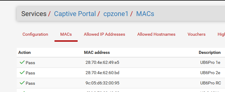

        You mean : it's MAC listed here :
        but the user (= device) still gets blocked ?

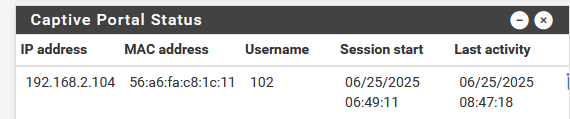

            So, if you have a logged in user :
            then this should produce some info :
            [25.03-BETA][root@pfSense.bhf.tld]/root: pfctl -a cpzoneid_2_auth/192.168.2.104_32 -se
            ether pass in quick proto 0x0800 from 56:a6:fa:c8:1c:11 l3 from 192.168.2.104 to any tag cpzoneid_2_auth dnpipe 2022
            ether pass out quick proto 0x0800 to 56:a6:fa:c8:1c:11 l3 from any to 192.168.2.104 tag cpzoneid_2_auth dnpipe 2023

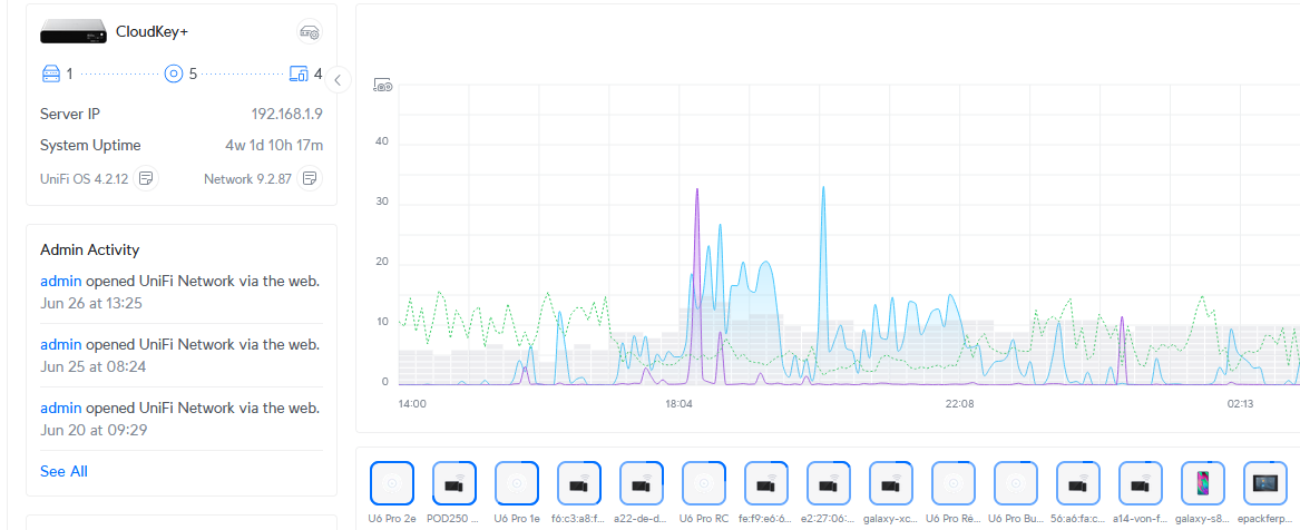

                I've 5 devices MAC listed : my 5 Unifi APs which are part of the captive portal.
                The communicate with a Cliud key gen unfi box, present on my LAN, and this gen gen box generates constantly stats like :
                and it doesn't miss one beat .... for nearly a year now.
                Not sure if the cloud key gen contacts the APs, or if its the other way around. I know they sync up every xx seconds and that loads of 'analytic' traffic is send :

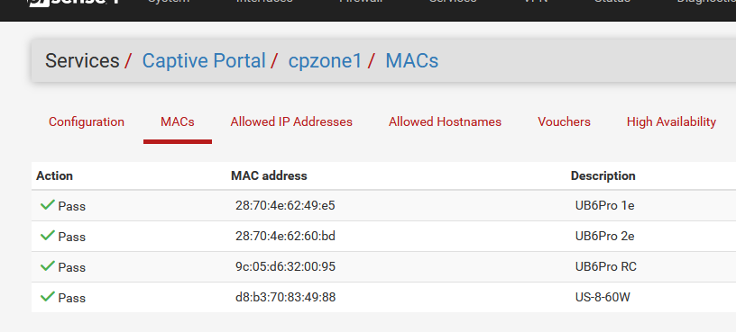

                    That said, all my AP equipment uses the MAC list like this :

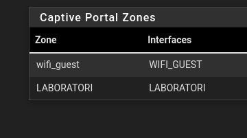

                      Yes I use two portal instances:
                      The first one for guest users (MAC white list and vouchers)
                      The second one use MAC white list and LDAP auth,
                      Indeed, there have only been reports of problems on the first one and not on the second one (in relation to the MAC white list) but it could be that users use the former much more while the latter is little used except with authentication by LDAP working properly.
