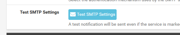

            When the WAN2 is down, what happens, see also System log, when you press this button :
            • E Offline
              EyeTap @Gertjan
              @Gertjan
              I tested by switching off the Provider Gateway / Modem for WAN2 - sending a testmessage works flawlessly in this state.

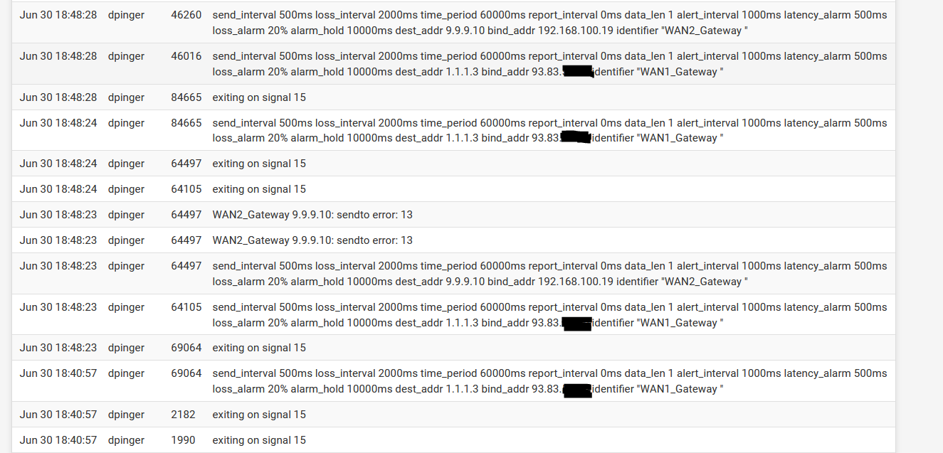

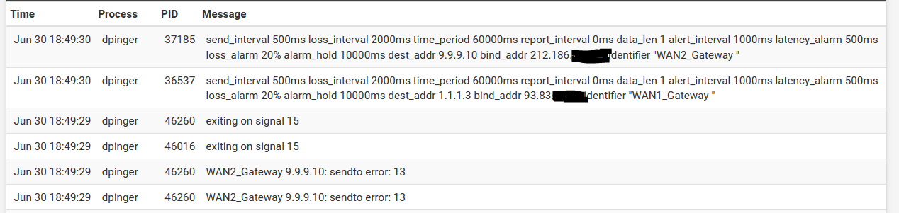

              Here the log contents when the Gateway went down:
              Here the log contents when the Gateway went down (not sure what those "sendto errors:13 mean though. Those show up between both parts quite some times.):

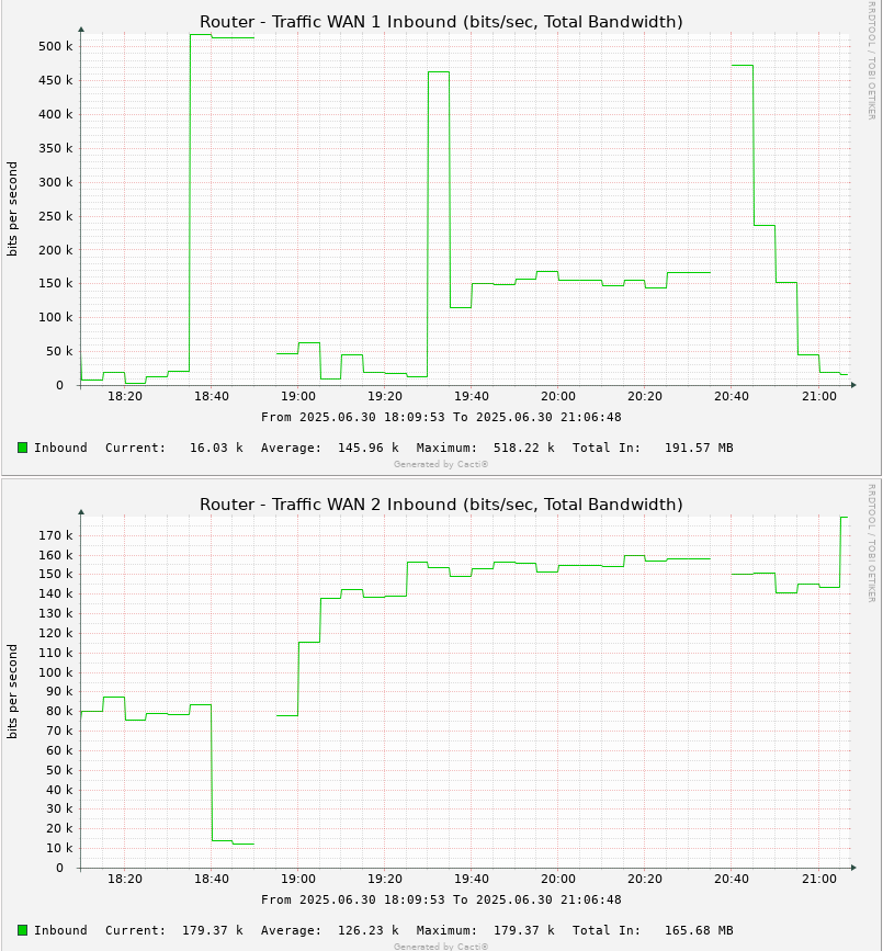

                Just noticed something strange - if WAN2 recovers this impacts WAN1 connections.
                I can even see this in the monitoring charts of the WAN1/2 IF traffic.
                (I would assume due some counter reset the data is skipped as the values would run backwards)
                Not really what I would expect of a backup line though.. but maybe I should reread the release notes of 2.8. again.. I got something in the back of my mind that something had been mentioned around flushing states on Gateway recovery...

                  These "sendto error 13" are puzzling.
                  It's FreeBSD so this, afaik, applies.
                  13 EACCES Permission denied. An attempt was made to access a file in a
                  way forbidden by its file access permission
                  A permission error ?
                  Something is 'not good' about the gateways ... Can't say more.

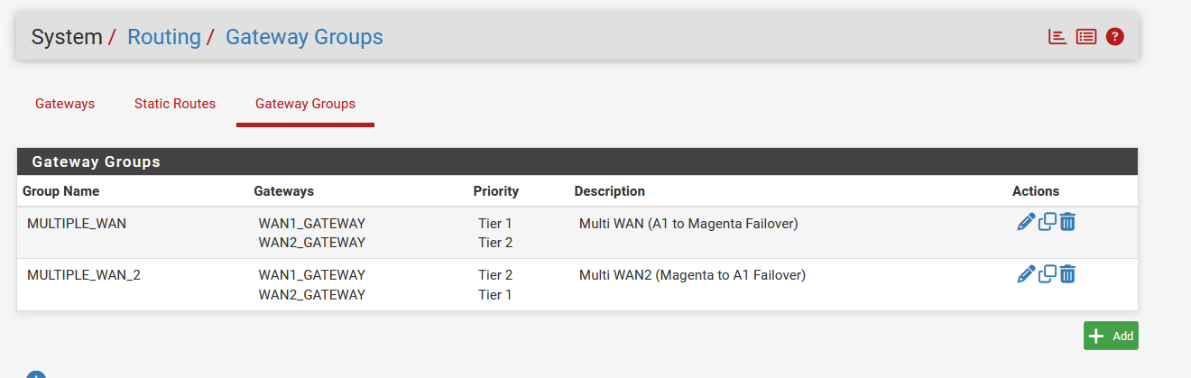

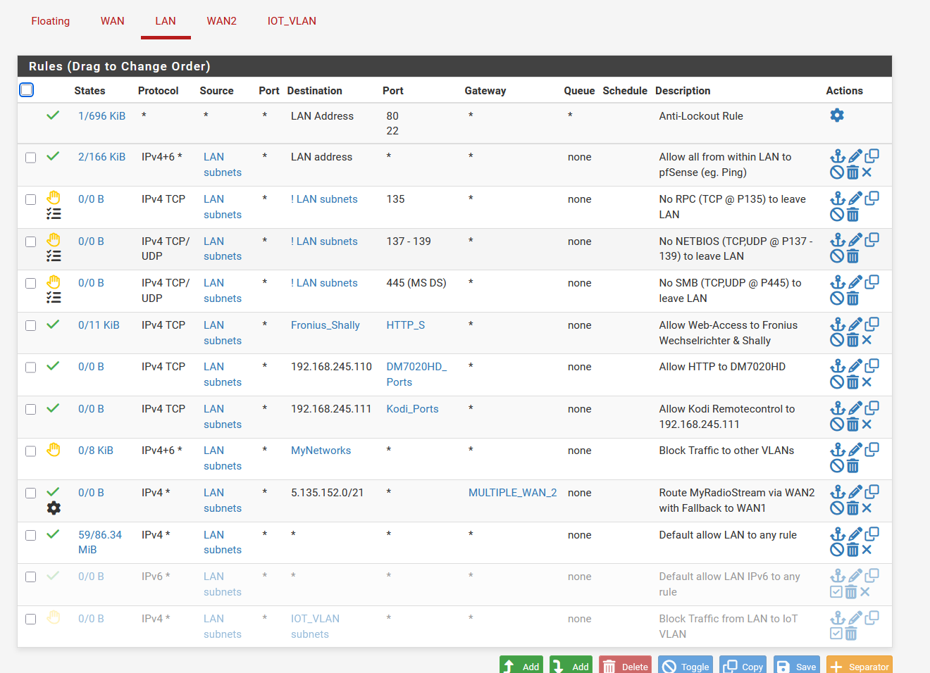

                              Here my rules:

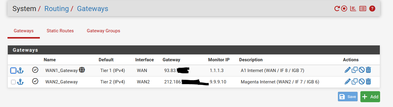

                              The Gateways:
                              Last but not least the Gateway groups:

                                What is your default gateway set to?

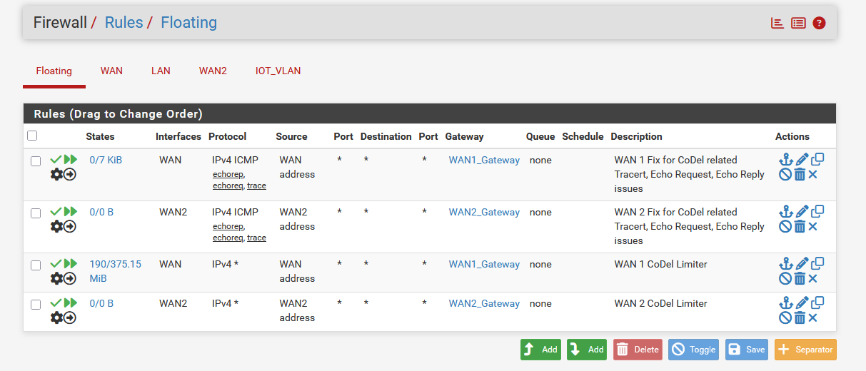

                                Do you have any floating outbound rules? That's what could cause a problem for SMTP connections from the firewall itself.

                                  I implemented the CoDel Limiter for both WAN lines and the fixes for Tracert and so:

                                      Hmm, and you never saw any blocked outbound traffic with those sendto error 13 logs?
                                      I'd guess it's somehow reusing an open state on a different WAN and that fails to match the states are bound. But I can't see how that could happen.
                                      You could try setting those CoDel rules individually as floating (in the advanced options) whilst keeping the global option as interface bound as a test. That would prove it if the issue is there.
                                      E 2 Replies Last reply Reply Quote 0

                                          OK, I found time to give that a try - I set the "State Policy" from within the rules configuration for all floating rules to "Floating States" and subsequently set the "Firewall State Policy" back again to "Interface Bound States".

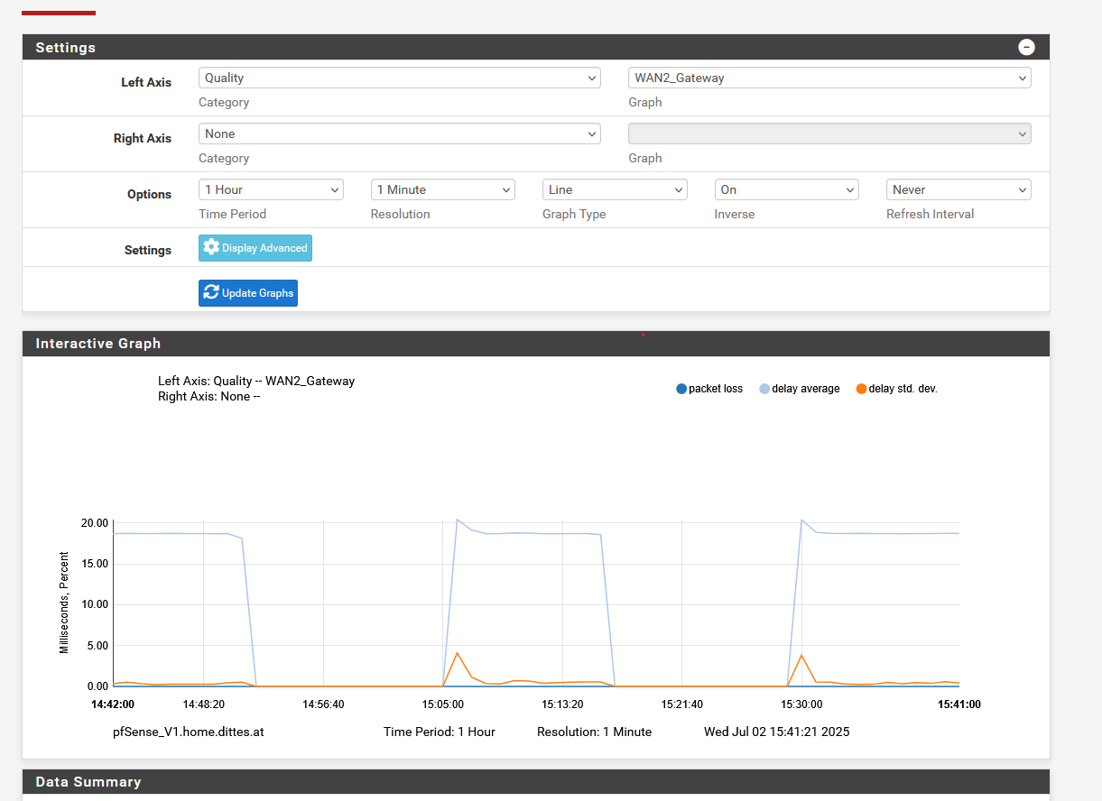

                                          When I simulated an outage of WAN2 again (switching off the Providers Modem (CPE?)) I received the mail once the pfSense listed thes Status of WAN2 as "Offline".
                                          When WAN2 Status came "Online" again I also received the respective mail.
                                          Strange though, that at perfectly the same time, with the same mail I was told that WAN1 would have packet loss and is ommitted from the routing group. Nevertheless this is not reflected at the Quality Monitoring, neither would I have noticed any outage....
                                          Notifications in this message: 1
                                          15:05:09 MONITOR: WAN2_Gateway has packet loss, omitting from routing group MULTIPLE_WAN 9.9.9.10|192.168.100.19|WAN2_Gateway|0ms|0ms|100%|down|highloss
                                          Notifications in this message: 2
                                          15:06:10 MONITOR: WAN1_Gateway has packet loss, omitting from routing group MULTIPLE_WAN 1.1.1.3|93.83.uv.xy|WAN1_Gateway|7.788ms|0ms|50%|down|highloss
                                          15:06:10 MONITOR: WAN2_Gateway is available now, adding to routing group MULTIPLE_WAN 9.9.9.10|212.186.ab.cd|WAN2_Gateway|25.869ms|4.865ms|0.0%|online|none

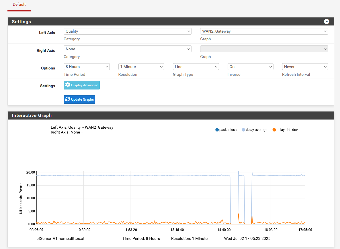

                                          Giving this another try (switching off the CPE for WAN2 and on after a couple of minutes) I didn't get any notification for WAN1 (as expected)
                                          15:29:01 MONITOR: WAN2_Gateway has packet loss, omitting from routing group MULTIPLE_WAN 9.9.9.10|192.168.100.19|WAN2_Gateway|0ms|0ms|100%|down|highloss
                                          15:30:01 MONITOR: WAN2_Gateway is available now, adding to routing group MULTIPLE_WAN 9.9.9.10|212.186.ab.cd|WAN2_Gateway|25.295ms|4.465ms|0.0%|online|none
                                          Here the respective quality charts for WAN 1 and WAN 2:
                                          WAN 2 more details:
