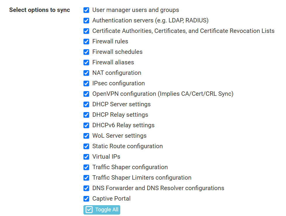

          Hey,
          I have selected all the available options in HA Settings.

            My doubt wasn't your sync settings, but how did you configure the IP alias? Is it hooked up on the CARP VIP??
            Normal interface IPs might not be synced to the secondary, since they cannot be used on it.
