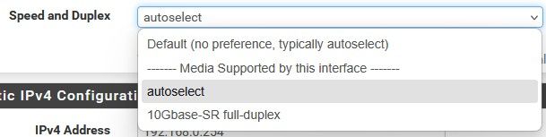

                  Finally, on Interfaces > LAN (bxe1, for example), is only showing me 10Gbps under "Speed and Duplex", when I have it fully configured on NVRAM as 1, 2.5 and 10Gbps options, or 35=70 and 36=70 (by using ediag -b10eng).
                  Thanks.
                    The speeds shown can often not accurately reflect the link speed for unusual modules. I've never tested that NIC though.
                    Is it actually linked and passing traffic though?
                    Did it previously show the correct speeds with a custom module?

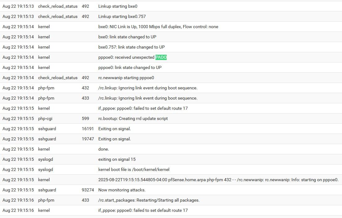

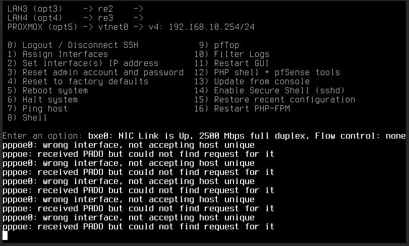

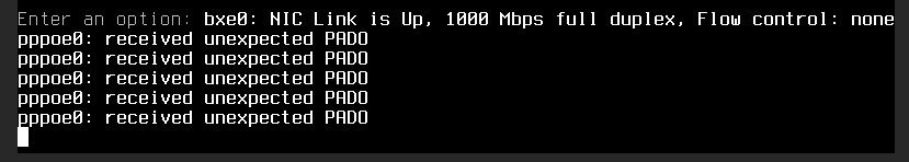

                          Then I configured the NIC back to 1Gbps, while the ODI was in 2.5Gbps mode, I got this error:
                          It "wake up" few seconds after.
                          I went back to 1Gbps, because it has an upload bug while in 2.5Gbps mode (it gets slow), something from ODI, not the NIC driver.

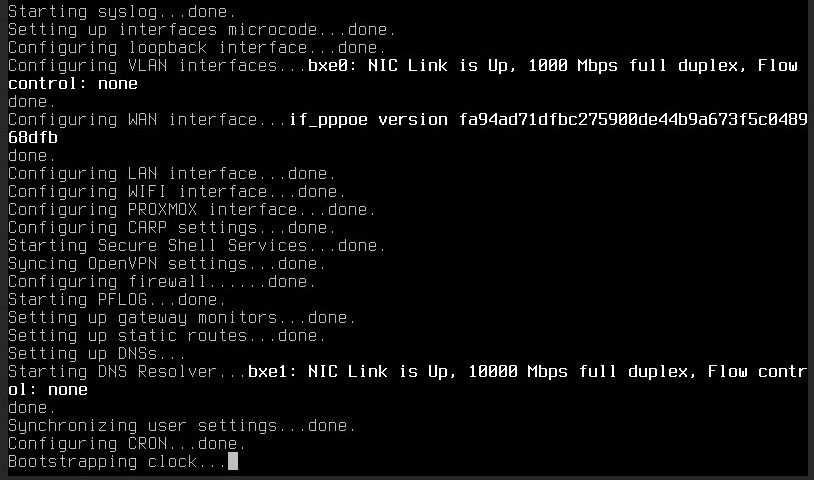

                            stephenw10 Netgate Administrator @Gradius
                            @Gradius said in Unable to use BCM57810 properly, need new drivers:
                            It works, however, you need to unplug and the plug in again (power ON/OFF the SFP).
                            Like if you reboot pfSense you need to reconnect the module? Full power cycle?
                            • G Offline
                              Gradius @stephenw10
                              @stephenw10 said in Unable to use BCM57810 properly, need new drivers:
                              No, I just need to plug out the SFP module, and then plug in, so power on & off just the module, then it works.
                              I just confirmed now, if the NIC is at 1Gbps (NVRAM), I don't need to do that, it only happens at 2.5Gbps.
                              And right after (that picture), I got 1 warning:
                              pppoe0: received unexpected PADO

                                      Hmm, I'm confused then. What is it that prompts you to re-insert the module if not rebooting?
                                      It looks like it does it at boot from the screenshots.

                                        I got that "2500 Mbps" AFTER I did removed the SFP and inserted again.
                                        If I let it there, it would never "go up".
                                          But to be clear that's the state it's in after boot? Not after changing the link speed or some other manual change?
                                          There's a good chance something is omitted during the boot process that otherwise gets run when the NIC comes up.
