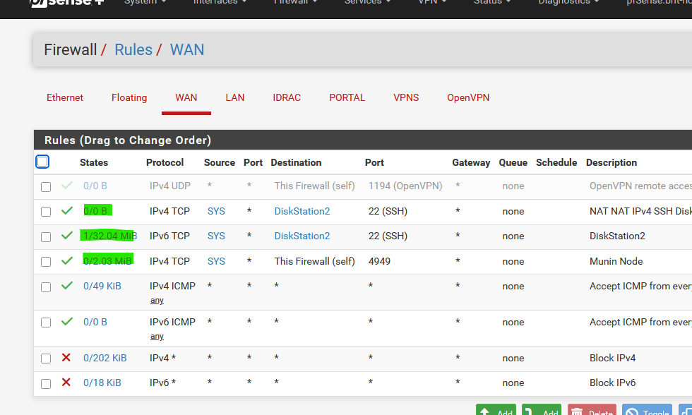

        edit : several ways to check if NAT rules 'work'.
        That is : check with pfSense if traffic arrives at 'the WAN gates'.
        Look here :
        You see the green counters ?
        They change (go up) when traffic matches the rule = that was the traffic that will get NAtted to your internal LAN network, to some NAT IP.
        If the counters don't increment : the traffic never reached pfSense.

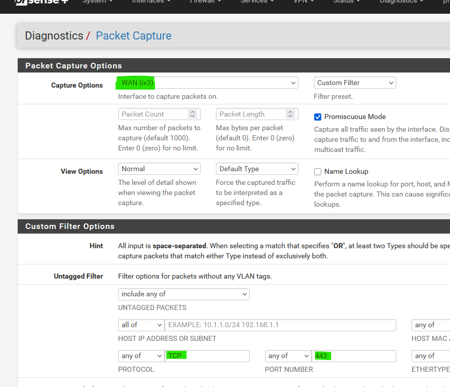

        Another method :
        You didn't tell, but let's presume you NATted port '443' because you have a web server on your LAN, using some (don't care) LAN IP.
        Use the pfSense packet sniffer :
        I've selected also TCP as web traffic is (normally) TCP.
        Hit start.
        Now try to use your NAT rule.
        As soon as packets reach pfSense, and get in, you'll see the packets listed.
        If nothing gets listed : the traffic never reached pfSense.
